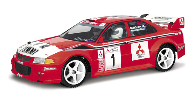

Ble denne lille handlelisten:
HPI-6816 Silicone O-Ring S10 (6pcs)
HPI-87052 Silicone Exhaust Coupling
HPI-Z303 / HBC70611 Cap Head Screw M3x42MM 6pcs
HPI-Z663 Lock Nut M3 (6pcs)
HPI-7448 MITSUBISHI LANCER EVOLUTION BODY (200mm)
Lancer body til sprint2 bilen, resten til savage.
Pictar!
