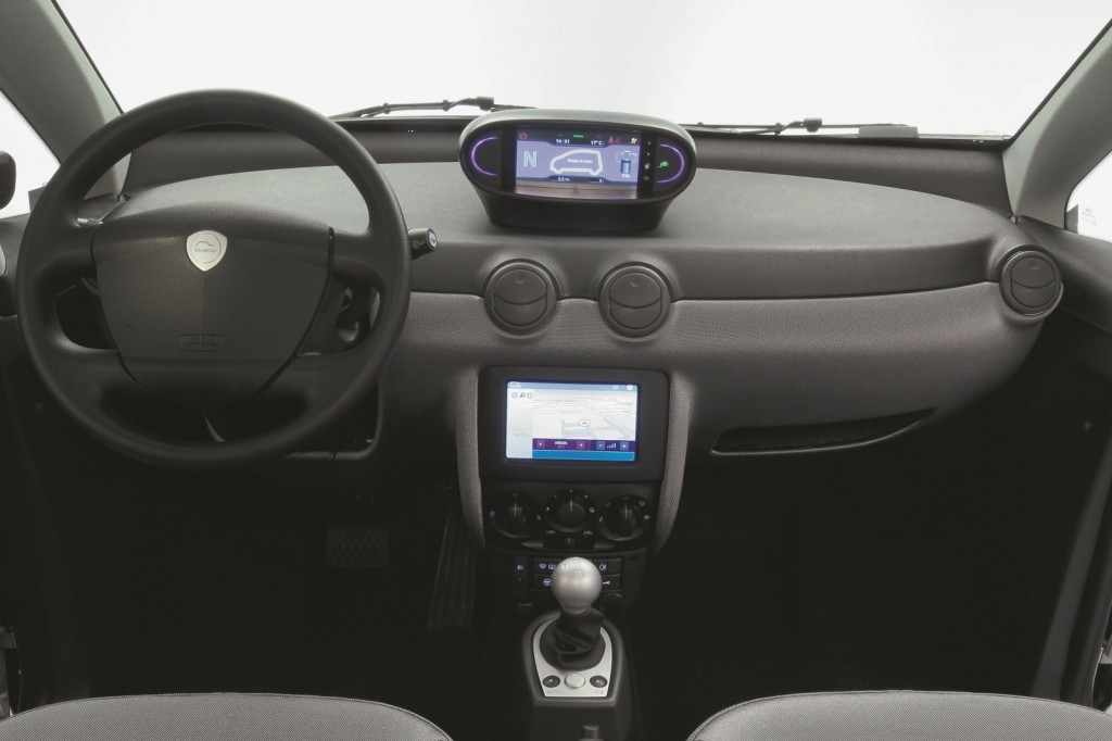

Her er bilde av bilen som deler batteri med mercedes. Ser ut til at flere har laget minimalistisk interiør med speedometer i midten. Bilen har 32kwh batteri og 250km rekkevidde. Laget ca 2010-2016?
Ser ikke ut som det er de samme batteriene, selv om de kommer fra samme firma som lagde den bilen du la ved bilde på.  Eller har du en link som viser dette?
Av det jeg finner ut, hadde B-klasse battericeller fra Tesla:
https://avt.inl.gov/sites/default/files/pdf/fsev/fact2015mercedesbclass.pdf
Om bilen og batteriene i den du la ved bilde på:
https://en.wikipedia.org/wiki/Bolloré_Bluecar
"The car has a 30kWh lithium metal polymer (LMP) battery, coupled to a supercapacitor, that provides an electric range of 250 km (160 mi) in urban use, and a maximum speed of 120 km/h (75 mph)."
https://en.wikipedia.org/wiki/Lithium_polymer_battery
Hyundai Motor Company uses this type of battery in some of their hybrid vehicles,[11] as well as Kia Motors in their battery electric Kia Soul.[12] The Bolloré Bluecar, which is used in car sharing schemes in several cities, also uses this type of battery.
https://insideevs.com/news/345705/mercedes-scores-record-order-for-ecitaro-some-with-solid-state-batteries/
"The other interesting news is that the Mercedes-Benz eCitaro is now available for order also with new 441 kWh solid-state batteries. The solid-state batteries supplied by Bollore’s Blue Solution were announced in 2018. Those are the batteries known also as Lithium Metal Polymer (LMP), which are however required to operate at a high temperature of 60-80°C.
Equipped with the 441 kWh packs, the buses will be able to drive 200 km (124 miles) in SORT2 test cycle in winter conditions.
The first 15 buses for ESWE will be 292 kWh NMC batteries (lithium-nickel-manganese-cobalt-oxide cells), while the remaining 41 are to be 441 kWh high-temperature solid-state batteries."
