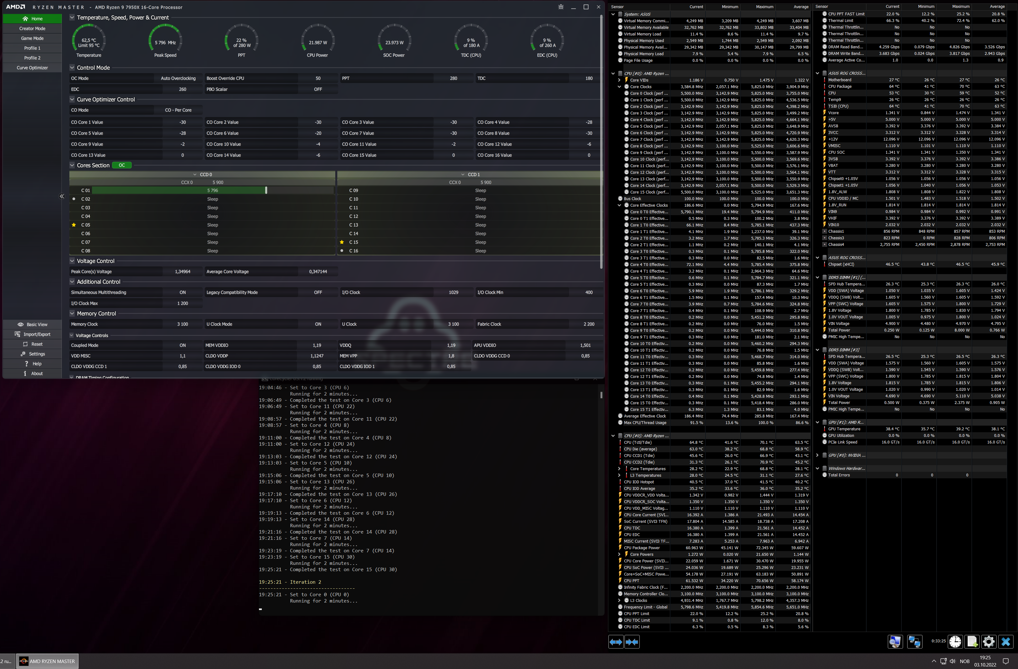

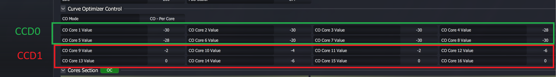

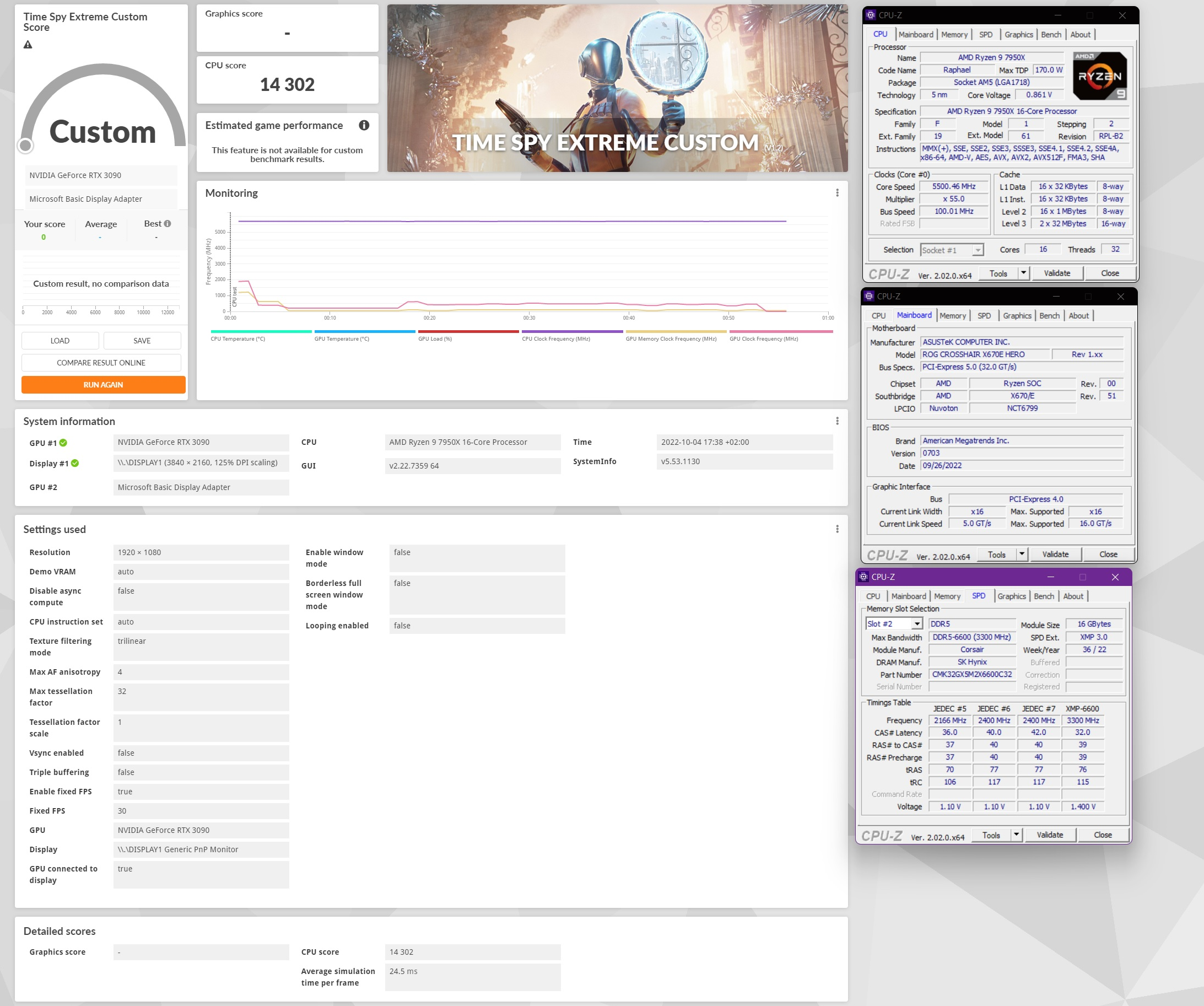

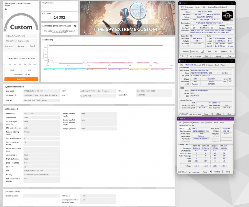

In typical AMD fashion, goodlike CCD0 is binned together with useless junk CCD1.
CCD0 can almost run PBO CO -30, while 3 cores on junk CCD1 have zero headroom left

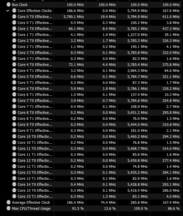

CCD0 singlecore clockspeed is around ~5780mhz in prime95
CCD1 singlecore clockspeed is around ~5450mhz in prime95
Wish me better luck on the other 7950x i get in a few days ^^

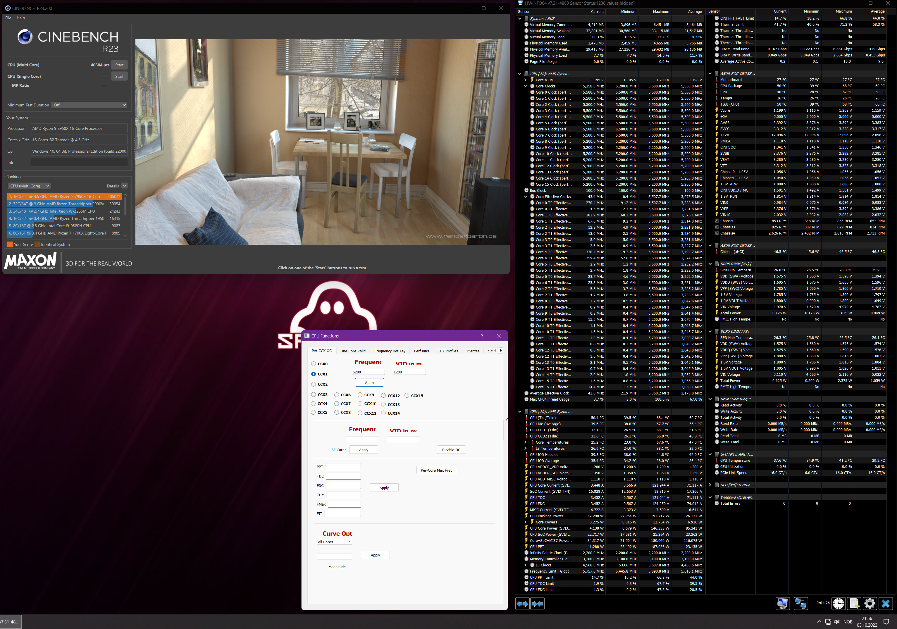

Have done a further comparison in Cinebench r23 with static allcore OC @ 1200mv core LLC5. (maximum PPT was ~187w and max load temp was 68 degrees)
CCD0 managed 5500mhz
CCD1 could only run 5200mhz.
= 40.5k points at lowish vcore
Seems like its a 300mhz delta between the CCD's both in ST and MT workloads
