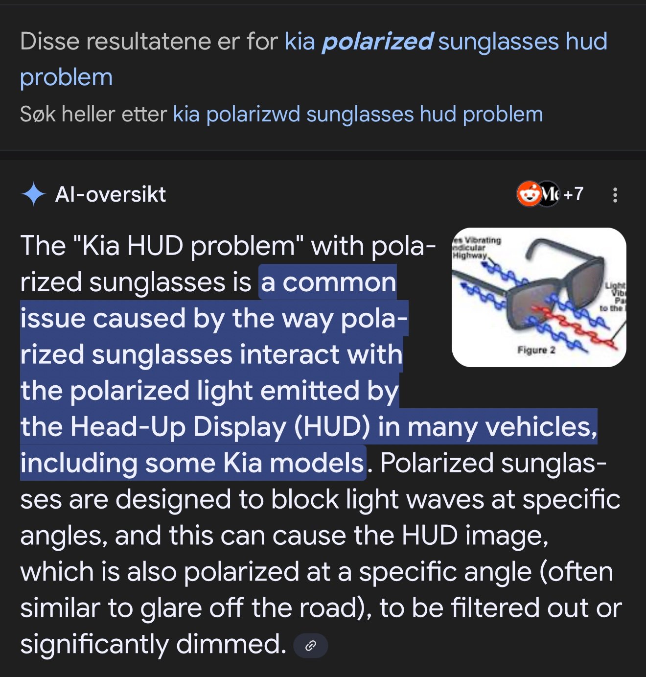

Jotun skrev (1 time siden):
Hvorfor ikke utvikle hud slik at det funker med alle typer briller? Blir det dårligere hud om man motvirker effekten?
AI-oversikt
Heads-Up Displays (HUDs) often don't work well with polarized sunglasses because the light projected by the HUD is also polarized, and polarized sunglasses block light that is polarized at a specific angle, usually the same angle as the HUD's projected light. This causes the light from the HUD to be filtered out, making it difficult or impossible to see.
Why polarized sunglasses affect HUDs:
Polarized light:
Both the HUD and polarized sunglasses utilize polarized light. The HUD uses a polarizing filter as the last step in its light path to create the display image.
Polarization angle:
Polarized sunglasses are designed to block light waves that are predominantly oriented horizontally, which is typically how reflected light off surfaces like roads becomes polarized. The HUD's projected light, when reflected off the windshield, often aligns with this same horizontal polarization.
Cancellation:
When you wear polarized sunglasses, they effectively cancel out the polarized light emitted by the HUD because the polarization angles are similar, or the sunglasses block the specific plane of polarization the HUD is projecting.
Potential solutions and considerations:
Tilt your head:
Slightly tilting your head can change the angle of the polarized light, potentially making the HUD visible again.
Adjust HUD height:
Some HUDs offer height adjustment settings, which might also help find a visible angle.
Non-polarized sunglasses:
Using non-polarized sunglasses will allow you to see the HUD clearly, as they don't filter out polarized light in the same way.
Specialized glasses:
Some manufacturers offer specialized glasses designed to work with HUDs, sometimes with different polarization angles.
Rotate the HUD display:
Some vehicles, like those with iDrive, have a rotation feature for the HUD, which can help align the projection with your viewing angle.

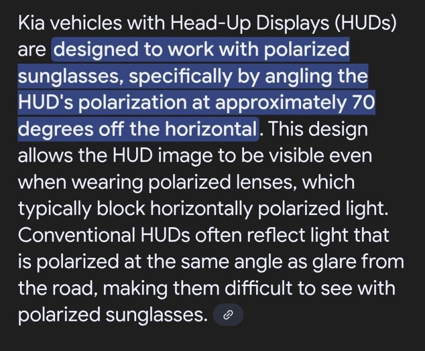

Beste forklaringen hittil, men forstår fortsatt ikke hvordan Kia kan ha 70 graders polarisering på sin HUD? Og dermed unngå problemet med omtrent alle polariserte solbriller.
Har de mye dårligere HUD grunnet dette eller noe?
Skjermer generelt bruker jo å ha 45 - 135 graders polarisering for å hindre dette problemet men blir sikkert litt annerledes i en refleksjon.
Hvor er kilden din til den påstanden ?
Når jeg søker etter Kia HUD og polarized sunglasses får jeg akkurat de samme svarene og utfordringene.
Må inrømme at det var AI da jeg spurte den om noen biler sin HUD fungerte med polariserte solbriller. Kan prøve å finne kilden.
Endret av Complexity
Jeg spurte også AI (en annen vinkling på spørsmålet ) og fikk et helt annet svar. So much for AI 🤷‍♂️
Men er også en del forum linker som kom hvor det viser seg at det ikke er noe annerledes og magisk med Kia/Hyundai angående temaet.

Det er nok en avveining. Som sagt så er polariseringen ved refleksjon i vinduet ikke 100%, så man må ikke rette polariseringen etter dette, resultatet vil være mindre lysutbytte og en svakere refleksjon, men man kan jo kompensere med mer lys.
Jeg finner imidlertid ikke noen primær kilde til at KIA er anneledes.
Jeg ser også disse påstandene om en 70 grader vinkling, men de kommer alle tilbake til den samme reddit posten og kan knappest regnes som en troverdig kilde.
