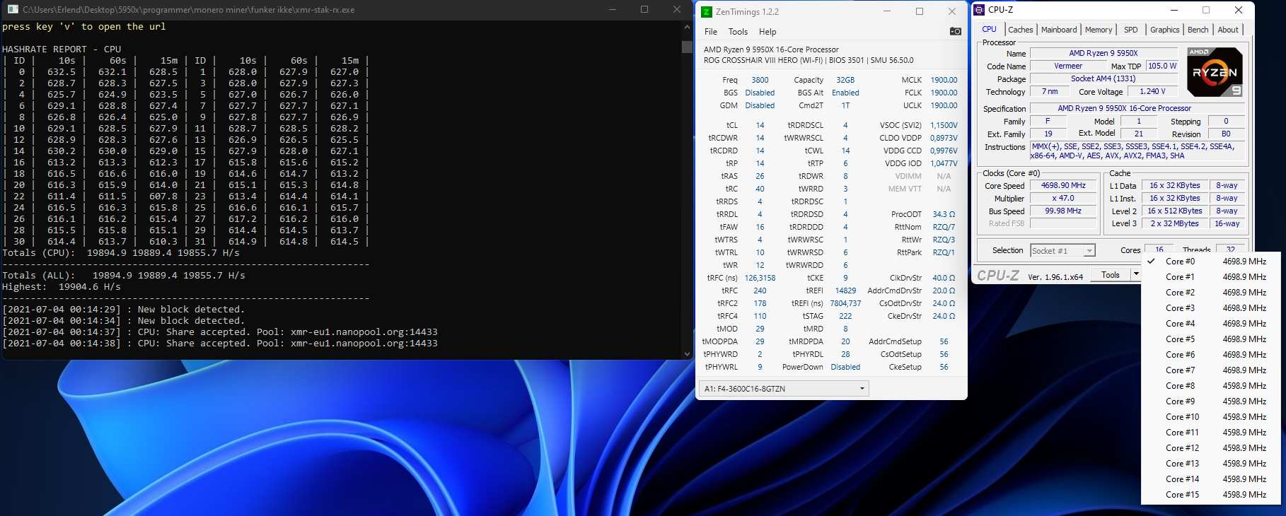

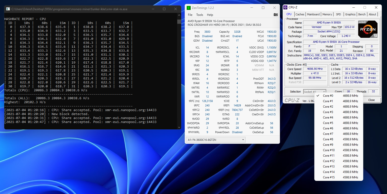

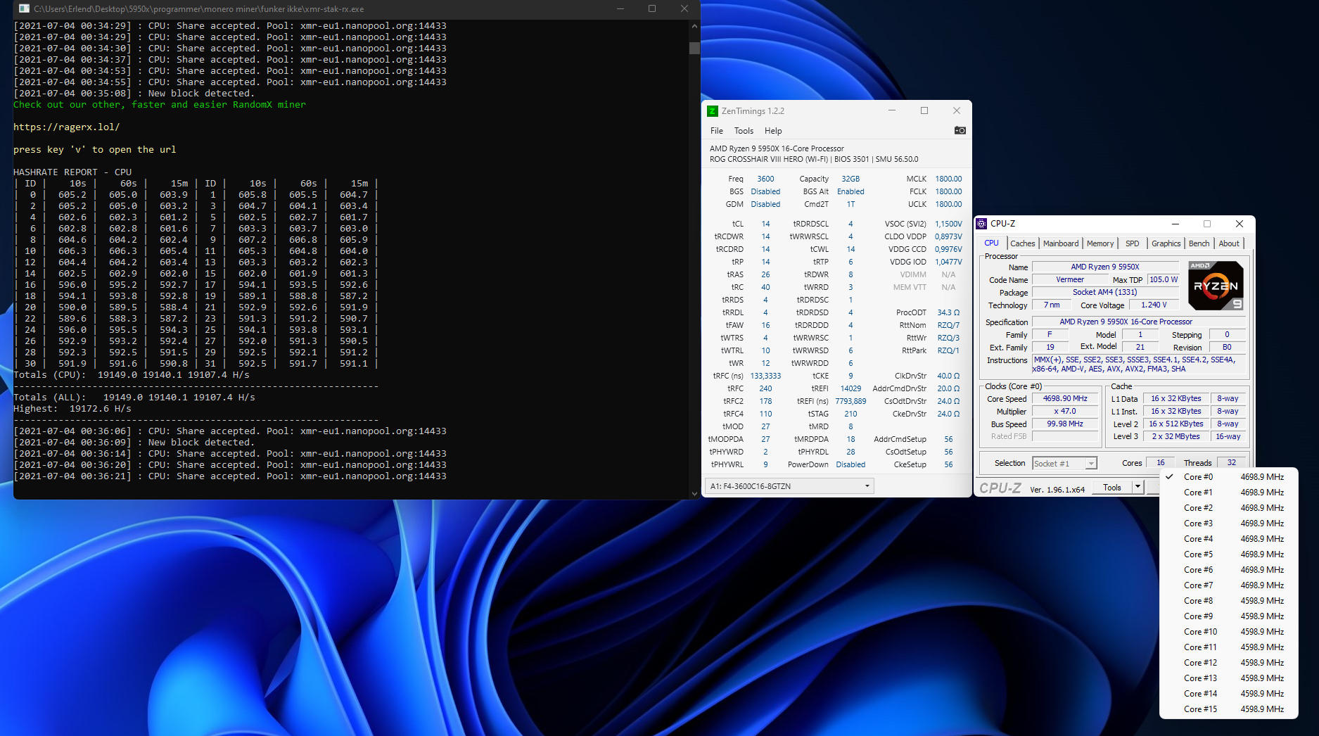

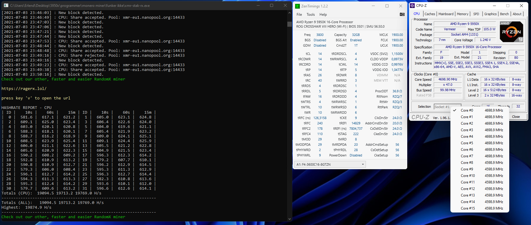

Nizzen Skrevet 9. juli 2021 Skrevet 9. juli 2021 3 hours ago, Ola Norman said: So i decided to also test this in windows11... Pretty much same settings as above. 5950x @ 4700/4600 static OC, SMT enabled 4x8GB memory sticks 1800:3600 T1 setup-time + CL14-14-14-14 19107.4 H/S over 15min run upto 605 H/S per core 1900:3800 T1 setup-time + CL14-14-14-14 and the tweaks i got suggested a on a other forum (tRRDL=5, tWR=10 and tRTP=5) 19769 H/S over 15min run upto 625 H/S per core 1900:3800 T1 setup-time + CL14-14-14-14 19855.7 H/S over 15min run upto 632 H/S per core A few thoughts on the runs above: Scaling between 1800:3600 and 1900:3800 seems pretty good. Theoretical max scaling should be 5.5%. (1900/1800) Iam seeing upwards to ~4% improved real-performance (19769/19107) with the only change being fclk 1800 vs 1900. tRRDL=5, tWR=10 and tRTP=5 setup performed alittle worse then my regular "flat cl 14" setup -------------------------------------------------------------------------------------------------------------------------------------------------- For fun i also tried a setup with tighter timings then the flat cl14-14-14-14 baseline.. To my big surprise it performed even better In theory (math) it should not perform better, but i cant argue with the numbers im seeing 😮 1900:3800 T1 setup-time + CL14-8-14-12-24-36 20038.6 H/S over 15min run upto 638 H/S per core Seems like i found me some new daily 24/7 settings by just playing around --------------------------------------------------------------------------------------------------------------------------------------------------- Stability testing my new 24/7 settings, pretty happy with the results 51.1ns with both CCD enabled + 4 memory sticks: Full stresstesting: 20 cycles TESTmem 1usmns cfg 3000% in Karhu RAM Test y-cruncher all stresstests, 4 iterations (SFT is a 300 watt load with current settings) Flotte resultater ikkje mye Nordmann i skrifta da hvilken kjøling har du på cpu?

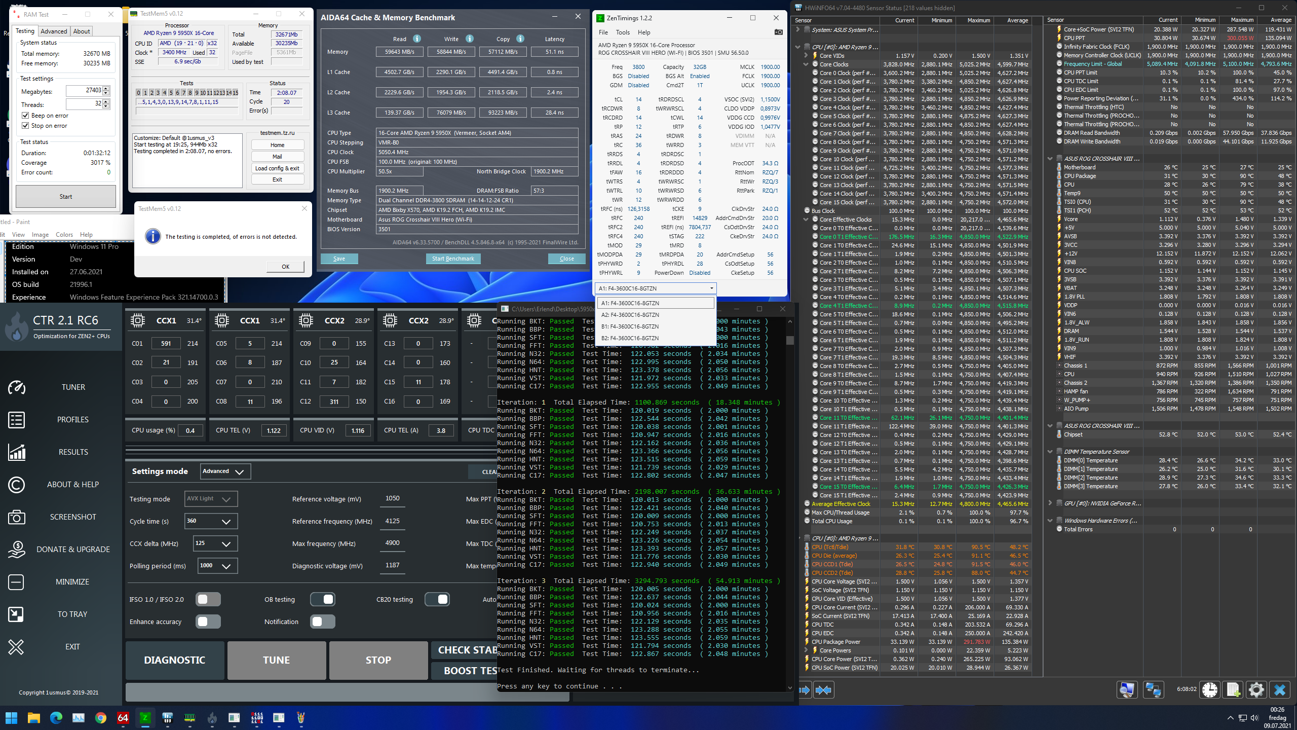

FranZe Skrevet 9. juli 2021 Skrevet 9. juli 2021 (endret) FranZe skrev (På 5.7.2021 den 19.26): Du satt meg på rett spor her Var litt over budsjett men slik er det nå bare. Så mottok jeg det endelig til slutt, kom i dag etter noe venting (fjernlager vare) Vis skjult innhold Ja, så har en jo fått inn brikkene i maskinen og fått testet noe temp. Sett vekk fra det så er det ikke gjort noe særlig annet. Vis skjult innhold Det er nå jeg trenger noe bistand her, hvis det er noen som kan se på hvordan det ser ut. Tenker mest i forhold på vdimm voltage i forhold til procodt, og rttnom, gdm og slikt. Tanken var å holde seg på 3600Mhz, så får en stramme til så langt det går. Men setter stor pris på om noen bare kan kaste ett lite øye på det og se om det ser noenlunde ut Kan da like så greit sitere meg selv her 😁 Det ved å gå imot mine egne ord. Må jo alltids bortpå å "fikle" litt. Tror jeg fant litt ut av det her, da maskinen ikke var villig til å boote med noe særlig høyere enn rundt 1.45v på minnebrikkene forsøkte jeg procodt ett hakk ned. Nja, fortsatt litt rusk på 3600Mhz, var lettere å kjøre 3800 cl14 enn 3600 cl14, men traff sikkert bedre med 3800 mtp spenning. Huff og huff, 3800 cl14 krevdes for mye guffe på brikkene. Skulle hatt en egen loop for kun de. Kanskje sette aircondition inntil maskinen igjen Spoiler 3800 cl16 derimot holdt seg ganske greit (under/rundt 43c) og er stabilitets testet med litt forskjellig. TM5 (AntaExtreme), y-cruncher og karhu med cache enabled. Spoiler Sett i forhold til SR brikkene jeg hadde tidligere, som kjørte 3600 cl14 så gir disse brikkene her med 3800 cl16 6-7 fps mer på min fps'en i sottr på 1080p highest (resmod 50%) settings. 3800 cl14 ga 10 fps mer ca. Så 3-4 fps forskjell på cl16 og 14. Men det er vel ingen nyheter. "Stikkene" stock ut av esken, kan jo være det er enkelte som vil vite, kanskje. Ripjaws 3600 16-16-16 XMP profil (2x8GB) Spoiler Tridenz Z 3200 14-14-14 XMP profil (2x16gb) Spoiler Endret 9. juli 2021 av FranZe

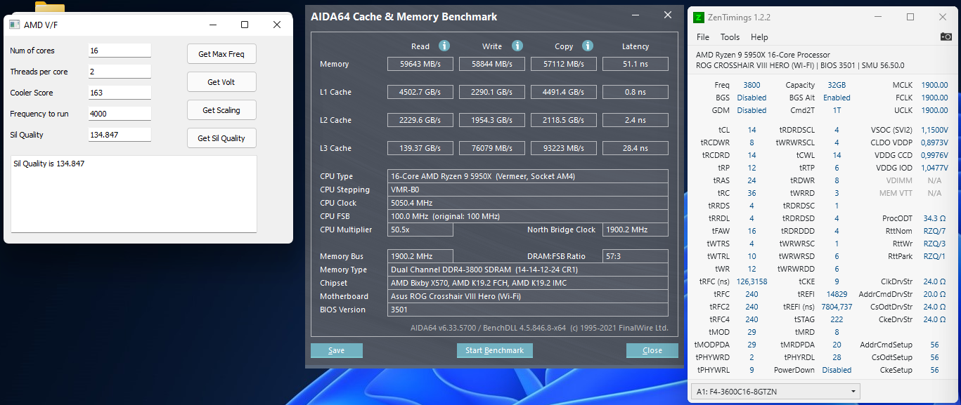

FranZe Skrevet 10. juli 2021 Skrevet 10. juli 2021 (endret) Cowboystrekk skrev (2 timer siden): Prøv med 2T og cl15 på 3800, det trenger ca 1.45V, du kan kjøre tRP på 14 og tRTP på 6, tRAS på 30, tRC på 44 og tRFC 270, andre timings likt. Testa 4000cl16? 4000 må sikkert en del finjustering til men booter opp med en hel haug med whea 19.. Skal forsøke 2T nu. Takk atter engang Resultatet ble slik Spoiler Forsøker med litt høyerer V. Nei, var oppi 1.47v men den ville seg ikke. Fullførte jo ett run men feilet jo neste. Må være noe annet som er årsaken og kanskje ikke mangel på minne V. Har ett spørsmål som jeg har undret litt på her. SD'ene og DD'ene, skal de være 5 og 7? Endret 10. juli 2021 av FranZe
Cowboystrekk Skrevet 11. juli 2021 Skrevet 11. juli 2021 FranZe skrev (8 timer siden): 4000 må sikkert en del finjustering til men booter opp med en hel haug med whea 19.. Skal forsøke 2T nu. Takk atter engang Resultatet ble slik Skjul innhold Forsøker med litt høyerer V. Nei, var oppi 1.47v men den ville seg ikke. Fullførte jo ett run men feilet jo neste. Må være noe annet som er årsaken og kanskje ikke mangel på minne V. Har ett spørsmål som jeg har undret litt på her. SD'ene og DD'ene, skal de være 5 og 7? Kjør trcdrd/wr på 15, blir feil tall på tras, trc og trfc med dem på 16. Tras er tcl + trcdrd, trc er tras + trp, trfc er trc x 6. Om du skal kjøre det du gjør nå prøv evt tras 31, trc 45 og trfc 270. Sett vsoc til 1.1V, vddg iod til 1.02, vddg ccd til 0.94V, la procodt, rettpark etc være på auto. Se hva som skjer da 1
FranZe Skrevet 11. juli 2021 Skrevet 11. juli 2021 (endret) Cowboystrekk skrev (12 timer siden): Kjør trcdrd/wr på 15, blir feil tall på tras, trc og trfc med dem på 16. Tras er tcl + trcdrd, trc er tras + trp, trfc er trc x 6. Om du skal kjøre det du gjør nå prøv evt tras 31, trc 45 og trfc 270. Sett vsoc til 1.1V, vddg iod til 1.02, vddg ccd til 0.94V, la procodt, rettpark etc være på auto. Se hva som skjer da Ble nødt til å ta en liten pause på den 3800 CL15 da det ble litt lotto Men lagret den på minnepinne for å fortsette med den. Måtte bare gå på en litt enklere oppgave først. Tok 3800 CL14 profilen som jeg hadde ,(krevde sikkert mye mer V for å bli stabil like vel ), og dro den ned i 3733 CL14 T2. Mistenkte også mangel på Vdimm spenning (som deg) og måtte øke. Men skal prøve å få det andre jeg forsøkte å øke i forsøket (Vsoc og så å si alt det andre) ned igjen senere. Fikk til noe da i det minste, bedre enn intet. Og tusen takk for hjelpen så langt 👍 Spoiler Endret 11. juli 2021 av FranZe
Cowboystrekk Skrevet 11. juli 2021 Skrevet 11. juli 2021 FranZe skrev (1 time siden): Ble nødt til å ta en liten pause på den 3800 CL15 da det ble litt lotto Men lagret den på minnepinne for å fortsette med den. Måtte bare gå på en litt enklere oppgave først. Tok 3800 CL14 profilen som jeg hadde ,(krevde sikkert mye mer V for å bli stabil like vel ), og dro den ned i 3733 CL14 T2. Mistenkte også mangel på Vdimm spenning (som deg) og måtte øke. Men skal prøve å få det andre jeg forsøkte å øke i forsøket (Vsoc og så å si alt det andre) ned igjen senere. Fikk til noe da i det minste, bedre enn intet. Og tusen takk for hjelpen så langt 👍 Skjul innhold Se der ja! Veldig bra, tipper for lav spenning av hovedproblemet med cl15. Om du kjører cl14 eller 16 kan du bruke 1t og GDM, enklere å få til enn 2t, men funker ikke bra på oddetall tCL, tCWL, tWR og tRTP. Eneste timing som kan ha endel å si for ytelse, men trolig går på samme spenning er tRTP som trives best når den er halvparten av tWR, prøv 6 og se hva som skjer, tipper det går 1
FranZe Skrevet 11. juli 2021 Skrevet 11. juli 2021 (endret) Cowboystrekk skrev (44 minutter siden): Se der ja! Veldig bra, tipper for lav spenning av hovedproblemet med cl15. Om du kjører cl14 eller 16 kan du bruke 1t og GDM, enklere å få til enn 2t, men funker ikke bra på oddetall tCL, tCWL, tWR og tRTP. Eneste timing som kan ha endel å si for ytelse, men trolig går på samme spenning er tRTP som trives best når den er halvparten av tWR, prøv 6 og se hva som skjer, tipper det går Er det mulig å få til 1T uten GDM? Slik over tid? Forsøkte forresten tipset du ga meg tidligere med å forsøke trp på 12 og trtp på 6, det gikk rett vest, men da måtte jeg selvfølgelig bort å klå på noe annet samtidig også. Trc til 40 og trfc til 240, hehe, en gir seg jo liksom ikke heller da..:) Men kan forsøke kun trtp til 6 Endret 11. juli 2021 av FranZe
Cowboystrekk Skrevet 12. juli 2021 Skrevet 12. juli 2021 Prøv kun trtp, skal ikke trenge mer volt. Trfc 240 krever mer volt enn 252 så den var dømt til å feile 1t uten gdm er endel vanskeligere og krever typisk 0.03V mer, noen minnebrikker er vrange og nekter uansett, deriblant mine. 1
FranZe Skrevet 12. juli 2021 Skrevet 12. juli 2021 Cowboystrekk skrev (41 minutter siden): Prøv kun trtp, skal ikke trenge mer volt. Trfc 240 krever mer volt enn 252 så den var dømt til å feile 1t uten gdm er endel vanskeligere og krever typisk 0.03V mer, noen minnebrikker er vrange og nekter uansett, deriblant mine. Ja, trtp 6 har det blitt og har passert TM5 og karhu allerede 👍 Nei, det er jo helt greit med gdm 1T og 2T. Ja, trfc'en var litt vel optimistisk, det må jeg jo bare innrømme
