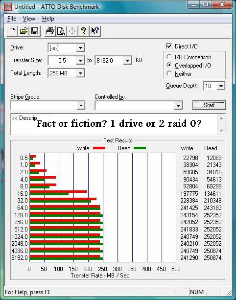

Fra mr. Tony ( OCZ's Old Jedi master ) i dag om vertexen med 64MB cache. Hentet ut fra linkene over her.
IF and a big IF we don't use this firmware the drives will be slowed by a tiny amount...so where its 250 read and 245 write it MAY be 235 write and 245 read.
Reviewers are getting the drives with this firmware...we are also considering releasing this firmware for the speed freaks as a flash update.
D111 flashing wipes the drives...so yes you lose all data.
I can not talk about trim or other features at this time, i will say it will probably be a marker in the firmware that tells the sata controller what it is....and that's dead easy to do, hell i could even put my name in the firmware if i wanted
Hehe, det er nesten så jeg har lyst til å avbestille 2x30 og bestille 1x120 hehe. Men uansett så vil jo 2x30 yte bedre selv med halve cachen. Begge vil få lavere hastigheter på filer over 32 og 64MB, som er mer interessant å se.
Regards more results its time now to let reviewers do their thing. The bench i showed has the drives in best case..IE drive is a spare with no data.
Reviewers will show drives with OS loaded (Like I normally do) which will be lower keep this in mind
All those asking for more benches and more details...you have what I can give you...wait for reviews to come out now.
