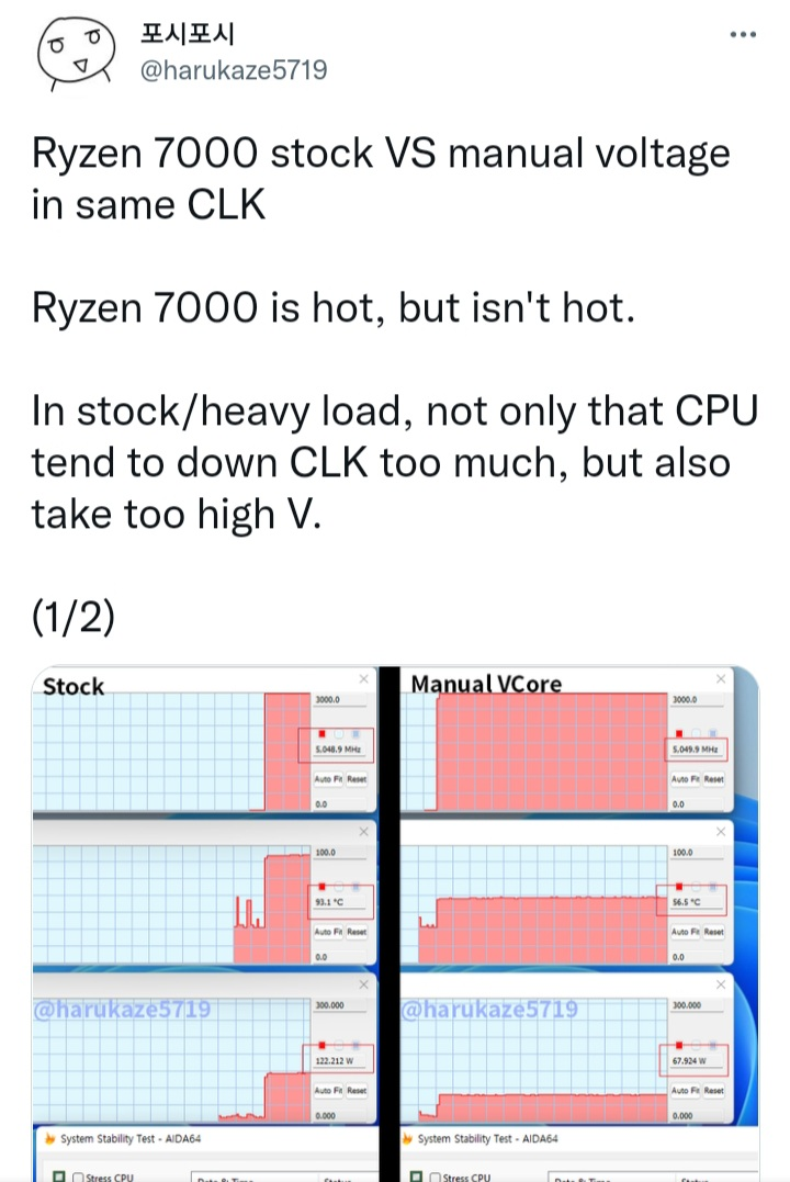

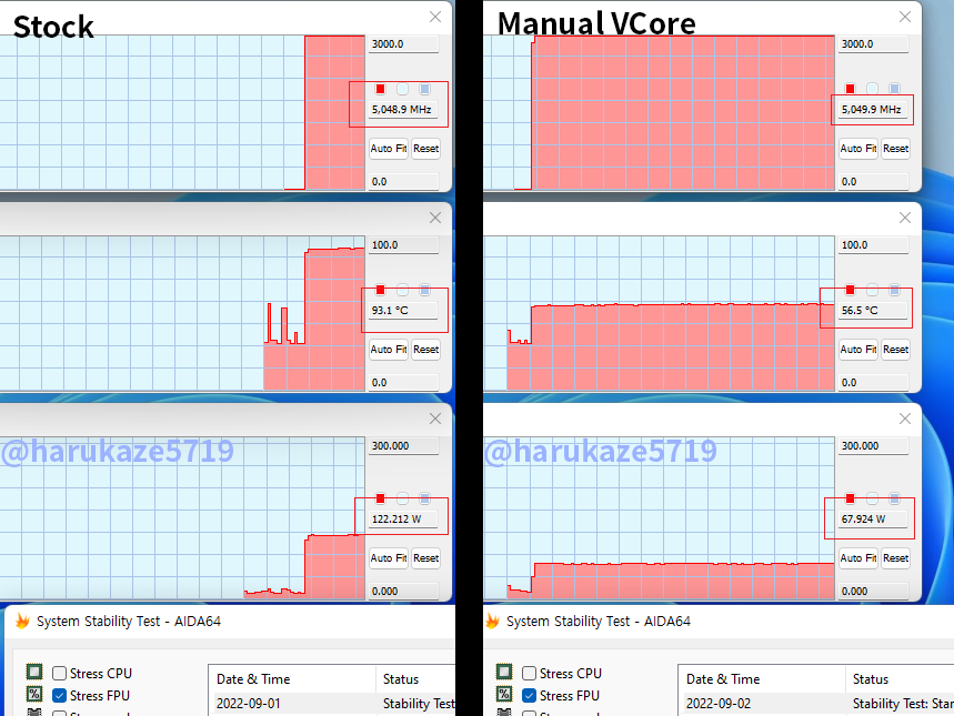

This is the intended/normal behavior for Zen4
Sitat
..The smaller heatspreader area on Ryzen 7000 package design only makes things worse. We discussed the cooling difficulty and why the heatspreader is smaller in our Computex piece in May.
Due to the cooling difficulty and higher power limits on Ryzen 7000 Dekstop, the philosophy has changed to follow a more laptop-like approach. Instead of fixing a clockspeed or power limit, the processor is now temperature limited. This means maximizing performance for a given cooling capability. The processor will adjust to stay within the temperature limits. This also means a more significant performance difference that changes with cooling ability.
The CPU will try to boost until it hit maximum boost clock or intended tjmax which it seemingly aims for now.
(by adding more EDC/TDC instead of vcore i guess?)

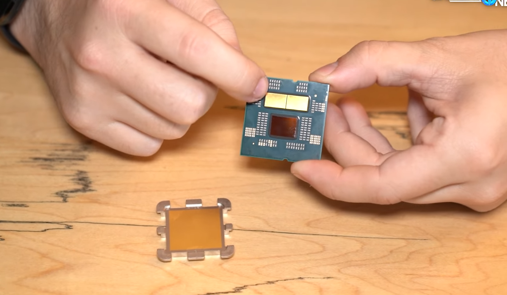

Gamernexus har jo også leaka at derbauer driver å lager delid tool for AM5 og forhåpentlig direct die vannblokk.. Er veldig spent på hvor mye bedre temperatur man kan få med dette.. Orginal heatspreader er jo sinnsyk tykk så burde kanskje få 10-20 grader lavere temp (?)
Husker ikkje temp forskjell på Zen 3 delid og direct die, men var nok bra merkbar. Clock em Up folka har laget youtube video av supercool computer direct die blokk.

Liten die er overklokkerens værste fiende :D
Hmm, blir litt mer utfordrende med kjølepasta etc da, er ikke veldig komfortabel med 95C må jeg si, menmen...
Neglelakk og Liquid metal :)
