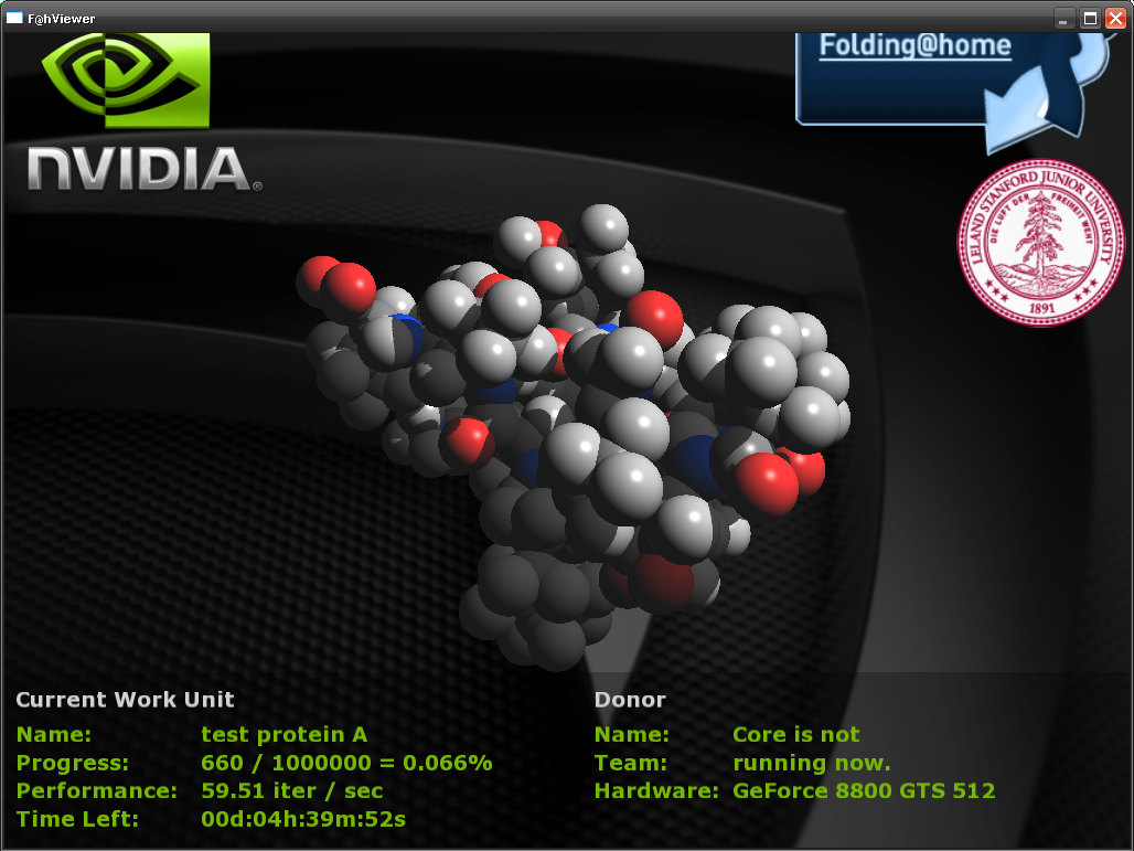

Thor. Skrevet 27. juli 2008 Skrevet 27. juli 2008 (endret) Jeg mente ikke at kortet mitt var dårlig om det var det du hintet til men for en god stund siden så var foldingprogrammene for gpu så elendig at det ikke var verdt det. Håper det er bedre denne gang Edit: Jeg har startet den nå og den folder i turbofart. Men den kjører "Test protein a". Er det en skjermkorttest? Logg --- Opening Log file [July 27 09:12:45 UTC] # Windows GPU Console Edition ################################################# ############################################################################### Folding@Home Client Version 6.12beta11 http://folding.stanford.edu ############################################################################### ############################################################################### Launch directory: C:\Documents and Settings\Thor\Programdata\Folding@home-gpu [09:14:00] - Ask before connecting: No [09:14:00] - User name: Thor. (Team 37651) [09:14:00] - User ID: 88921E64178D31C [09:14:00] - Machine ID: 3 [09:14:00] [09:14:00] Work directory not found. Creating... [09:14:00] Could not open work queue, generating new queue... [09:14:00] Initialization complete [09:14:00] - Preparing to get new work unit... [09:14:00] + Attempting to get work packet [09:14:00] - Connecting to assignment server [09:14:01] - Successful: assigned to (171.64.122.74). [09:14:01] + News From Folding@Home: GPU folding beta [09:14:01] Loaded queue successfully. [09:14:03] + Closed connections [09:14:03] [09:14:03] + Processing work unit [09:14:03] Core required: FahCore_11.exe [09:14:03] Core not found. [09:14:03] - Core is not present or corrupted. [09:14:03] - Attempting to download new core... [09:14:03] + Downloading new core: FahCore_11.exe [09:14:04] + 10240 bytes downloaded [09:14:04] + 20480 bytes downloaded [09:14:04] + 30720 bytes downloaded [09:14:04] + 40960 bytes downloaded [09:14:04] + 51200 bytes downloaded [09:14:04] + 61440 bytes downloaded [09:14:04] + 71680 bytes downloaded [09:14:05] + 81920 bytes downloaded [09:14:05] + 92160 bytes downloaded [09:14:05] + 102400 bytes downloaded [09:14:05] + 112640 bytes downloaded [09:14:05] + 122880 bytes downloaded [09:14:05] + 133120 bytes downloaded [09:14:05] + 143360 bytes downloaded [09:14:05] + 153600 bytes downloaded [09:14:06] + 163840 bytes downloaded [09:14:06] + 174080 bytes downloaded [09:14:06] + 184320 bytes downloaded [09:14:06] + 194560 bytes downloaded [09:14:06] + 204800 bytes downloaded [09:14:06] + 215040 bytes downloaded [09:14:06] + 225280 bytes downloaded [09:14:06] + 235520 bytes downloaded [09:14:06] + 245760 bytes downloaded [09:14:07] + 256000 bytes downloaded [09:14:07] + 266240 bytes downloaded [09:14:07] + 276480 bytes downloaded [09:14:07] + 286720 bytes downloaded [09:14:07] + 296960 bytes downloaded [09:14:07] + 307200 bytes downloaded [09:14:07] + 317440 bytes downloaded [09:14:07] + 327680 bytes downloaded [09:14:08] + 337920 bytes downloaded [09:14:08] + 348160 bytes downloaded [09:14:08] + 358400 bytes downloaded [09:14:09] + 368640 bytes downloaded [09:14:09] + 378880 bytes downloaded [09:14:09] + 389120 bytes downloaded [09:14:10] + 399360 bytes downloaded [09:14:10] + 409600 bytes downloaded [09:14:10] + 419840 bytes downloaded [09:14:10] + 430080 bytes downloaded [09:14:11] + 440320 bytes downloaded [09:14:11] + 450560 bytes downloaded [09:14:11] + 460800 bytes downloaded [09:14:11] + 471040 bytes downloaded [09:14:11] + 481280 bytes downloaded [09:14:12] + 491520 bytes downloaded [09:14:12] + 501760 bytes downloaded [09:14:12] + 512000 bytes downloaded [09:14:12] + 522240 bytes downloaded [09:14:12] + 532480 bytes downloaded [09:14:13] + 542720 bytes downloaded [09:14:13] + 552960 bytes downloaded [09:14:13] + 563200 bytes downloaded [09:14:13] + 573440 bytes downloaded [09:14:13] + 583680 bytes downloaded [09:14:13] + 593920 bytes downloaded [09:14:13] + 604160 bytes downloaded [09:14:14] + 614400 bytes downloaded [09:14:14] + 624640 bytes downloaded [09:14:14] + 634880 bytes downloaded [09:14:14] + 639010 bytes downloaded [09:14:14] Verifying core Core_11.fah... [09:14:14] Signature is VALID [09:14:14] [09:14:14] Trying to unzip core FahCore_11.exe [09:14:14] Decompressed FahCore_11.exe (1830912 bytes) successfully [09:14:19] + Core successfully engaged [09:14:24] [09:14:24] + Processing work unit [09:14:24] Core required: FahCore_11.exe [09:14:24] Core found. [09:14:24] Working on queue slot 01 [July 27 09:14:24 UTC] [09:14:24] + Working ... [09:14:25] [09:14:25] *------------------------------* [09:14:25] Folding@Home GPU Core - Beta [09:14:25] Version 1.08 (Tue Jul 22 08:24:14 PDT 2008) [09:14:25] [09:14:25] Compiler : cl: Command not found. [09:14:25] Build host: user-f6d030f24f [09:14:25] Preparing to commence simulation [09:14:25] - Looking at optimizations... [09:14:25] - Created dyn [09:14:25] - Files status OK [09:14:25] - Expanded 40660 -> 246265 (decompressed 605.6 percent) [09:14:25] Called DecompressByteArray: compressed_data_size=40660 data_size=246265, decompressed_data_size=246265 diff=0 [09:14:25] - Digital signature verified [09:14:25] [09:14:25] Project: 5216 (Run 9, Clone 23, Gen 37) [09:14:25] [09:14:25] Assembly optimizations on if available. [09:14:25] Entering M.D. [09:14:39] Working on p5216_supervillin_e1 [09:14:46] Client config found, loading data. [09:14:46] Starting GUI Server [09:15:17] CoreStatus = 62 (98) [09:15:17] + Restarting core (settings changed) [09:15:17] [09:15:17] + Processing work unit [09:15:17] Core required: FahCore_11.exe [09:15:17] Core found. [09:15:17] Working on queue slot 01 [July 27 09:15:17 UTC] [09:15:17] + Working ... [09:15:17] [09:15:17] *------------------------------* [09:15:17] Folding@Home GPU Core - Beta [09:15:17] Version 1.08 (Tue Jul 22 08:24:14 PDT 2008) [09:15:17] [09:15:17] Compiler : cl: Command not found. [09:15:17] Build host: user-f6d030f24f [09:15:17] Preparing to commence simulation [09:15:17] - Ensuring status. Please wait. [09:15:26] - Looking at optimizations... [09:15:26] - Not checking prior termination. [09:15:26] - Expanded 40660 -> 246265 (decompressed 605.6 percent) [09:15:26] Called DecompressByteArray: compressed_data_size=40660 data_size=246265, decompressed_data_size=246265 diff=0 [09:15:26] - Digital signature verified [09:15:26] [09:15:26] Project: 5216 (Run 9, Clone 23, Gen 37) [09:15:26] [09:15:26] Assembly optimizations on if available. [09:15:26] Entering M.D. [09:15:34] Working on p5216_supervillin_e1 [09:15:35] Client config found, loading data. [09:15:35] Starting GUI Server [09:16:03] CoreStatus = 62 (98) [09:16:03] + Restarting core (settings changed) [09:16:03] [09:16:03] + Processing work unit [09:16:03] Core required: FahCore_11.exe [09:16:03] Core found. [09:16:03] Working on queue slot 01 [July 27 09:16:03 UTC] [09:16:03] + Working ... [09:16:03] [09:16:03] *------------------------------* [09:16:03] Folding@Home GPU Core - Beta [09:16:03] Version 1.08 (Tue Jul 22 08:24:14 PDT 2008) [09:16:03] [09:16:03] Compiler : cl: Command not found. [09:16:03] Build host: user-f6d030f24f [09:16:03] Preparing to commence simulation [09:16:03] - Ensuring status. Please wait. [09:16:12] - Looking at optimizations... [09:16:12] - Not checking prior termination. [09:16:12] - Expanded 40660 -> 246265 (decompressed 605.6 percent) [09:16:12] Called DecompressByteArray: compressed_data_size=40660 data_size=246265, decompressed_data_size=246265 diff=0 [09:16:12] - Digital signature verified [09:16:12] [09:16:12] Project: 5216 (Run 9, Clone 23, Gen 37) [09:16:12] [09:16:12] Assembly optimizations on if available. [09:16:12] Entering M.D. [09:16:19] Will resume from checkpoint file [09:16:28] Working on p5216_supervillin_e1 [09:16:36] Client config found, loading data. [09:16:36] Starting GUI Server [09:18:00] Opening C:\Documents and Settings\Thor\Programdata\Folding@home-gpu\MyFolding.html... Folding@Home Client Shutdown. --- Opening Log file [July 27 09:19:11 UTC] # Windows GPU Console Edition ################################################# ############################################################################### Folding@Home Client Version 6.12beta11 http://folding.stanford.edu ############################################################################### ############################################################################### Launch directory: C:\Documents and Settings\Thor\Programdata\Folding@home-gpu [09:19:11] - Ask before connecting: No [09:19:11] - User name: Thor. (Team 37651) [09:19:11] - User ID: 88921E64178D31C [09:19:11] - Machine ID: 3 [09:19:11] [09:19:11] Loaded queue successfully. [09:19:11] Initialization complete [09:19:11] [09:19:11] + Processing work unit [09:19:11] Core required: FahCore_11.exe [09:19:11] Core found. [09:19:11] Working on queue slot 01 [July 27 09:19:11 UTC] [09:19:11] + Working ... [09:19:11] [09:19:11] *------------------------------* [09:19:11] Folding@Home GPU Core - Beta [09:19:11] Version 1.08 (Tue Jul 22 08:24:14 PDT 2008) [09:19:11] [09:19:11] Compiler : cl: Command not found. [09:19:11] Build host: user-f6d030f24f [09:19:11] Preparing to commence simulation [09:19:11] - Looking at optimizations... [09:19:11] - Files status OK [09:19:11] - Expanded 40660 -> 246265 (decompressed 605.6 percent) [09:19:11] Called DecompressByteArray: compressed_data_size=40660 data_size=246265, decompressed_data_size=246265 diff=0 [09:19:11] - Digital signature verified [09:19:11] [09:19:11] Project: 5216 (Run 9, Clone 23, Gen 37) [09:19:11] [09:19:11] Assembly optimizations on if available. [09:19:11] Entering M.D. [09:19:17] Will resume from checkpoint file [09:19:25] Working on p5216_supervillin_e1 [09:19:32] Client config found, loading data. [09:19:32] Starting GUI Server [09:21:06] Resuming from checkpoint [09:21:06] Verified work/wudata_01.log [09:21:06] Verified work/wudata_01.edr [09:21:06] Verified work/wudata_01.trr [09:21:06] Verified work/wudata_01.xtc Endret 27. juli 2008 av Thor.
Prebsor Skrevet 27. juli 2008 Skrevet 27. juli 2008 Nei, når du ser test protein A så betyr det at du ikke folder. Hvis du ser på name og team nede til hæyre står det "Core is not running now."
Thor. Skrevet 27. juli 2008 Skrevet 27. juli 2008 Beklager dobbeltpost men jeg merker bare mer og mer merkelige ting. Nå restarter den foldingen hver gang jeg åpner statusvinduet og går løs på test-proteinet over igjen og igjen. Plutselig så har jeg proteinet "p5216_supervil" som den ikke jobber med og minimerer og åpner vinduet igjen så er den på utgangspunktet igjen uten fortjeneste.. Hva er galt?
Prebsor Skrevet 27. juli 2008 Skrevet 27. juli 2008 (endret) Enn hvis du bare lukker/minimerer statusvinduet, laster ned Fahmon, og sjekker status derfra? Endret 27. juli 2008 av Prebsor
Theo343 Skrevet 27. juli 2008 Skrevet 27. juli 2008 (endret) Displayeren må ikke brukes, kjør heller fahmon som nevnt. Displayeren er også buggy og omtrent alpha ennå og viser "core not running" selv om den kjører. Du kan også bruke console versjonen som ikke har GUI eller systray. Endret 27. juli 2008 av Theo343
