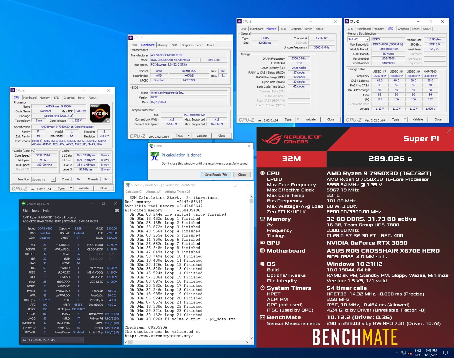

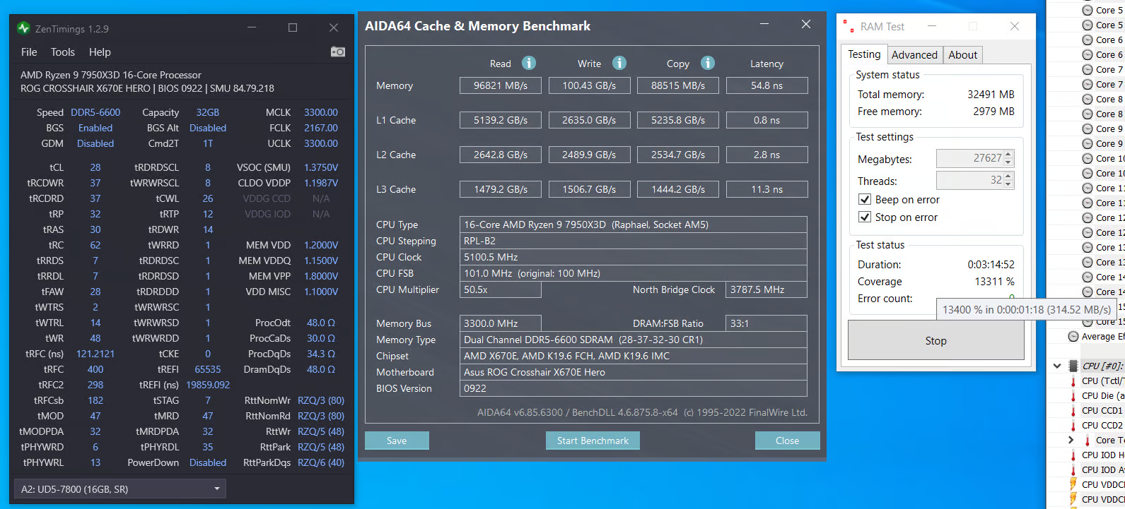

Da har man endelig fått stablet på beina ett sett med stabile minne settings.. 2200FCLK har forsinka meg nesten 1 uke før man lokaliserte problemet.
Sitat
After scratching my head for almost one week i finally found the guilty of my problems, responsible random restarts when running memory heavy benchmarks, and it turns out, alittle performance throttling in some heavy workloads..
In the end it was the 2200mhz FCLK that was the root cause... And after that everything is behaving as expected again when limited to 2166mhz
And now i finally feel comfortable sharing stable memory settings
Aida and karhu 13k @ 6600/2166 7950X3D
314.52mb/s showing realworld performance

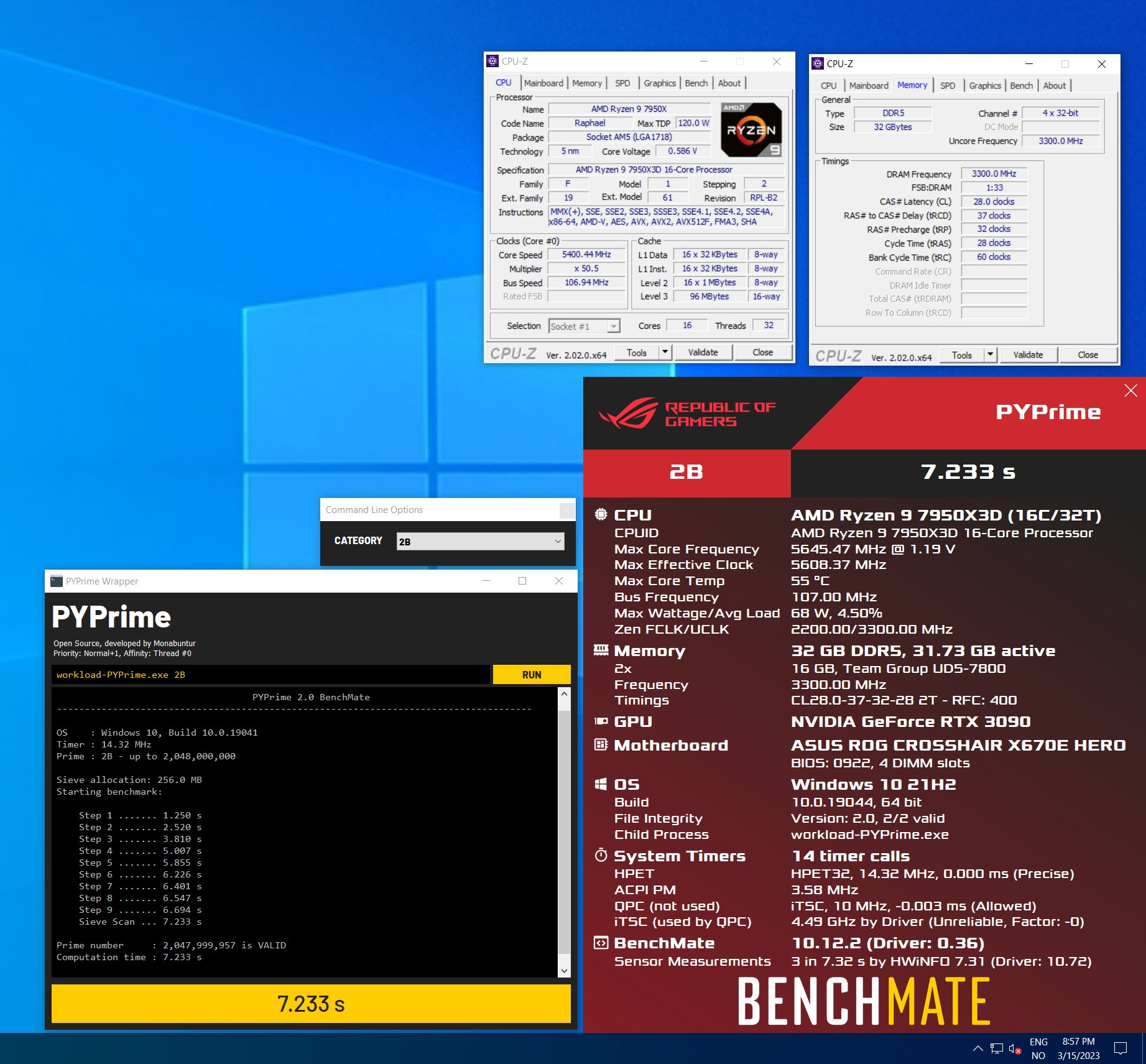

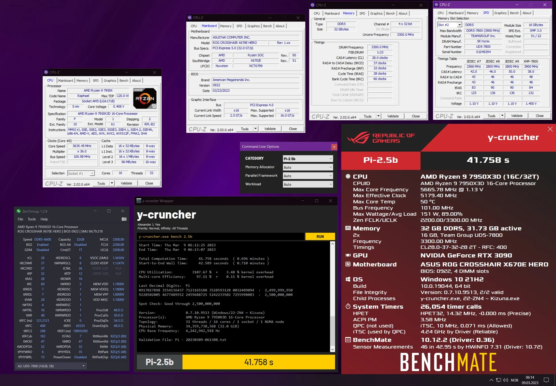

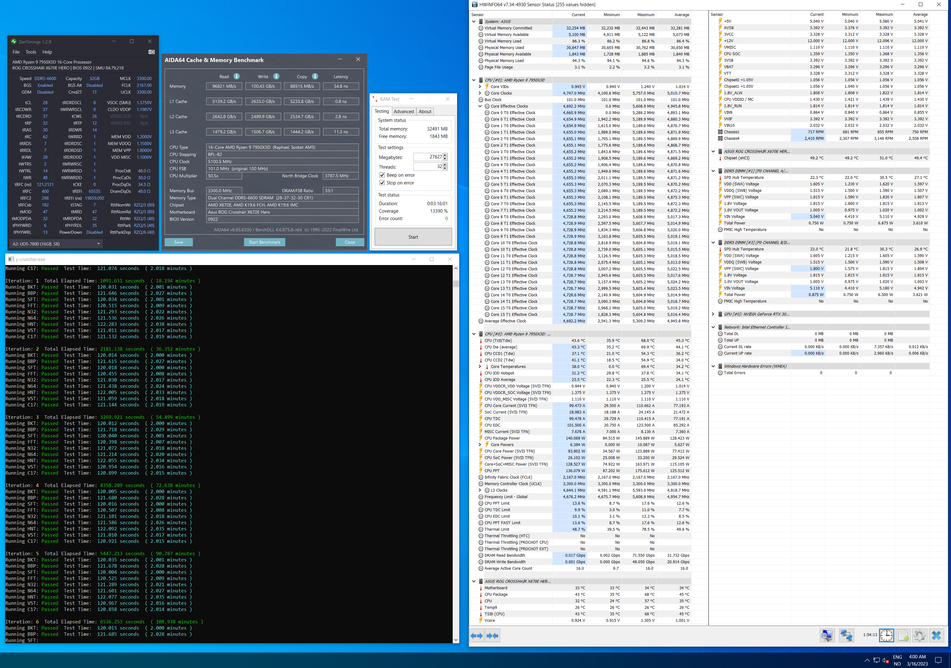

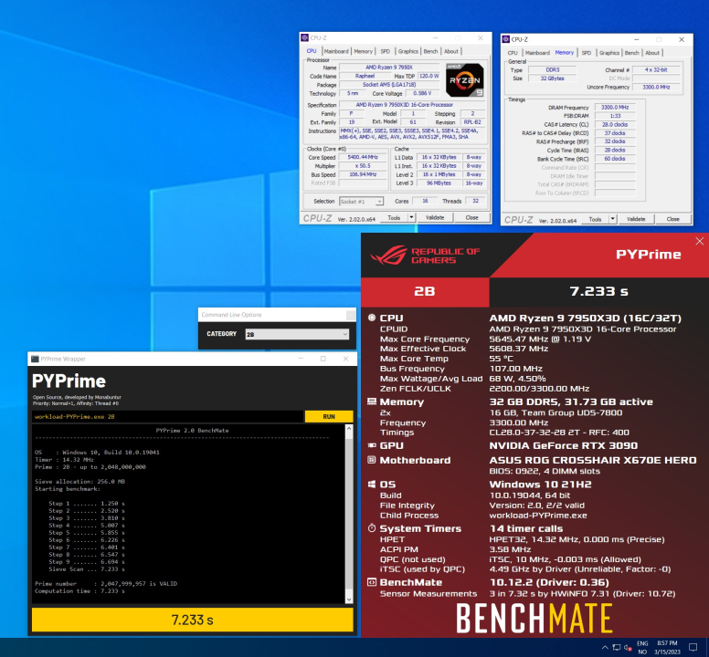

Fullscreen med hwinfo og 2 timer Y-cruncher all tests enabled:
Litt performance benchmarks under her
Spoiler
PYPrime 2B @ 7.233s
SuperPi 32m @ 289.026s
Y-cruncher 2.5B @ 41.758s
Endret av Ola Norman
  • Liker 4
