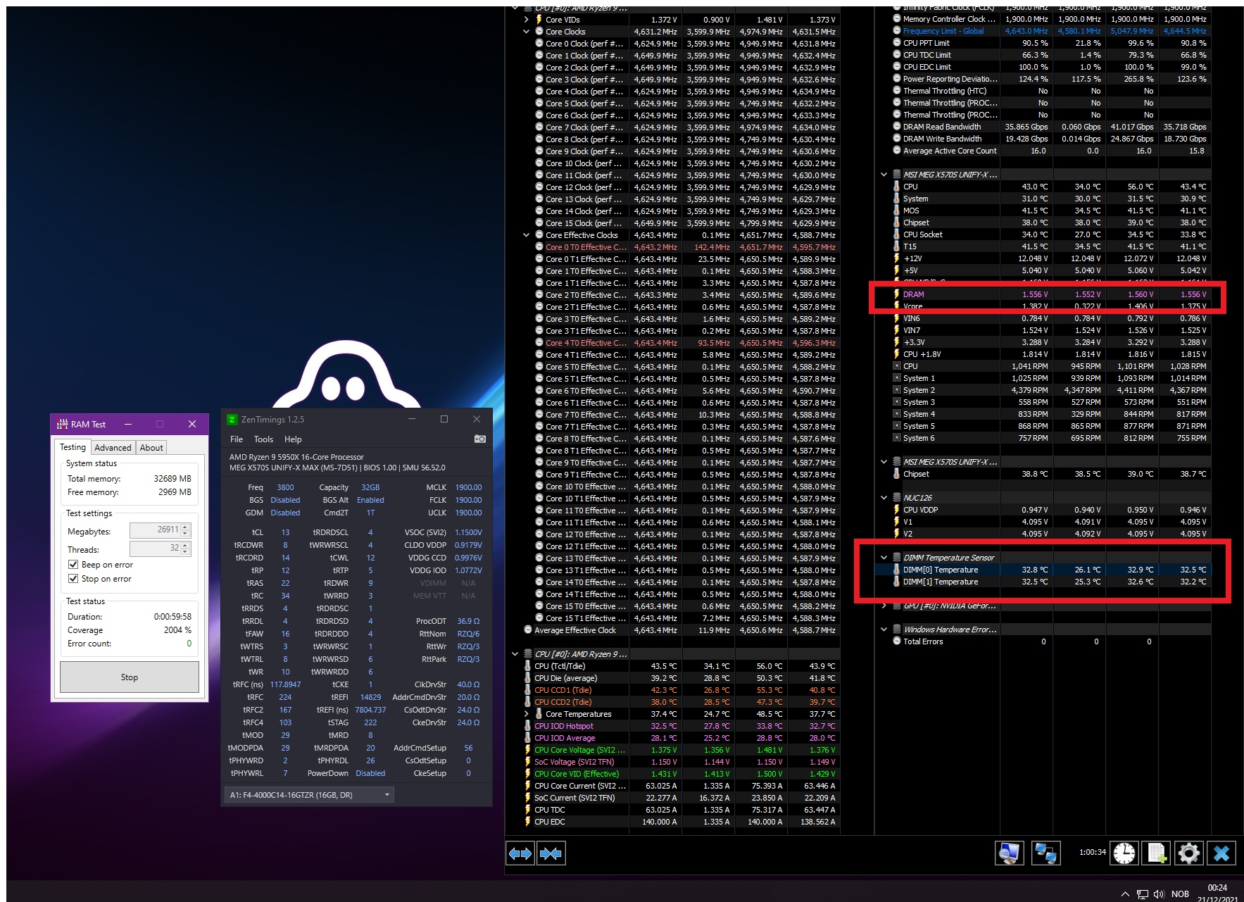

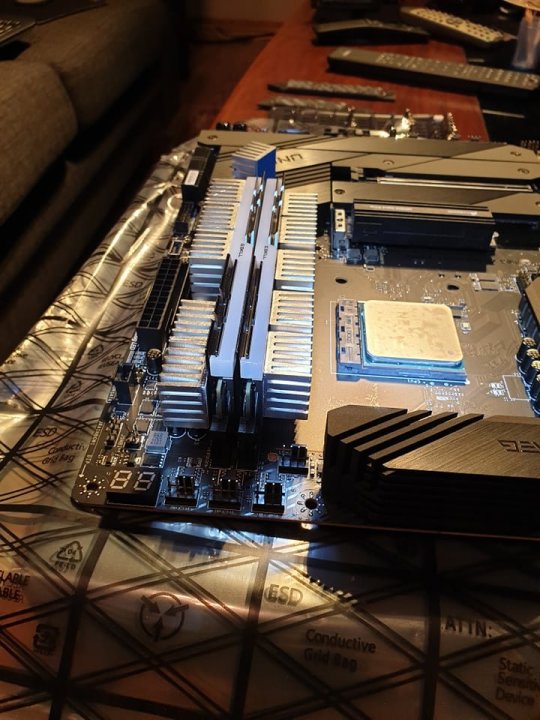

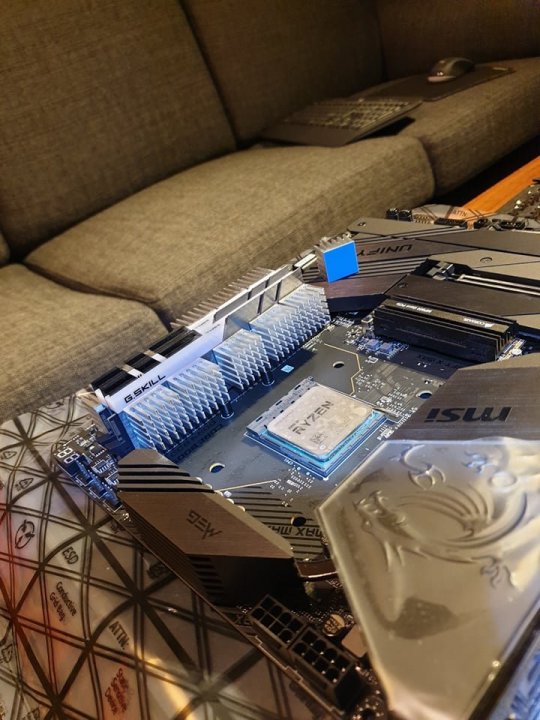

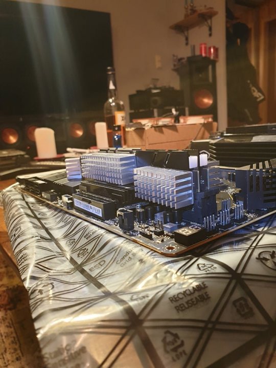

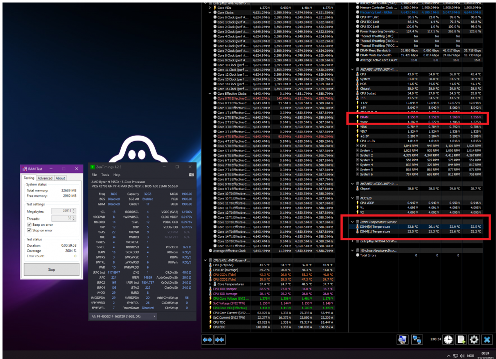

Tja, synes dette funka ganske bra jeg, 7 graders delta mellom idle og load etter 1 time med Karhu ramtest @ 1.56vdimm
Er bare rip-jaws settene som har helt elendig kontakt mellom IC og heatsink (50%).. Ser ut som om kontakten er grei nok på disse trident brikkene.. Er dette worstcase så skal jeg ikke klage på ~33 grader temp under maxload med brikker så tett sammen 😝

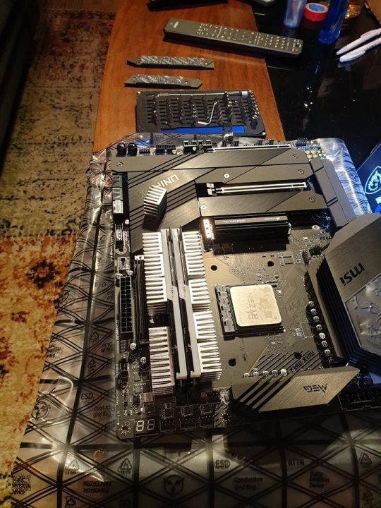

Motherboard is working really exemplary, it boot every setting known to man, no fuss, no nothing... Haven't had a failed post yet  (10x better then the Asus board in this regard)
And as you can see, I'm also back to my normal "CL13 1900 baseline memory settings"
CPU is the same 5950x as before, everything above 1900 flck spits out ~100 WHEA each Aida64 mem testrun
But one thing is new with this motherboard.. with the Crosshair VIII Hero i got clearly reduced performance @ 1933 and everything above, even in superlight things like Aida.. With this board i seems to see somewhat scaling to atleast 4000:2000, maybe 😛 (haven't tried higher yet)
Hopefully this means there is hope for real performance scaling above 1900 when using the whea suppressor on this board..
Much testing left to be done and lots of new settings to be learned, but i'm happy with what this board have achieved on first day.. This will be a very good platform for Zen 3d-$ in the future

Nice :)
Får vi se bilde av riggen?

Er lat som vanlig, så dette blir på engelsk..
So i have done some further testing..
The good:
This motherboard + memory combo have no problems booting up (atleast) 4400MT/sec memory speeds on dual rank 2x16GB running pretty tight timings (flat CL15).
Really wish for a good sample of 6950x v-$ which let me run high fclk🙏
Motherboard boots pretty much every settings i try, and when it don't, the recovery-system works flawlessly image.gif.7767abb8b0826c5ca76393eab68432c5.gif
The bad:
I seem to get lower performance with this motherboard @ the same static clocks compared to my old asus motherboard.
If we take Cinebench r20 which don't care about memory for example:
Crosshair VIII Hero @ 4700/4600 static clocks = ~12.1k points in r20
Unify X MAX @ 4700/4600 static clocks = ~11.9k points in r20
Hopefully this comes down to the rather old AGESA on the only bios released for this motherboard atm, SMU 56.52.0 (1.2.0.3c)
Crossing my fingers this get fixed in new bios..
Some funkiness: (LLC lol scaling)
LLC 8 (weakest) = upto ~20% cpu vdroop
LLC 7 (second weakest) = ~3% cpu vdroop
My CPU is still the same 5950x, cant run above 1900fclk without reduced performance, and have pretty much given up trying at this point..

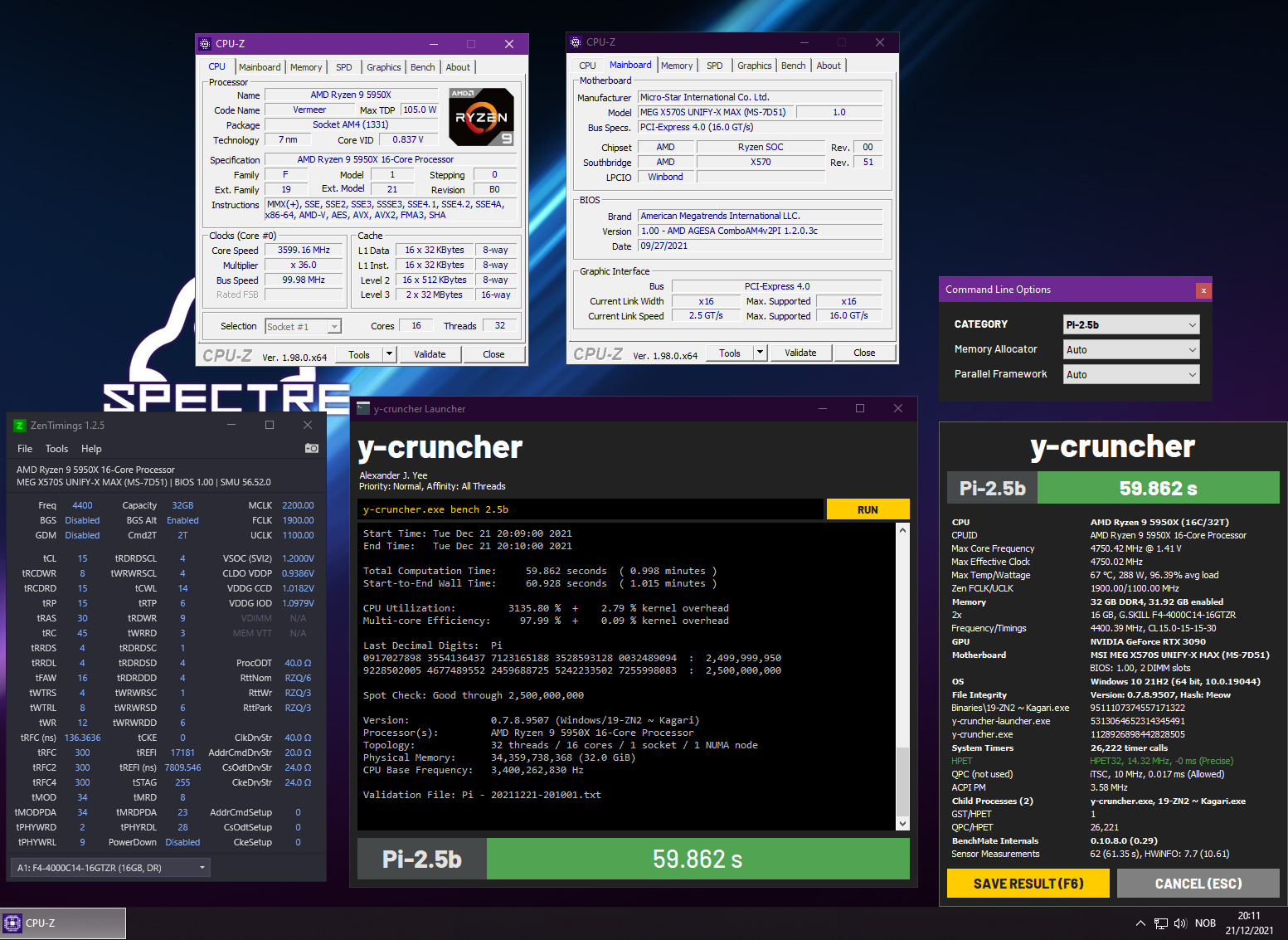

When testing how high memory-speed this motherboard + memory combo would run decoupled from flck with the minimum fiddling in the bios, (second day i have this motherboard) i also decided to perform some basic benchmark comparisons @ a static 4500/4400mhz cpu clock against my standard synced flck 1900 CL profile..
Since the IO die on my 5950x is so bad limiting me to lowish 1900:1900:3800 when running synced, it really depend on what the benchmark i'm  running for it to be faster than running 1600:1100:4400 asynced..
1640104592683-png.2538734
VS
1640104662866-png.2538736
Linpack = 659 average gflops
y-cruncher = 60.990 seconds
1900:1900:3800 synced
Linpack = 661 average gflops
y-cruncher = 63.711 seconds

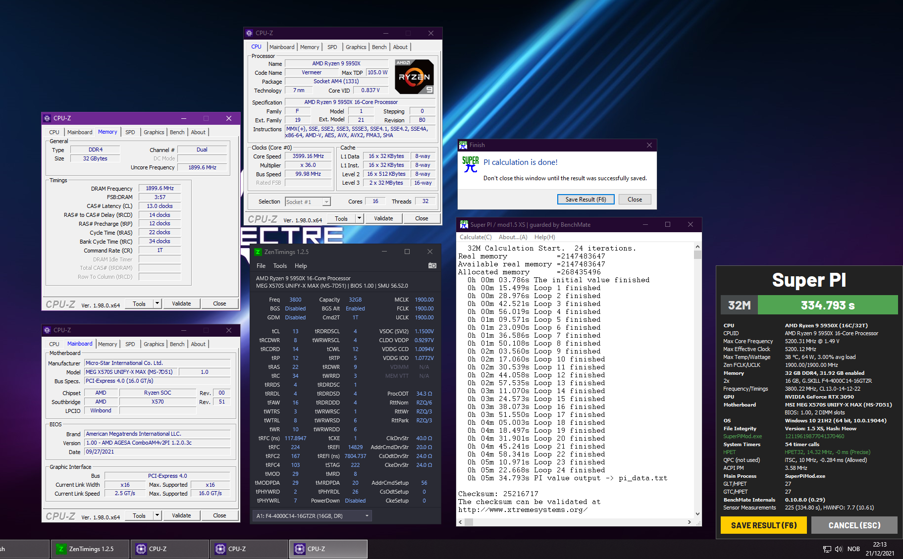

Klarte ikke noe mer hastighet på rammen sånn helt uten videre, må forske mere på dette en annen dag.. Men tok iallefall en ny highscore i y-cruncher 2.5B
Første plass på hwbot.org for 5950x med god margin
Forsøkte andre benchmarks også, men kunne egentlig ikke finne noen flere som foretrakk bandbredde over latency på samme måte som med y-cruncher. Liten forbedring in 7-Zip bench
Som trøstepremie blei det en ny personlig highscore med synca minne i superpi 32m:image.thumb.png.4ab548378be6507037f947ece6daed44.png
