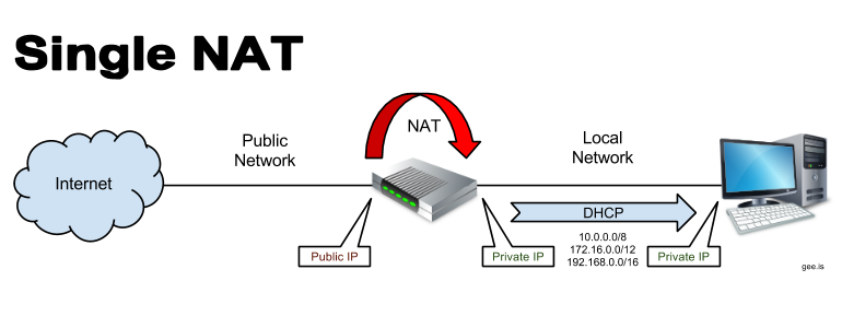

So what is NAT and why is it bad? Well NAT isnt bad, it is a solution to for the limited number of IP addresses that exist for the internet (roughly 4 Billion) and allows ISPs to assign just 1 public IP address for each connection instead of 1 public IP address for each device/computer/laptop/phone on your local network. What occurs is everything behind the NAT device shares the same singular public IP address and all devices on the local network use a reserved range of private IP addressing.

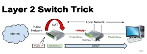

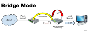

So here is a quick diagram visualising NAT, basically the modem/router is configured to get a single IP address from the ISP and then has an internal private IP address range where the modem/router is configured to automatically assign these IP addresses via DHCP to all devices in the local network. (Im including DHCP in the diagram because this may require reconfiguration in the solutions section)
post-30484-0-62515300-1400670427_thumb.pngSo Single NAT is necessary for most configurations and allows multiple devices on a local network to share the same connection via the same public IP address, how is this different from Double NAT?

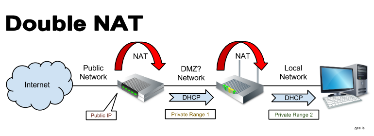

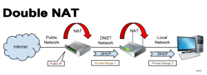

Basically what occurs is that another network device has been added to the local network (A wireless router perhaps?) and is also performing NAT along with the original device. This works because the second device has a WAN/Internet port configured to accept and use the DHCP IP address from the first device, but also by default has NAT turned on and has its own private network which is also distributing IP addresses via DHCP.
Lets say a device similar to the one below, the current ADSL/Cable modem is connected directly into the blue Internet/WAN port and all other devices connect wirelessly or are directly connected to the yellow switchports.
Everything technically works because static and dynamic NATs occur on each device which hops data across each device, the network is segmented at a layer 3 level so layer 2 protocols like DHCP do not conflict.
Problems arise mainly because the NAT tables on one device fill up or lose track of a particular connection, this type of configuration will cause issues with peer-to-peer technologies that are unable to effectively trace back the network path, MTU path discovery may not function or break and gaming/media services that use uPnP probably will not work unless reforwarding these services manually.

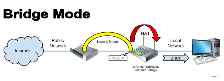

Turn on and configure bridge mode on the Cable/ADSL modem:
Im not a fan of this method mainly because of my background working at an ISP, this solution will eliminate the ability to remotely manage the Cable/ADSL modem and will most likely require a direct connection to reconfigure in future.
Using this method the Cable/ADSL modem is turned into a dumb device which passes information transparently to the second device, the WAN/Internet port is configured into PPPoE mode and all the ISP information is configured as it was on the Cable/ADSL modem.
If you were using any ports on the Cable/ADSL modem to connect a PC it will probably no longer work and need to be connected into the second device.

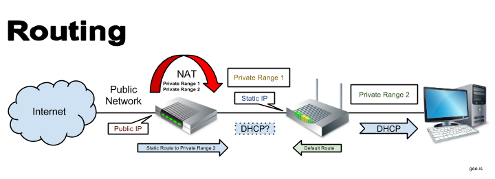

Turn off NAT on the second device and configure routing:
You might be thinking by now Well if the problem is Double NAT, just turn one NAT off. Well you can, but the problem is if you are still using the WAN/Internet port it is acting as a Layer 3 switch/router so additional routing will need to be setup on your network for this configuration to work.
Another consideration is that the ADSL/Cable modem will need perform NAT for both IP ranges, some devices might do this automatically, some might need to be configured and the rest wont support it at all (It will depend on the device).
The second device will need to be assigned a static IP address for the WAN/Internet interface in the first private range, with the Default Gateway set to the Cable/ADSL modems internal IP address (and NAT turned off obviously).
The Cable/ADSL modem will need a static route configured for second private range which will be routed to the static IP address configured on second device.(You can leave DHCP on or turn it off as required) Once this is completed any traffic from the internet will be NATed on the Cable/ADSL modem then forwarded to the second device and finally to the end user device.

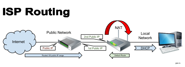

Use additional Public IPs in your network:
This solution is not for everyone, it involves your ISP providing you with additional public IP addressing. In my case, working for ISP managing business grade services, we managed the edge device (Cable/ADSL modem) and the client managed their own network. Sometimes this involved a corporate firewall which requires direct access to the public Internet.
A /30 public IP range is routed to the Cable/ADSL modem which provides 2 usable public IP addresses to the connection, the first is assigned to the inside of the Cable/ADSL Modem and the second is assigned to the WAN/Internet port of the client device (this is really what the WAN/Internet port is for when NAT is turned on).
Layer 2 Switch Trick:
This is my recommended solution, I didnt see this mentioned at all in my research and its quite a simple solution which is why I like it. Effectively what you are doing is turning the wireless router/network device into a switch which removes any routing or natting issues. I also like it because if you are trying to troubleshoot network issues eliminating as many possible causes to the problem will simplify and isolate the issue.
If you can spare one switchport (one of the yellow ports from my example picture) basically instead of pluging the Cable/ADSL modem into the WAN port of the second device, connect it directly into one of the switchports.
You should configure a static IP address on the second device in the same local IP address range so you can continue to manage it (but it does not need a Default Gateway) and turn off DHCP off on this device. Technically either device can be configured for DHCP but it is important that only one device does it (and its probably easier if the Cable/ADSL modem does it).
Once this is done hopefully everything just work.
