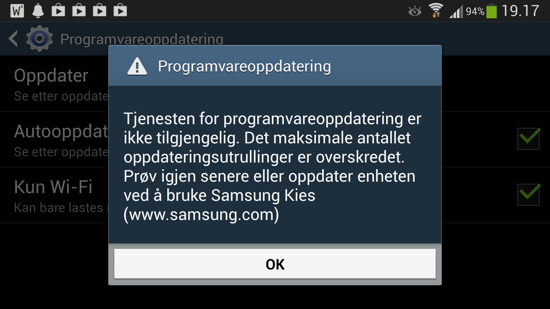

]Jeg får ikke oppdatert men jeg får denne feilmeldingen.

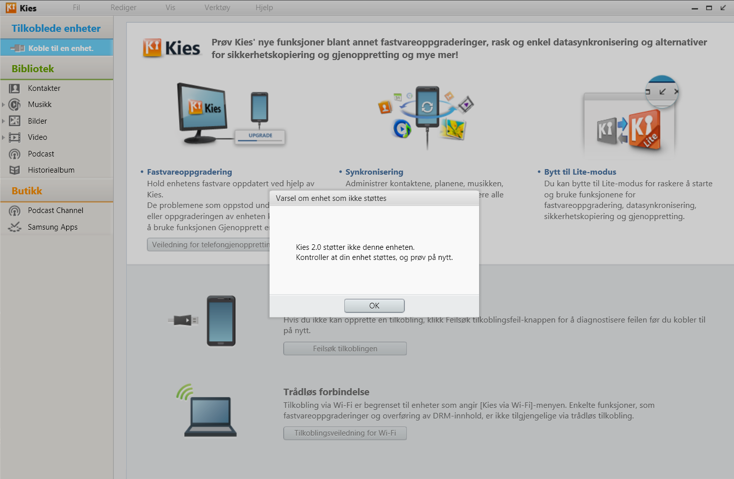

Får heller ikke koblet til med samsung kies! Får beskjed at kies ikke støtter denne tlf!
Noen som kan løse dette!
Fikk samme melding. Du må oppdatere Via Samsung Kies Som Will I'am sier. Husk at du må lade telefon til værtfall 70-80% før du kan oppdatere firmware for å forhindre bricking. Oppdateringen kan ta litt tid.
Kan ikke oppdatere via Kies. Får beskjed at kies ikke støtter denne enheten og jeg har også oppdatert Samsung kies!
Telefonen har også vært helt fulladet
https://www.google.c...iw=1920&bih=955
http://forum.xda-dev...d.php?t=1958479
"I get the following error message:
This device is not supported by Kies 2.0
Make sure that your device is supported and try again.
And this is using the latest version of Kies."
"Hi, I went through the same problem and fixed it.
First uninstall Kies from your PC and make sure you doesn't leave behind any files.
Uninstallation of the software and the drivers installed by Kies I suggest using Revo uninstaller to do that.
Uninstall it from your PC then make a fresh installation.
Open Kies but do not connect your phone, if it wants to update Kies, go ahead and do it.
Close Kies, connect your phone and open Kies.
That should fix it."
"That worked perfectly.
Thanks."
