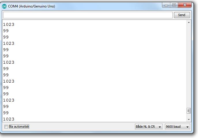

Gjest Slettet+5132 Skrevet 8. desember 2016 Skrevet 8. desember 2016 (endret) Bruk Map(). /* Map an analog value to 8 bits (0 to 255) */ void setup() {} void loop() { int val = analogRead(0); val = map(val, 0, 1023, 0, 255); analogWrite(9, val); } I ditt eksempel vil det være: val = map(val, 0, 1023, 0, 99); Her er hva jeg har nå: /* AnalogReadSerial Reads an analog input on pin 0, prints the result to the serial monitor. Graphical representation is available using serial plotter (Tools > Serial Plotter menu) Attach the center pin of a potentiometer to pin A0, and the outside pins to +5V and ground. This example code is in the public domain. */ // the setup routine runs once when you press reset: void setup() { // initialize serial communication at 9600 bits per second: Serial.begin(9600); } // the loop routine runs over and over again forever: void loop() { // read the input on analog pin 0: int sensorValue = analogRead(A0); // print out the value you read: Serial.println(sensorValue); delay(1); // delay in between reads for stability } Hvor skal det settes inn? Bruk Map(). /* Map an analog value to 8 bits (0 to 255) */ void setup() {} void loop() { int val = analogRead(0); val = map(val, 0, 1023, 0, 255); analogWrite(9, val); } I ditt eksempel vil det være: val = map(val, 0, 1023, 0, 99); Endret 8. desember 2016 av Slettet+5132
Gavekort Skrevet 8. desember 2016 Skrevet 8. desember 2016 (endret) /* AnalogReadSerial Reads an analog input on pin 0, prints the result to the serial monitor. Graphical representation is available using serial plotter (Tools > Serial Plotter menu) Attach the center pin of a potentiometer to pin A0, and the outside pins to +5V and ground. This example code is in the public domain. */ // the setup routine runs once when you press reset: void setup() { // initialize serial communication at 9600 bits per second: Serial.begin(9600); } // the loop routine runs over and over again forever: void loop() { // read the input on analog pin 0: int sensorValue = analogRead(A0); //Her kommer til 0 til 1024 verdi som settes til sensorValue. Serial.println(sensorValue); //Her printes f.eks 512 ut sensorValue = map(sensorValue, 0, 1023, 0, 99); //Her så endrer du sensorValue til å bli Map av sensorValue Serial.println(sensorValue); //Her printes den nye sensorValue ut, som er 50 // print out the value you read: Serial.println(sensorValue); delay(1); // delay in between reads for stability } Endret 8. desember 2016 av Gavekort
Gjest Slettet+5132 Skrevet 8. desember 2016 Skrevet 8. desember 2016 Virker nesten, hver tredje linje er fortsatt 0-1023
Gavekort Skrevet 8. desember 2016 Skrevet 8. desember 2016 /* AnalogReadSerial Reads an analog input on pin 0, prints the result to the serial monitor. Graphical representation is available using serial plotter (Tools > Serial Plotter menu) Attach the center pin of a potentiometer to pin A0, and the outside pins to +5V and ground. This example code is in the public domain. */ // the setup routine runs once when you press reset: void setup() { // initialize serial communication at 9600 bits per second: Serial.begin(9600); } // the loop routine runs over and over again forever: void loop() { // read the input on analog pin 0: int sensorValue = analogRead(A0); //Her kommer til 0 til 1024 verdi som settes til sensorValue. Serial.println(sensorValue); //Her printes f.eks 512 ut sensorValue = map(sensorValue, 0, 1023, 0, 99); //Her så endrer du sensorValue til å bli Map av sensorValue Serial.println(sensorValue); //Her printes den nye sensorValue ut, som er 50 // print out the value you read: //Serial.println(sensorValue); //Kommentert ut delay(1); // delay in between reads for stability } Nå vil den printe ut to verdier 1023 og 99. Kobler du til en variabel motstand mellom Aref og A0 så vil du kunne justere denne verdien opp og ned. Serial.println() betyr at det vil printe ut verdien av den variabelen som er inni parantesene, og siden du hadde tre stykker av Serial.println() så var det tre verdier som ble printet for hver iterasjon av loop-løkken din.
Gavekort Skrevet 8. desember 2016 Skrevet 8. desember 2016 (endret) Ja. Om du fjerner eller kommenterer ut den linjen som printer ut 1023. Fasit: Kommenter ut eller slett øverste Serial.println(sensorValue); Endret 8. desember 2016 av Gavekort
