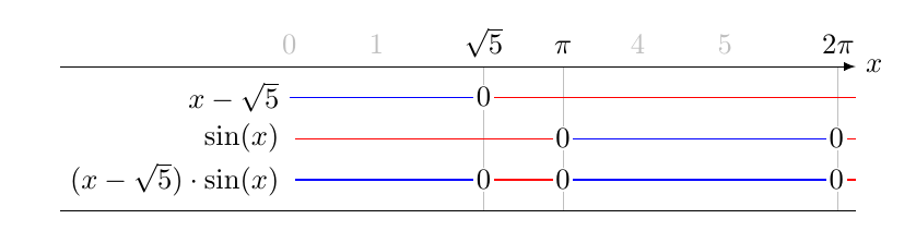

Torbjørn, noen idè om hvorfor tikz plutselig har snudd fortegnslinjene opp ned?
Veit ikkje akkurat kvifor, men om du endrer y=-0.5cm til y=0.5cm mot slutten av axis-innstillingane er det tilbake slik det skal vere. \hspace{-0.75ex} må og fjernast, jfr. kommentaren til Jake.
\documentclass[border=3mm]{standalone}
\usepackage{pgfplots}
\usepackage{amsmath}
\begin{document}
\pgfplotsset{
    shift down/.style={
         y filter/.code={\pgfmathparse{\pgfmathresult*(#1)}}
    shift down/.default=1,
    every axis plot post/.style={restrict y to domain=0.5:inf},
    positive/.style={
        no markers,
        red
    negative/.style={
        no markers,
        blue
    /tikz/function label/.style={
        anchor=east
    step functionallinenumber/.code={
        \stepcounter{functionallinenumber}
    title entries/.initial={}
\makeatletter
\newcommand\functionalline[4][\@empty]{
    \edef\plots{
        \noexpand\addplot [negative, shift down=#3, forget plot] {#2<0};
        \noexpand\addplot [positive, shift down=#3, forget plot] {#2>0};
    \plots
    \node at (axis cs:\pgfkeysvalueof{/pgfplots/xmin},#3) [function label] {%
        \ifx#1\@empty%
            $#2$%
        \else%
            $#1$%
        \fi
    \pgfplotsinvokeforeach {#4} {
       \node at (axis cs:##1,#3) [
        fill=white,
        inner sep=1pt,
        declare function={x=##1;} % Set 'x' to current position
    \pgfkeys{/pgf/fpu}% Use the fpu library, because it doesn't throw an error for divide by zero, but sets result to +/- inf
    \pgfmathparse{#2}%
    \pgfmathfloatifflags{\pgfmathresult}{0}{0}{x}% Check whether result is zero.
    \pgfkeys{/pgf/fpu=false}%
\newenvironment{functionallines}[3][]{
    \begin{tikzpicture}
    \begin{axis}[
        extra x ticks = {#2},
        grid=none,
        xticklabel pos=right,
        hide y axis,
        x axis line style={draw=none},
        every tick label/.style={
            anchor=base,
            yshift=1ex,
            gray!50
        every extra x tick/.style={
                anchor=base,
                yshift=1ex,
                inner xsep=0pt,
                fill=white,
                text=black
        extra x tick style={grid=major},
        xtick pos=right,
        major tick length=0pt,
        enlarge x limits=false,
        enlarge y limits={abs=0.75},
        domain=#3,
        samples=100,
        y dir=reverse, y = 0.5cm,
        clip=false,
        #1
    \coordinate (bottom right) at (rel axis cs:1,0);
    \coordinate (top right) at (rel axis cs:1,1);
    \end{axis}
    \draw [-latex] (top right-|current bounding box.west) -- (top right) node [right] {$x$};
    \draw (bottom right) -- (bottom right-|current bounding box.west);
    \end{tikzpicture}
\begin{functionallines}[
    extra x tick labels={$\sqrt{5}$,$\pi$,$2\pi$},
    xtick={0,1,4,5}]{2.23,3.14,6.3}{0:6.5}
    \functionalline[x-\sqrt{5}]{x-2.23}{1}{2.23}
    \functionalline[\sin(x)]{sin(x*180/3.14)}{2}{3.14,6.28}
    \functionalline[(x-\sqrt{5})\cdot \sin(x)]{(x-2.23)*sin(x*180/3.14)}{3}{2.23,3.14,6.28}
\end{functionallines}
\end{document}

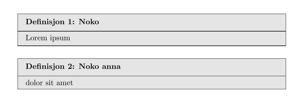

Får til å lage enkle nye kommandoer som dette - \newcommand{\kommentar}[1]{\colorbox{blue!20}{\textit{#1}}}
Men hvordan går jeg frem for å lage en ny kommando av noe som har begin og end? Bruker mdframed for å skrive definisjoner i, der jeg har definert en boks slik:
\usepackage[RGB]{xcolor}
\usepackage[framemethod=TikZ, xcolor=RGB]{mdframed}
\usepackage{showexpl}
\definecolor{lightGreyBox}{RGB}{245,245,245}
\mdfdefinestyle{styleOne}{%
rightline=true,innerleftmargin=10,innerrightmargin=10,
frametitlerule=true,
backgroundcolor=lightGreyBox,
frametitlerulewidth=0.5pt}
Et eksempel i dokumentet er:
\begin{mdframed}[style=styleOne, frametitle={Definisjon 9.3 Induktivt definert mengde}]
En \textbf{induktivt definert mengde} (eng: inductively defines set) er den minste mengden som inneholder en gitt mengde - kalt en \textbf{basismengde} (eng: base set / initial set) - og som er lukket under gitte operasjoner. En mengde defineres induktivt i følgende tre steg:
\begin{description}
\item[-] Basissteget (eng: base base /basis): å spesifisere en basismengde.
\item[-] Induksjonssteget (eng: induction step): å spesifisere operasjonene.
\item[-] Tillukningen (eng: closure): å ta den minste mengden som inneholder basismengden og som er lukket under operasjonene.
\end{description}
\end{mdframed}
Men det hadde vært litt greit å slippe å skrive [style=styleOne, frametitle={Definisjon 9.3 Induktivt definert mengde}], og at jeg f.eks bare kunne skrevet (envt på en liknende form):
\begin{definisjon}[tittel]
En \textbf{induktivt definert mengde} (eng: inductively defines set) er den minste mengden som inneholder en gitt mengde - kalt en \textbf{basismengde} (eng: base set / initial set) - og som er lukket under gitte operasjoner. En mengde defineres induktivt i følgende tre steg...
\end{definisjon]
Ta ein titt på Example 5 – Theorem environments i bruksanvisninga til mdframed.
\documentclass{article}
\usepackage{mdframed,xcolor}
\mdfdefinestyle{definisjon}{%
  rightline=true,
  innerleftmargin=10,
  backgroundcolor=black!10,
\mdtheorem[style=definisjon]{definisjon}{Definisjon}
\begin{document}
\begin{definisjon}[Noko]
Lorem ipsum
\end{definisjon}
\begin{definisjon}[Noko anna]
dolor sit amet
\end{definisjon}
\end{document}

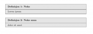

post-21406-0-52993300-1447510534_thumb.png Endret av Torbjørn T.
Takker! Latex kommer virkelig til sin rett når man kan lage nye kommandoer, osv. Begynte bare med det denne høsten, pga jeg antakelig kommer til å måtte skrive masteroppgaven min i det senere. Men nå liker jeg det så godt, at jeg nesten bruker det til all form for skriving.
Hmm, har forsøkt å lese meg opp på dokumentasjonen, men får ikke til å fjerne autonummerering (samt kolon etter der det står "Definisjon". (Dvs, får til å fjerne det ved å bruke * (stjerne) når jeg bruker det inne i dokumentet, men skulle gjerne hatt det skrudd av som standard).
Er det ikkje betre med autonummerering? Kan ikkje umiddelbart sjå ein måte å gjere det på i mdframed-manualen.
Kolonet kan du fjerne med theoremseparator:
\mdtheorem[style=definisjon,theoremseparator={}]{definisjon}{Definisjon}
Ok, takk. I en artikkel så hadde autonummerering vært det beste. Men nå holde jeg på å skrive ned notater fra pensumboka, og da vil ikke alltid nummereringen følge hverandre.
Tok en titt på tcolorbox, virker som on det å unngå nummerering der er litt enklere. Noen erfaringer med den pakken?
