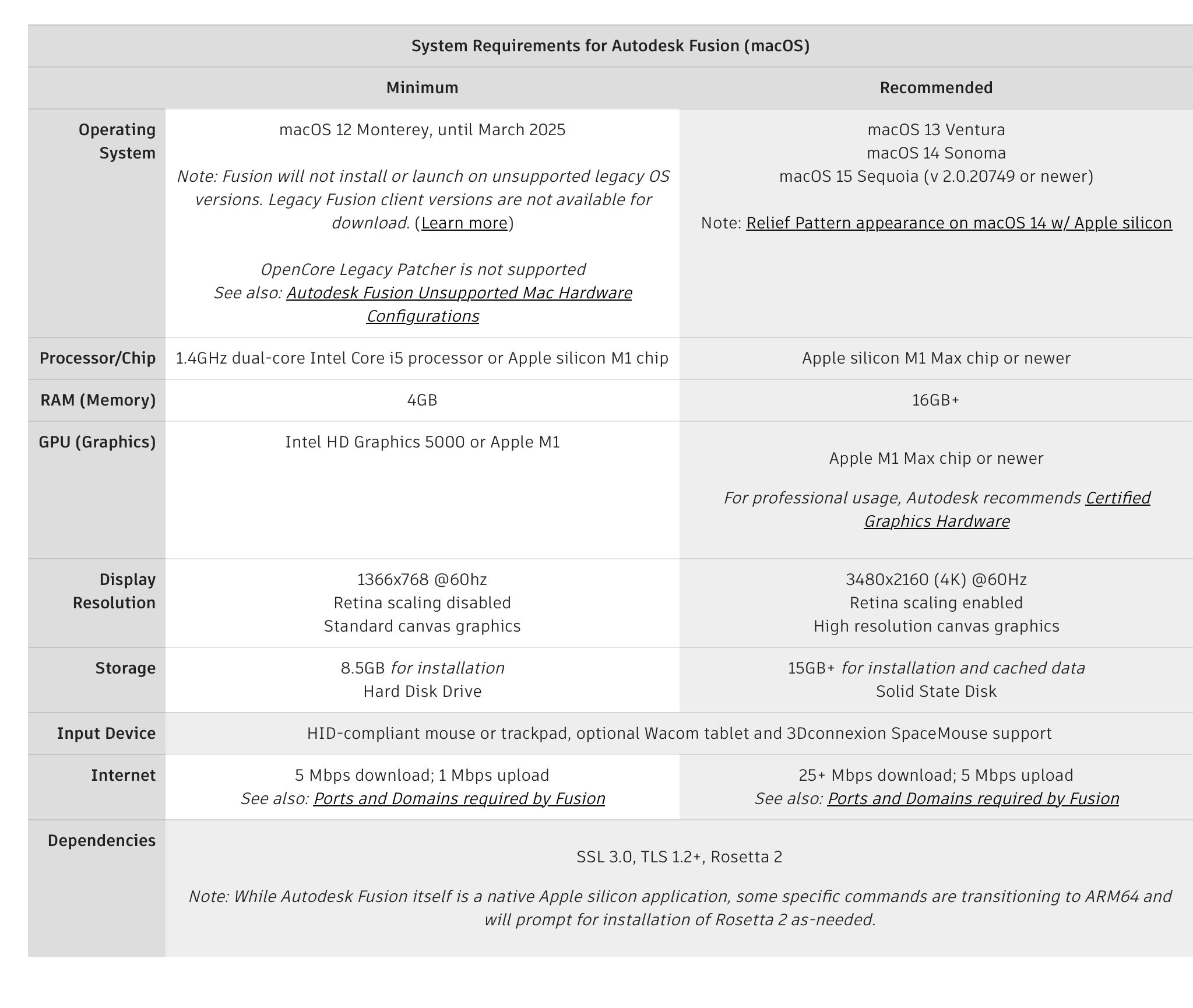

Syar-2003 Skrevet 9. februar Skrevet 9. februar https://www.autodesk.com/support/technical/article/caas/sfdcarticles/sfdcarticles/System-requirements-for-Autodesk-Fusion-360.html
