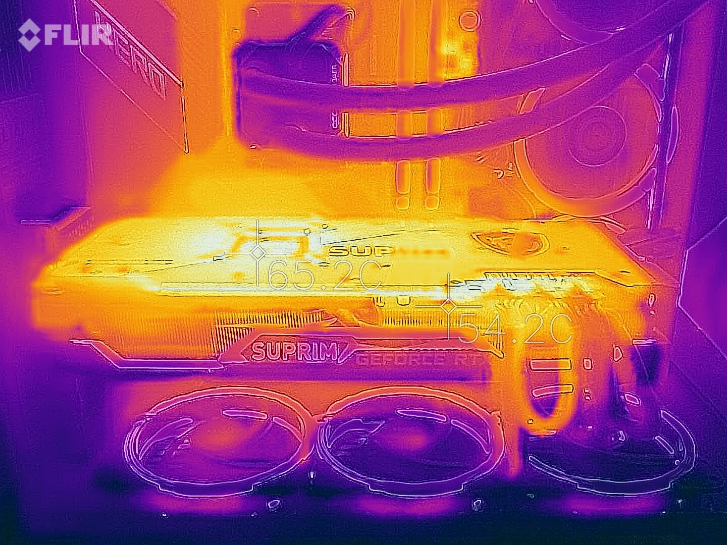

Pc Lynet Skrevet 9. februar 2021 Skrevet 9. februar 2021 Geir T skrev (Akkurat nå): Takker for innspill. 👍 Ja, har tenkt på tanken, men hadde vært interessant å høre erfaringer med andre som har 3090 kort, og hvordan vifte-RPM og temperaturer fungerer - især OC-variantene som trekker mer strøm. Å skru fra hverandre et grafikkort på 23000kr vil jeg helst slippe... :) Jeg har hatt Suprim X 3080 og 3070 det blir varmt, men kjøleren er en av de mest stillegående. Sitat Emissions of the MSI GeForce RTX 3090 Suprim X It should be clear to everyone that you can't expect any power-saving miracles with the GeForce RTX 3090. MSI increases the power consumption of the GeForce RTX 3090 Suprim X even further with a higher TDP of up to 420 watts. For comparison purposes: The reference model has a specified TDP of up to 350 watts. Although MSI adds another 70 watts, our review sample performs quite well in the load test. 70 °C (~158 °F) is the highest temperature in the stress test when the case is closed. This is a good value and shows that the cooling concept works optimally. The three 100-millimeter fans often even stand still and only start to rotate at just under 50 °C (~122 °F). This means that the graphics card isn't audible in idle usage; the fans don't need to work when there's a good airflow in the case. Under load, we measure a noise level of 36.1 dB(A) for the entire system at a distance of 20 centimeters next to the case and at the height of the graphics card. If the graphics card is left to work in silent mode, the noise level slightly drops to 35.1 dB(A). As expected, power consumption is high. It should also be mentioned that our measurements refer to the entire system (including nine 120-millimeter fans). In idle usage, just under 106 watts are drawn from the socket; at the same time, 597 watts are displayed on our measuring device under load when gaming. If you now increase the power target to 450 watts, you'll easily exceed 600 watts during gaming. Compared to the other graphics cards that we have tested so far, the MSI GeForce RTX 3090 Suprim X leads this field by a wide margin. Those who buy the MSI GeForce RTX 3090 Suprim X should definitely be able to have a strong power supply unit. Our recommendation is an 850-watt power supply unit at the minimum. https://www.notebookcheck.net/GeForce-RTX-3090-Suprim-X-in-review-MSI-s-new-high-end-graphics-card-series.509010.0.html
Gjest Slettet-QB4VTZbn Skrevet 9. februar 2021 Skrevet 9. februar 2021 (endret) Takker PC-Lynet. Nå testet jeg med Crysis Remastered (very high) og Control (max settings) i 3440x1440, så kortet fikk kjørt seg godt. Problemet er hva som regnes som "stille" av erfarne PC-brukere. Jeg har brukt mest Mac, men hadde en spill-PC for et års tid siden en stund. Hvis stresstesten i anmeldesen gav maks 70C, så er det noe galt her. Er det kjøleren som ikke sitter bra nok? Kan jo være kortet fikk seg en trøkk i Posten... Vet ikke helt hva annet jeg kan gjøre her. Skulle gjerne hatt temperaturen og støynivået ned noen hakk.. Endret 9. februar 2021 av Slettet-QB4VTZbn

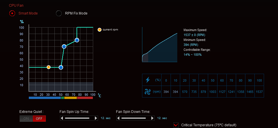

shinsengumi Skrevet 10. februar 2021 Skrevet 10. februar 2021 (endret) Prøv litt mer nøytralt/negativt trykk i kabinettet. Monter radiator i toppen med 2 vifter som eksos og putt de 2 andre viftene i front som inntak. Edit: radiator i front har ikke noe å si for gpu temps. Men du har alt for positivt trykk i kabinettet så den varme lufta tar lenger tid å komme seg ut. Edit 2: med asus hk har du tilgang til fanxpert, ikke sett preset quiet/standard e.l. Lag egne fan curves med tolerabelt støynivå. Gå til hver vifte i fanxpert og velg "RPM Fix Mode" og sett viften til 100% og dra den ned til du kommer til en lydnivå du synes er greit. Noter hvilken rpm det evt er og gå tilbake til Smart Mode. Sett så første prikk på f.eks 50c og ta rpm du landet på i fix mode i % fra skjemaet på siden. Der har du idle curven din, sett så prikk nr 2 på f.eks 70c og (antagelig) 60-70% fanspeed. Gjør det samme for alle vifter inkludert aio/radiator og sett Fan Spin Up/Down Time til 12 sec+ for minimalt med gnål. Og edit 3: min 3090 strix OC idler på 30c i skrivende stund. 65-68c på full blast, har kun 3 vifter i kabinettet Endret 10. februar 2021 av shinsengumi
