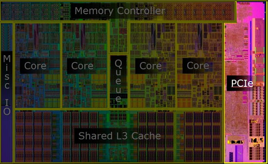

Det0x Skrevet 8. september 2009 Skrevet 8. september 2009 (endret) Jeg er glad jeg valgte x58 jeg, min w3520 kjører på 4.1ghz 24/7 med HT enable + uncore @ 3500 mhz og ram @ 1560mhz. "Back when I asked Intel why anyone would opt for LGA-1366 over LGA-1156 one of the responses I got was: overclocking. The most overclockable CPUs will be LGA-1366 chips." "Overclocking Lynnfield at Stock Voltage: We're PCIe Limited Remember the on-die PCIe controller? Yep. It's to blame. Lynnfield is Intel's first attempt at an on-die PCIe controller and it actually works surprisingly well. There are no performance or compatibility issues. The on-die PCIe controller needs more voltage as you overclock Lynnfield, limiting Lynnfield's stock vt overclocking potential. Unfortunately the PCIe controller on Lynnfield is tied to the BCLK. Increase the BCLK to overclock your CPU and you're also increasing the PCIe controller frequency. This doesn't play well with most PCIe cards, so the first rule of thumb is to try and stay at 33MHz multiples when increasing your BCLK. The second issue is the bigger one. As you increase the BCLK you increase the frequency of the transistors that communicate to the GPU(s) on the PCIe bus. Those transistors have to send data very far (relatively speaking) and very quickly. When you overclock, you're asking even more of them. We know that Bloomfield can easily hit higher frequencies without increasing the core voltage, so there's no reason to assume that Lynnfield's core cannot (in fact, we know it can). The issue is the PCIe controller; at higher frequencies those "outside facing" transistors need more juice to operate. Unfortunately on Lynnfield rev 1 there doesn't appear to be a way to selectively give the PCIe transistors more voltage, instead you have to up the voltage to the entire processor. Intel knows the solution to Lynnfield's voltage requirement for overclocking, unfortunately it's not something that can be applied retroactively. Intel could decouple the PCIe controller from BCLK by introducing more PLLs into the chip or, alternatively, tweak the transistors used for the PCIe interface. Either way we can expect this to change in some later rev of the processor. Whether that means we'll see it in the 45nm generation or we'll have to wait until 32nm remains to be seen. The good news is that Lynnfield can still overclock well. The bad news is that unlike Bloomfield (and Phenom II) you can't just leave the Vcore untouched to get serious increases in frequency." As I see it, LGA-1366 has a few advantages: 1) High-end multi-GPU Performance 2) Stock Voltage Overclocking 3) Future support for 6-core Gulftown CPUs Hentet ifra Anandtech *edit* Her er foresten en preveiw av i3: [HKEPC] Intel Core i3 Clarkdale Review: 32nm + GPU Inside Endret 8. september 2009 av Det0x

Simen1 Skrevet 9. september 2009 Skrevet 9. september 2009 X58 får jo 2x16 PCIe istedenfor 2x8 PCIe, det er kanskje verdt litt? Tja, nå har PCIe x8 v2 samme båndbredde som PCIe x16 v1, og det er i følge tester ikke noe mangel på båndbredde. Dersom man dobler båndbredden så får man ingen nevneverdig ytelseøkning. Det er altså kun et teoretisk tap og ikke noe man opplever i praksis. LGA1156 har integrert PCIe-kontroller i CPU-kjernen. Det har ikke LGA1366. Det betyr at LGA1156 har en teoretisk fordel med lavere latency (responstid) mellom CPU og GPU. Det betyr i praksis heller ikke noe. Med andre ord taler forskjellene i PCIe-system hverken for eller mot LGA1156. Hva bruker man mer enn 4 GB RAM til? Det er nok noen som bruker over 4 GB på desktop, men jeg tror det blir stadig færre som bruker så mer minne som 500 kr gir dem. For et par år siden fikk man 2 GB for 500 kr. Det tror jeg var flere som brukte. Et par år før det igjen fikk man 0,5 GB for 500 kr. Det tror jeg det var ennå flere som brukte. Med andre ord virker det som behovet ikke vokser fult så raskt som tilbudet. Vel og merke innen desktop-bruk, en fornuftig prislapp og programvare som var moderne på det aktuelle tidspunktet. Men i desktop/gaming bruk så er det hastighet og ikke minnemengde som er viktig? Egentlig ingen av delene. Det er rask SSD, GPU og dobbeltkjerne CPU som er viktigst. Men, det er egentlig ikke så mange spill som er veldig krevende nå for tida. Så det kommer mye an på hvilke spill man spiller. Mange nye spill kan godt spilles på 5 år gamle PCer, men det er gjerne de som krever mest som trekkes frem i tester. Sitter å leser tester på harde livet nå og syntes dette sitatet fra AnandTech var interessant; "See how the Core i7 870 and Core i5 750 fit nicely in between the Core i7 920 and 975? Yeah, that's because pretty much anything below the 975 doesn't make sense anymore thanks to Lynnfield." Vil dette si at Intel mest sannsynligvis nå faser ut 920 og 940 og bruker X58/1366 til ekstrem 4 kjerners og til nye 6-8 kjenners prosessorer? 920 og 940 vil nok selges utover vinteren også. Utfasingen begynner nok ikke før intels extrem-prisede 6-kjerner dukker opp. Da regner jeg også med at 965 og 975 blir erstattet av 960 og 970 med litt lavere TDP og lavere priser. 6-kjernene vil overta pristoppen på rundt 1000 $. og jeg som for en uke siden fikk meg i7-920, tusenlapp ut vinduet. Det var kjapt. For 6,5 døgn siden "tenkte du litt på å kjøpe i7". Når kommer det billige 8 kjerner da ? Når 12-kjernene kommer ned i 3000 kr og 16-kjernene koster 10 000 kr. Det skjer antagelig om ca 3-4 år. (Med billig tenker jeg 1000-1500 kr) Hvis du snakker om ekte kjerner nå så må 6-kjerners komme først;) Som blir I9 og kommer i løpet av 2010, noen tester den allerede. Men de blir ikke billige. Han spurte om når 8-kjerner blir billige.
