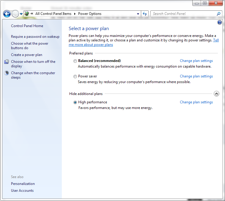

High Performance funker for meg ihvertfall.
