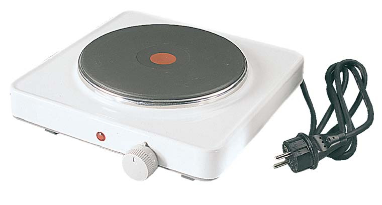

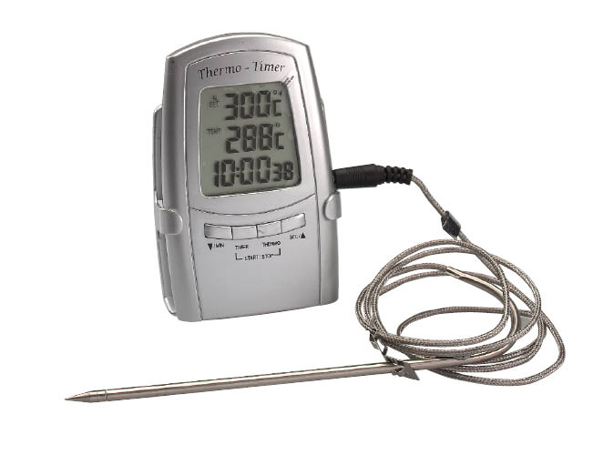

Here are the electric stove and thermometer which I plan to use...
esa
EDIT: *needed to show pictures...
Endret av esa
Nevermind, I figured out I can't use the electric stove (kokeplate). However the thermometer I can use, just need to find an electric skillet (have no clue what it is called in Norwegian). Here are two examples:

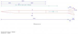

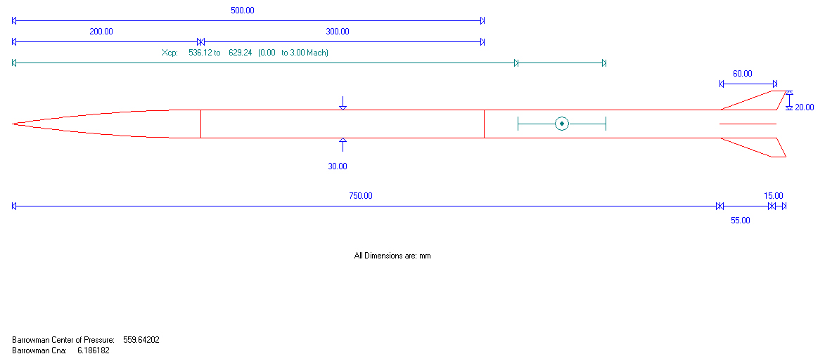

Here is more of an updated design, still needs to be tweaked though...
*aka "accelerator" (maybe)
*trying to get it to break mach

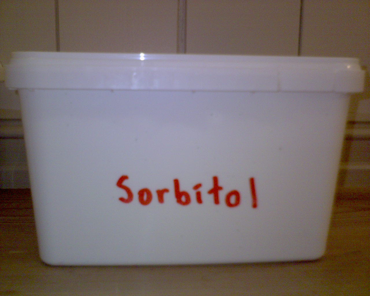

- Sorbitol, is a sugar used for the diabetic, and is the easiest sugar propellant to cast, and has the longest burn rate. :D

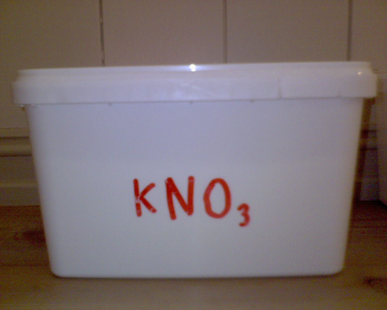

Also, KNO3 (aka, KN) is potassium nitrate (kaliumnitrat). It is the oxidizer of the rocket fuel, that means it "gives" off the oxygen to the fuel. The fuel being the sugar :thumbup:
Tomorrow I plan to start the construction of the Nozzle, Bulkhead, and Casing of my SRM (Solid Rocket Motor). I am also getting help with the 3D program (SolidWorks 2005). So I will see how far I get tomorrow...
In the meantime, here are some pictures of my newly stored propellant:
Nothing really interesting at all, but just to give you a generall idea of it (6L total) :roll:

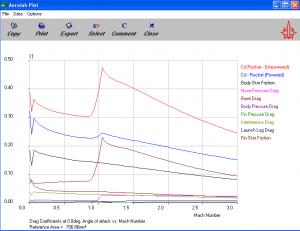

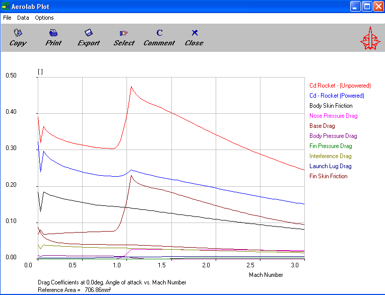

For those who want to know more, here are the various pressures, thrust, impulse, graphs; just almost everything! Just open below, very important information! :idea:
Data and Kn:
Skjult tekst: (Marker innholdet i feltet for å se teksten):
Pressure:
Performance:
Output:
Propellantdata:
Burnrate:
UnitsConv:
Class:
