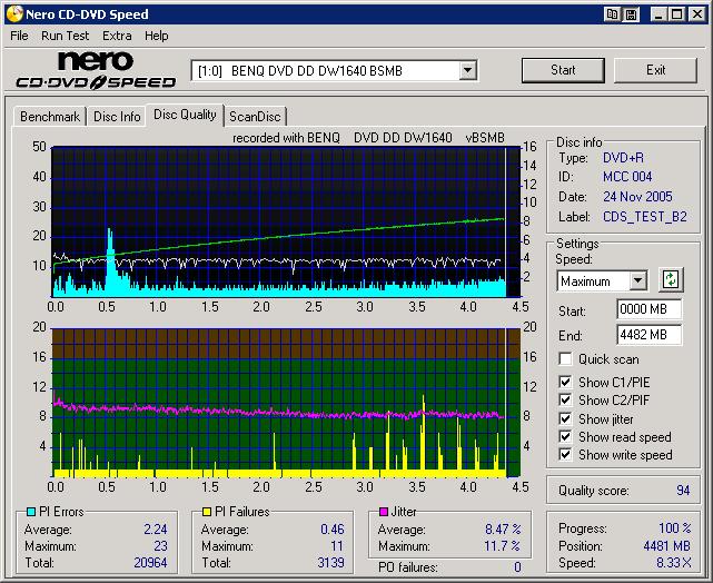

Tok "motet til meg" i går, og oppdaterte firmware,
kjørte deretter en liten test.
General Information
Drive: BENQ    DVD DD DW1640
Firmware: BSMB
Disc: DVD+R (MCC 004)
Selected speed: Maximum
PI errors
Maximum: 23
Average: 2.24
Total: 20964
PI failures
Maximum: 11
Average: 0.46
Total: 3139
PO failures: 0
Jitter
Maximum: 11.7 %
Average: 8.47 %
Scanning Statistics
Elapsed time: 9:41
Number of samples: 17925
Average scanning interval: 8.00 ECC
Glitches removed: 0
Er ikke sikker på om dette ble noe bedre enn før...

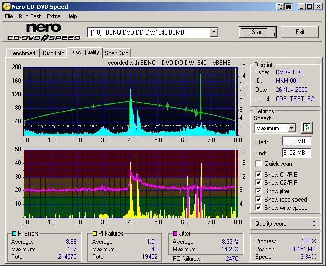

Etter å ha investert i noen DL-DVD+R ( Verbatim DataLifePlus ) Reorder# 43460
som bare ga meg feilmelding ang. fixation of lead-in ved brenning
fra IMG fil og VIDEO_TS ( Nero, ImgBurner, ONES, Alcohol 120% samme resultat)
kostet jeg på meg en test....
General Information
Firmware: BSMB
Disc: DVD+R DL (MKM 001)
PI errors
Maximum: 137
Average: 8.99
Total: 214070
PI failures
Maximum: 46
Average: 1.01
Total: 19452
PO failures: 2470
Jitter
Maximum: 14.2 %
Average: 8.33 %
Scanning Statistics
Elapsed time: 18:05
Number of samples: 32364
Average scanning interval: 8.06 ECC
Glitches removed: 0
Hmm ....

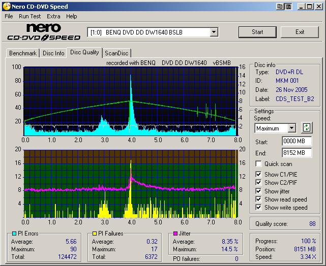

Jeg flashet tilbake til forrige versjon, og scannet samme DL plata en gang til :
General Information
Firmware: BSLB
PI errors
Maximum: 90
Average: 5.66
Total: 124472
PI failures
Maximum: 17
Average: 0.32
Total: 6372
PO failures: 0
Jitter
Maximum: 14.5 %
Average: 8.35 %
Scanning Statistics
Elapsed time: 18:07
Number of samples: 32516
Average scanning interval: 8.02 ECC
Glitches removed: 0
Kan noen forklare meg dette ?
