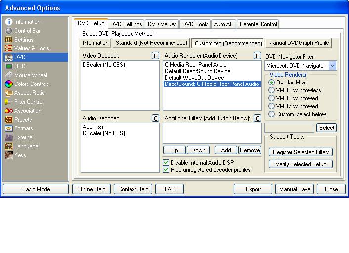

Hi,
Started setting up Zoom Player 4.03 (this was the last version I found). When I went into DVD - > Customized (Recommended) I could not select VMR9 Renderless as it was not available. Also I can see that "set Video ColorSpace" option is not availabe (also it migh appear once VMR9 Renderless is selected). I have attached printscreen to demonstrate what I mean.
What could be wrong?

1. and most important. Why I still do not see the picture :no: Is it because FFDShow is deactivated everytime I close advanced options window? I remember reading in some forums that there need to be some registry entries to adapt to PAL or NTSC viewing... I try to watch PAL DVD.
2. Do we need to press Register Selected Filters once in a Advanced Options menu? Remember reading that somewhere in another forums. I do not think this is mentioned in acticle.
3. You mention that under Resize & aspect we need to press Process whole Image. Same option is under Dscaler filter and Blur & NR but I didn't find in article if this needs to be marked or not.
I have tried different options: selected Process whole image in all FFDShow selections, Registered Selected Filters under Advanced Options - DVD setup. Reduced Resize to 1200 X 1200, Lanczos to 3 and later to 2 nothing has helped...
I use the same mobo, graphic card as in article CPU is changed to 640 3.2 GHz @ 3.9 GHz following Article 6. Hyperthreading is on in BIOS, windows are sliptstreamed.
Basically do not know what else to try... Please help.
FFDShow shouldn't be highlighted, additional filters are working when they're shown in the list.
1. Have you followed the article? Sounds to me like you either aren't using FFDShow Raw (in which case the colorspace won't work) or don't have the correct filters set up in the correct sequence. That's the most likely problem.
2. No. That's not necessary with this setup, all filters are registered when installed.
3. No, they don't. That will use more CPU without doing anything.

I am a bit embarassed to say... filters were not in the right order. Don't know if that is my Norwegian to blame or that I was customizing late in evening :blush:
Picture is finally on my screen :!: Projector project is still in the pipeline, but now I am encouraged :)
