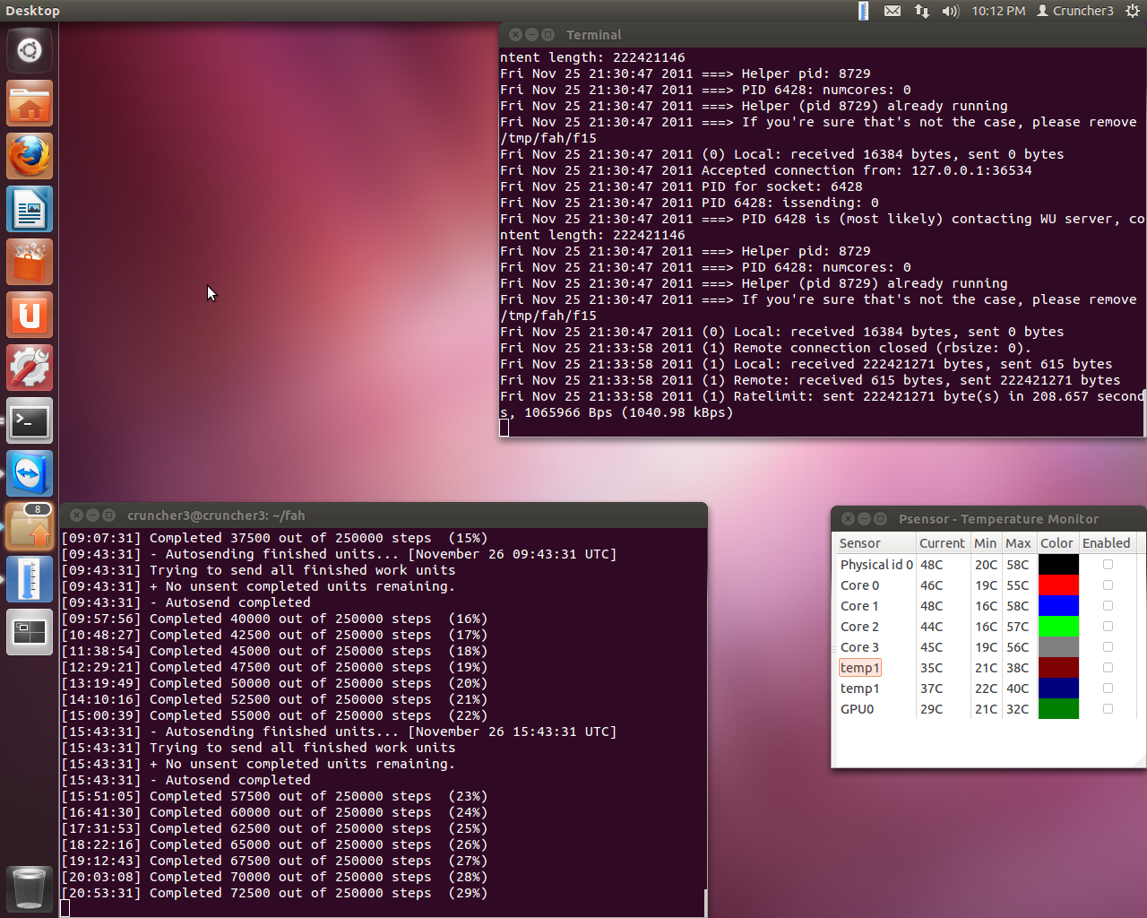

-alias- Skrevet 26. november 2011 Skrevet 26. november 2011 (endret) Sliter med at 980X riggen min ble ustabil etter at jeg flyttet den over i et nytt kabinett og inn i boligen fra garasjen. Først krasjet en P6904 på 40%, og i dag krasjet P6903 på 56%. Feilmeldinger er som følger: P6904 krasjet på 40% [23:49:53] Completed 100000 out of 250000 steps (40%) [00:05:55] mdrun returned 255 [00:05:55] Going to send back what have done -- stepsTotalG=250000 [00:05:55] Work fraction=84.4318 steps=250000. [00:05:59] logfile size=136727 infoLength=136727 edr=25 trr=1 [00:05:59] logfile size: 136727 info=136727 bed=25 hdr=1 [00:05:59] - Writing 137265 bytes of core data to disk... [00:05:59] Done: 136753 -> 16054 (compressed to 11.7 percent) [00:05:59] ... Done. [00:06:11] [00:06:11] Folding@home Core Shutdown: UNSTABLE_MACHINE [00:06:11] CoreStatus = 7A (122) [00:06:11] Sending work to server [00:06:11] Project: 6904 (Run 2, Clone 17, Gen 34) [00:06:11] + Attempting to send results [November 25 00:06:11 UTC] [00:06:11] - Reading file work/wuresults_03.dat from core [00:06:11] (Read 16566 bytes from disk) [00:06:11] Connecting to http://130.237.232.237:8080/ [00:06:12] Posted data. [00:06:12] Initial: 0000; - Uploaded at ~17 kB/s [00:06:12] - Averaged speed for that direction ~211 kB/s [00:06:12] + Results successfully sent [00:06:12] Thank you for your contribution to Folding@Home. Fikk så ned P6903 som altså gikk ned etter 56% [16:09:37] Completed 140000 out of 250000 steps (56%) [16:21:19] mdrun returned 255 [16:21:19] Going to send back what have done -- stepsTotalG=250000 [16:21:19] Work fraction=71.0778 steps=250000. [16:21:23] logfile size=164998 infoLength=164998 edr=25 trr=1 [16:21:23] logfile size: 164998 info=164998 bed=25 hdr=1 [16:21:23] - Writing 165536 bytes of core data to disk... [16:21:23] Done: 165024 -> 18540 (compressed to 11.2 percent) [16:21:23] ... Done. [16:21:35] [16:21:35] Folding@home Core Shutdown: UNSTABLE_MACHINE [16:21:36] CoreStatus = 7A (122) [16:21:36] Sending work to server [16:21:36] Project: 6903 (Run 3, Clone 10, Gen 40) [16:21:36] + Attempting to send results [November 26 16:21:36 UTC] [16:21:36] - Reading file work/wuresults_04.dat from core [16:21:36] (Read 19052 bytes from disk) [16:21:36] Connecting to http://130.237.232.237:8080/ [16:21:36] Posted data. [16:21:36] Initial: 0000; Conversation time very short, giving reduced weight in bandwidth avg [16:21:36] - Uploaded at ~39 kB/s [16:21:36] - Averaged speed for that direction ~192 kB/s [16:21:36] + Results successfully sent [16:21:36] Thank you for your contribution to Folding@Home. Noterer meg samme feilmelding begge ganger, som jeg ikke helt finner ut hva betyr. Jeg finner henvisninger for det meste til GPU folding og AMD CPU, mens Intel CPU ikke er nevnt. Jeg vil kanskje mistenke at det har noe med minnet å gjøre siden jeg hadde problemer med å få start på riggen etter flyttinga. Måtte som jeg skrev tidligere flytte minnebrikkene fra A til B bankene. Jeg klokket ned fra 4600MHz til 4550 etter første krasj, og til 4500MHz etter krasj 2. Noen som har noen gode idèer? Kan også nevne at da jeg forsøkte med ny PSU under problemene relatert til selve flyttingen og den nye ble værende i riggen, så jeg har da også byttet PSU slik at det er nevnt. Endret 26. november 2011 av -alias-

-alias- Skrevet 26. november 2011 Skrevet 26. november 2011 (endret) Det er selvsagt mulig, men den kjennes ikke varm ut. Kjører med H60 og når jeg beføler "vannblokka" så er den bare akkurat lunken. Temperaturen inne ligger på omkring 20Celsius. Jeg har målt CPU temperaturen tidligere under Windows med CPUID HWMonitor og den lå omkring 62 - 64Celsius under folding på 4.6GHz. Kabinettet den står i nå er ekstremt luftig. Skal se om jeg kan finne meg noen verktøy som måler temperaturene i Ubuntu. Edit: Fant program for sensorer og installerte det, og temperaturene ser fine ut synes jeg (hvis målingene er korrekte da) og ut fra at jeg ikke kan føle at ting er varme tror jeg kanskje at dette stemmer bra. Endret 26. november 2011 av -alias-

Mydog Skrevet 26. november 2011 Skrevet 26. november 2011 (endret) -alias- om du ha lagt inn lm sensors i ubuntu så kan du laste ned psensor via Ubuntu software senter og den viser temps på samme måte som Realtemp og Coretemp i Win, jeg bruker den på alle mine maskiner. Endret 26. november 2011 av minhund

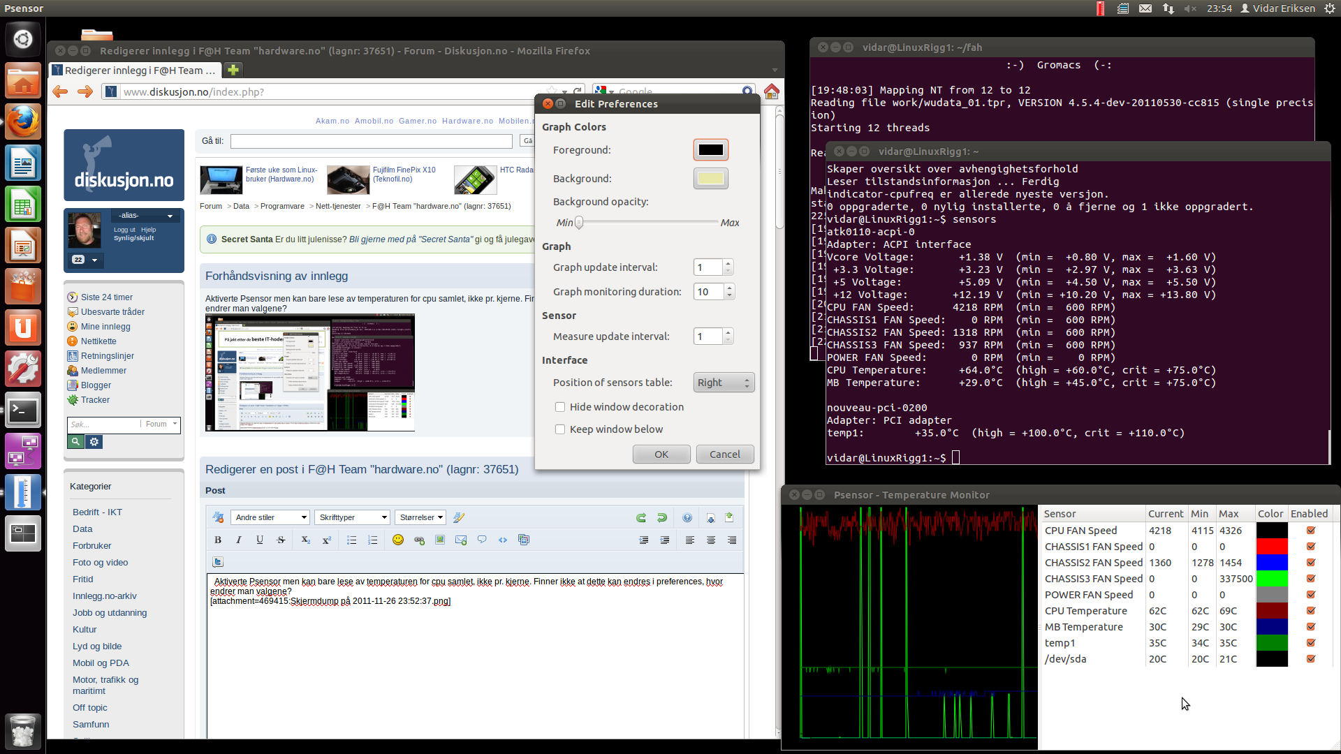

-alias- Skrevet 26. november 2011 Skrevet 26. november 2011 (endret) Aktiverte Psensor men kan bare lese av temperaturen for cpu samlet, ikke pr. kjerne. Finner ikke at dette kan endres i preferences, hvor endrer man valgene? Endret 26. november 2011 av -alias-

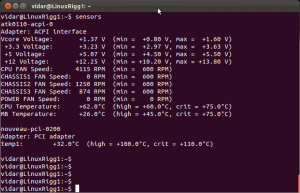

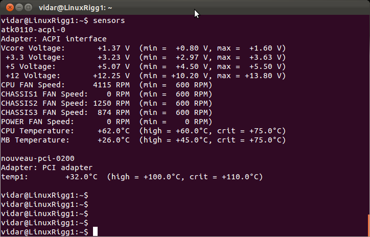

Mydog Skrevet 26. november 2011 Skrevet 26. november 2011 har du lagt inn lm sensors rett? Jeg fulgte denne guiden på den fra EVGA: How to monitor the cpu temperature: Under construction Note: the instructions below are for the Classic Desktop (Gnome). If you prefer the newer Unity Desktop, then try pegelm's procedures here: http://www.evga.com/forums/fb.ashx?m=1105678. Open a Terminal and type $ sudo apt-get install lm-sensors Type $ sudo sensors-detect This will ask you a bunch of questions that you will reply with Y for each. It will then ask if you want to append the module file and type Y. The sensors that it finds depends on your mobo. For example, my Asus P8P67 Pro has the "adt7574" probe which will only tell me the four core temps. Type $ sudo service module-init-tools start Type $ sudo sensors If you see the sensor readings, then you have done well Padawan. The next step is to show the temps in the Panel (assuming you are using the Classic Desktop).
-alias- Skrevet 26. november 2011 Skrevet 26. november 2011 Ja mener jeg gjorde det riktig, nå kan det jo skyldes forskjellig maskinvare. Linux er vel litt kjent for å ta noen innersvinger i blant, og det er ikke all maskinvare som er registrert. Jeg klarer meg godt med generell cpu temperatur.
