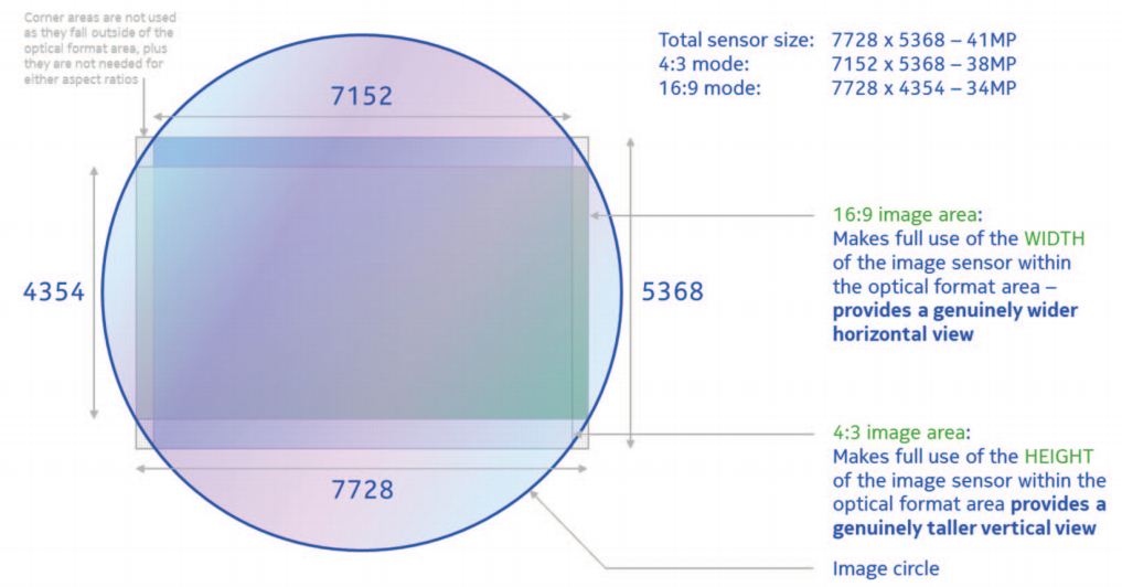

Nokia sa da de presenterte 41Mpx telefonen 808 nylig at 1.4 micron pikslene i den var omtrent den minste pikslestørrelsen som var praktisk etter hvor mye lys den klaret å absorbere. Den pikselstørrelsen i en fullformat sensor skal gi ca 440Mpx (hvis jeg husker riktig?).
Så velkommen til femtiden.
Her er Nokia sin forklaring på hvorfor det er så viktig å ha mange piksler som utgangspunkt for å få beste bilde kvalitet:
"Pixel oversampling combines many pixels to create a single (super) pixel.
When this happens, you keep virtually all the detail, but filter away visual noise from the image.
The speckled, grainy look you tend to get in low-lighting conditions is greatly reduced.
And in good light, visual noise is virtually non-existent.
Which means the images you can take are more natural and beautiful than ever.
They are purer, perhaps a more accurate representation of the original subject than has ever been achieved before."
People will inevitably home in on the number of pixels the Nokia 808 PureView packs, but they're missing the point. The 'big deal' is how they're used.
