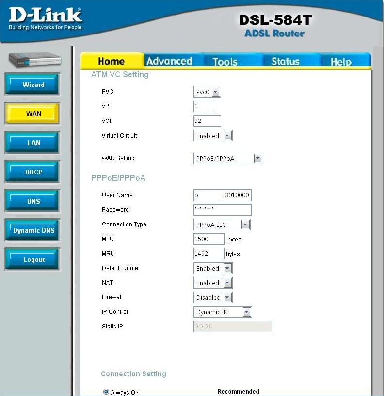

Wolves Skrevet 6. juli 2007 Rapporter Del Skrevet 6. juli 2007 Hei allesammen i'm just gonna do this in English and hope it's not causing too much trouble for you guys. atm i have ADSL 2500 from NGT with the usual Netopia 3351, which i think isn't really that good. So i got a new modem-router DSL 584T but can't get it to work. I was on the phone with a technician from NGT but he wouldn't help me since NGT isn't supporting D-link. I've tried manually setting up the router to PPPoA which is what NGT is using, but the connection won't get trough to the PC. The installation wizard won't accept the kundenummer + aktiveringspassord either and thats about where my knowledge ends.... Any help is very welcome, greetz Wolves. Lenke til kommentar

mar Skrevet 9. juli 2007 Rapporter Del Skrevet 9. juli 2007 Are there any other PPPoA connection types? According to the screenshot its set to PPPoA LLC (which should work). Under username you should use your customer id (kundenummer) without any modification. The password is the 8 digit number you received along with the Netopia router (which by the way is an excellent router). This is not the same as your email password!! Is there any information available in the “Status” tab? Lenke til kommentar

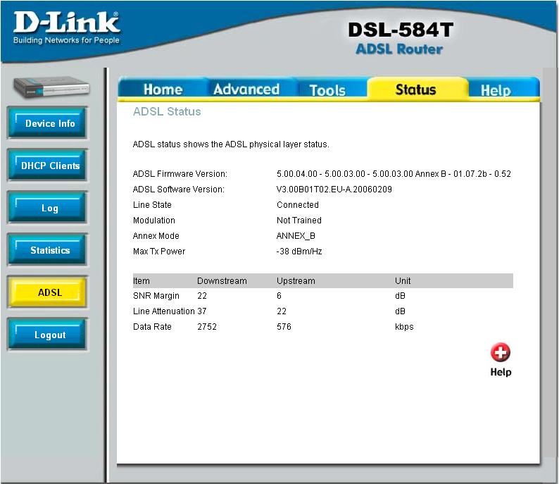

Wolves Skrevet 9. juli 2007 Forfatter Rapporter Del Skrevet 9. juli 2007 Are there any other PPPoA connection types? yes, PPPoA VC-Mux The password is the 8 digit number you received along with the Netopia router right, it doesnt work, therefore this thread.. some "Status" info: Lenke til kommentar

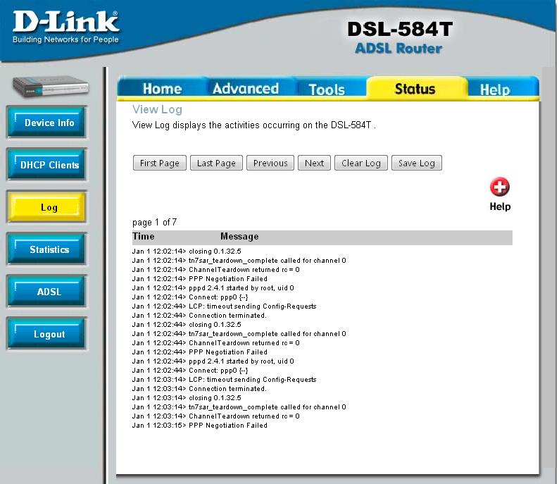

mar Skrevet 9. juli 2007 Rapporter Del Skrevet 9. juli 2007 LCP timeout, could be VP.VC problems. Try using VP.VC 0.100. If that fails try 8.35. You should also try PPPoE with 1.33 just in case. Try restarting the router after changing VP.VC values. Lenke til kommentar
