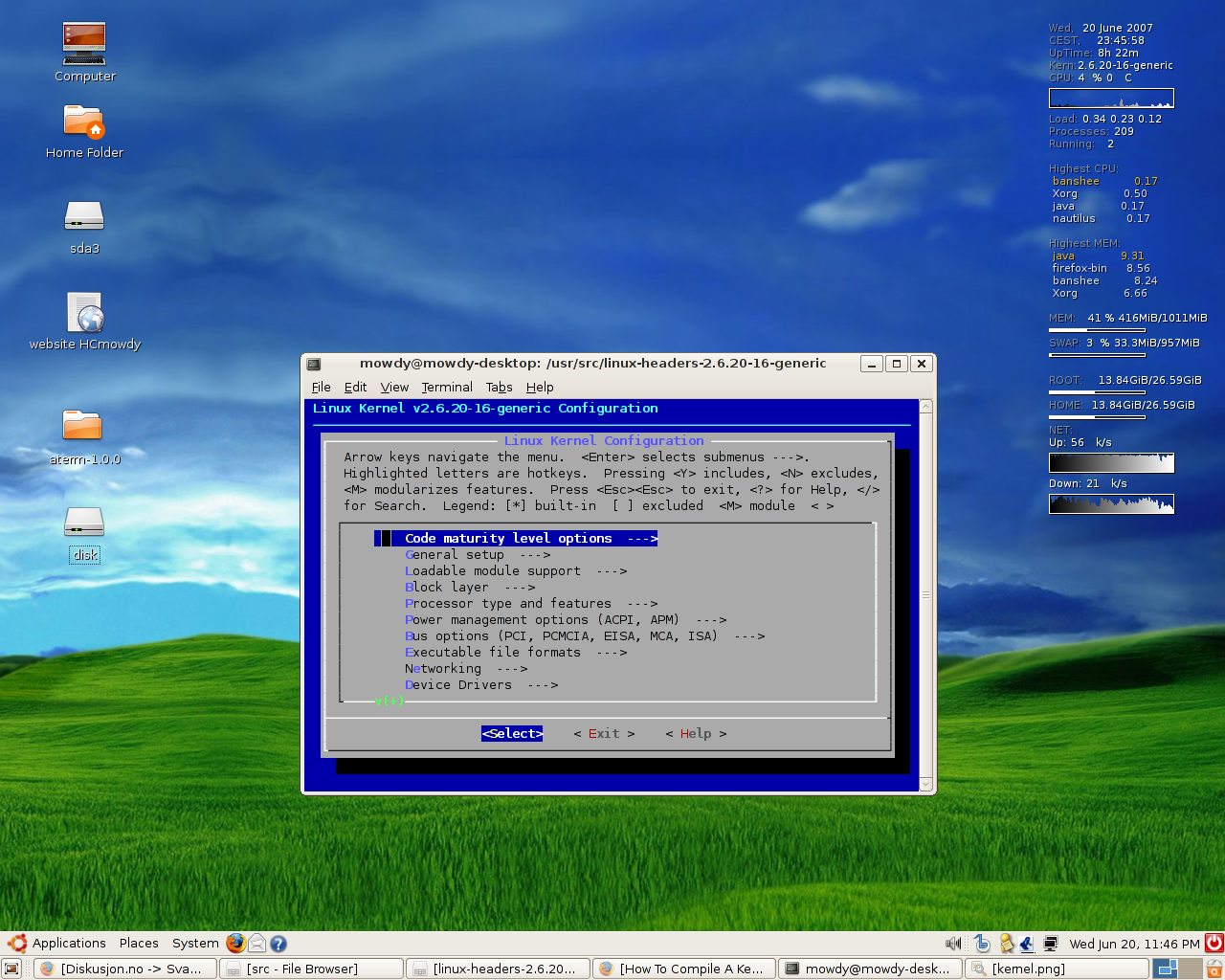

no tror eg har fått til litt
komt frem til en meny, trenger litt hjelp aldri gjort dette før og har ikkje lyst og øydelegge noe
ka skal eg gjøre her?

Ok no har eg klart og lagt di til men har et problem no:
mowdy@mowdy-desktop:/usr/src/linux-headers-2.6.20-16-generic$ sudo make menuconfig
scripts/kconfig/mconf arch/i386/Kconfig
# configuration written to .config
*** End of Linux kernel configuration.
*** Execute 'make' to build the kernel or try 'make help'.
mowdy@mowdy-desktop:/usr/src/linux-headers-2.6.20-16-generic$ make
HOSTLD scripts/kconfig/conf
/usr/bin/ld: cannot open output file scripts/kconfig/conf: Permission denied
collect2: ld returned 1 exit status
make[2]: *** [scripts/kconfig/conf] Error 1
make[1]: *** [silentoldconfig] Error 2
make: *** No rule to make target `include/config/auto.conf', needed by `include/config/kernel.release'. Stop.
scripts/kconfig/conf -s arch/i386/Kconfig
CHK include/linux/version.h
CHK include/linux/utsrelease.h
HOSTCC scripts/genksyms/lex.o
HOSTLD scripts/genksyms/genksyms
CC scripts/mod/empty.o
MKELF scripts/mod/elfconfig.h
HOSTCC scripts/mod/file2alias.o
HOSTCC scripts/mod/modpost.o
HOSTCC scripts/mod/sumversion.o
HOSTLD scripts/mod/modpost
make[1]: *** No rule to make target `init/main.o', needed by `init/built-in.o'. Stop.
make: *** [init] Error 2
mowdy@mowdy-desktop:/usr/src/linux-headers-2.6.20-16-generic$ make && make modules_install
rm: cannot remove `include/config/kernel.release': Permission denied
make: *** [include/config/kernel.release] Error 1
mowdy@mowdy-desktop:/usr/src/linux-headers-2.6.20-16-generic$ sudo make && make modules_install
ka skal eg gjøre no?
ka gjør eg feil?
ka betyr det?
