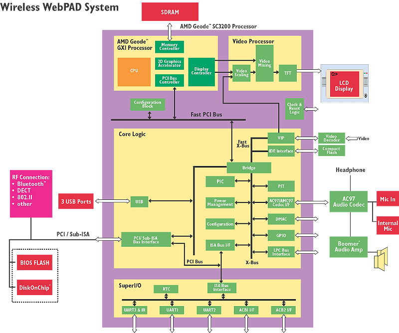

Simen1 Skrevet 6. februar 2007 Skrevet 6. februar 2007 Ja, intel har nok levert prosessorer (generelt) med integrerte brikkesett lengre enn AMD har, men altså så kortere enn AMD når det kommer til x86 prosessorer med integrerte brikkesett. Theo: Joda, AMD Geode har integrert sørbro. Technical Specifications Klikk for å se/fjerne innholdet nedenfor Primary Components * The AMD Geode™ SC3200 processor is based on the AMD Geode™ GX1 processor’s integrated core which combines advanced CPU performance with MMX™ support, fully accelerated 2D graphics, a 64-bit synchronous DRAM (SDRAM) interface, and an internal PCI bus controller * Low power consumption TFT display processor, with a hardware video accelerator for scaling, filtering, and color space conversion * Core Logic module includes PC AT functionality, a Universal Serial Bus (USB) interface, video input port, ACPI 1.0 compliant power management, and an audio codec interface * Super I/O block, including two serial ports, an infrared (IR) port, an ACCESS.bus™ interface, and a Real Time Clock (RTC) The block diagram above shows the relationships between the functional blocks in the SC3200 processor. Outstanding features * 32-bit x86 processor running up to 266 MHz, with MMX instruction set support * 64-bit SDRAM memory controller supporting up to 100 MHz operation * 2D graphics accelerator * Video processor with hardware accelerator supports scaling, filtering, and color space conversion (for video overlay) * CCIR-656 video input port * PCI bus controller * Low Pin Count (LPC) bus controller * IDE interface * Three Open HCI 1.0 compliant USB ports * AC97/AMC97 2.0 compliant audio controller * Three RS232 serial port controllers, UART1, UART2 and UART3, including fast infrared functionality * Two ACCESS.bus (ACB) interfaces * ACPI 1.0 compliant power management * Real Time Clock (RTC) * Virtual System Architecture™ (VSA™) support * 432-pin EBGA (Enhanced Ball Grid Array) package o 40 mm x 40 mm * 481-pin TEPBGA (Thermally Enhanced Ball Grid Array) package o 40 mm x 40 mm
