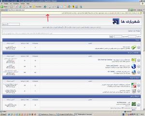

alertbar.js
Klikk for å se/fjerne innholdet nedenfor
document.writeln("<link rel=\"stylesheet\" href=\"infobar.css\" type=\"text/css\">");
document.writeln("<table width=\"100%\" cellspacing=0 cellpadding=0 border=0><tr><td width=\"100%\" align=left>");
document.writeln("<div id=\"infobar\"><a href=\"http://?p=registrering\">Du er ikke logget inn, klikk her for å registrere deg!</a></div>");
document.writeln("</td></tr></table>");
infobar.css
body {
margin: 0 !important;
padding: 0 !important;
/* A fake IE information bar */
#infobar {
font: message-box;
/* Please adjust the values if the infobar is not looking good */
#infobar a, #infobar a:link, #infobar a:visited, #infobar a:active {
display: block;
float: left;
clear: both;
width: 100%;
color: InfoText;
background: InfoBackground url(warning.gif) no-repeat fixed .3em .3em;
padding: .45em .3em .45em 2em;
border-bottom: .16em outset;
text-decoration: none;
cursor: default;
#infobar a:hover {
color: HighlightText;
background: Highlight url(warning2.gif) no-repeat fixed .3em .3em;
/* A fake viewplot for IE information bar */
#viewplot {
width: 100%;
height: expression(this.parentNode.offsetHeight - this.offsetTop);
overflow-x: hidden;
overflow-y: scroll;
padding: 1em; /* Please set this to the value as that of your <body> */
noe sånt?
PROBLEM LØST! :ph34r:
alertbar.js
infobar.css
body {
#infobar {
font: message-box;
display: block;
float: left;
clear: both;
width: 100%;
color: InfoText;
cursor: default;
#infobar a:hover {
#viewplot {
width: 100%;
overflow-x: hidden;
overflow-y: scroll;
noe sånt?
7299590[/snapback]
Endret av Unlimited
