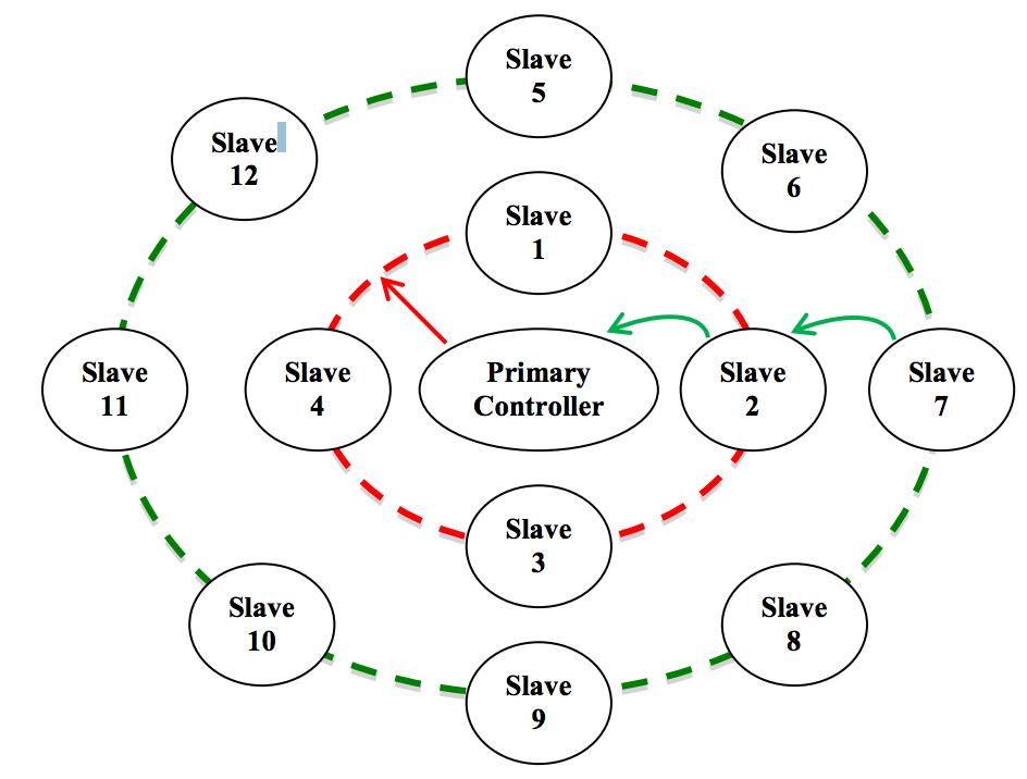

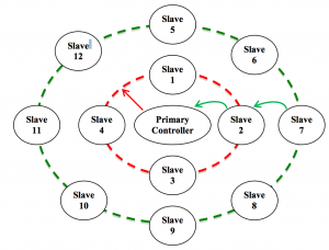

NWI (Network Wide Inclusion) er en teknologi som gjør det mulig å inkludere nye noder som er utenfor kontrollerens rekkevidde ved å rute signalet via andre noder i nettverket frem til kontrolleren.
Klippet fra https://library.ademconet.com/MWT/fs2/VAM/Introductory-Guide-to-Z-Wave-Technology.pdf
NWI is the process in which you can include devices into the primary controller that are outside the controllers
range. Before NWI, all devices had to be included within close proximity to the primary controller and then the
routing table reconfigured after installing. NWI allows the installer to start at the controller and include the devices
that are within its range. Once those have been included in the network, then the installer can include the next level
of devices that are not within direct range of the primary controller. The image below represents an ideal
installation using NWI. The key is nodes 1-4 must support NWI in order to pass the inclusion message on to the
primary controller during the inclusion process.
As depicted by the following figure, using NWI the installer will include in Slave Nodes 1-4 (red circle) first, then proceed to include nodes 5-12 (green circle). The nodes within range of the primary controller marked with a red circle and those that not within range are marked with the green circle. The red circle has a diameter of 30’ from the primary controller and the green circle has a diameter of > 75’ from the primary controller.
Example would be Node 7 is out of the range of the primary controller, so using the NWI feature of node two we will “bounce” the enrollment process off Node 2 to get a successful inclusion into the network.

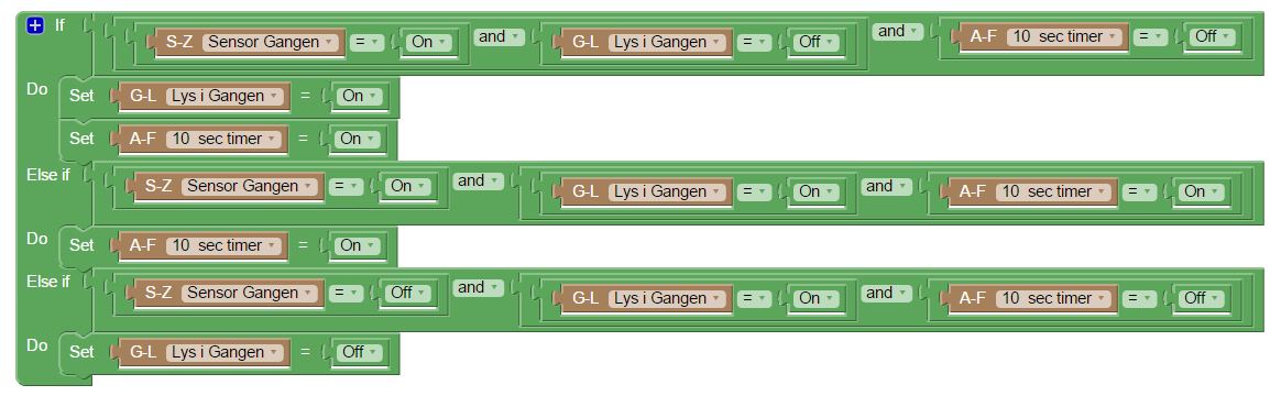

Nexa pir parret med kontakten var kjapp, men enten på i 5 sek eller 1 min. Enten for kort eller langt tid. Prøvde den u-parret og bare gjennom Telldus Live med en regel og delays, men fikk ikke til. Ble for ustabilt.
Med Domoticz, Blocky, dummy bryter  RFXcom  så funker det temmlig bra nå. Litt tregere å trigge lampen men holder seg på så lenge man er i rommet.
Fant eksemplet på Domoticz forum.

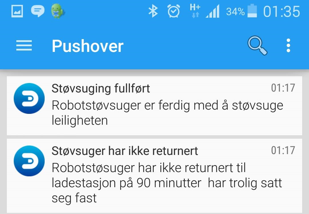

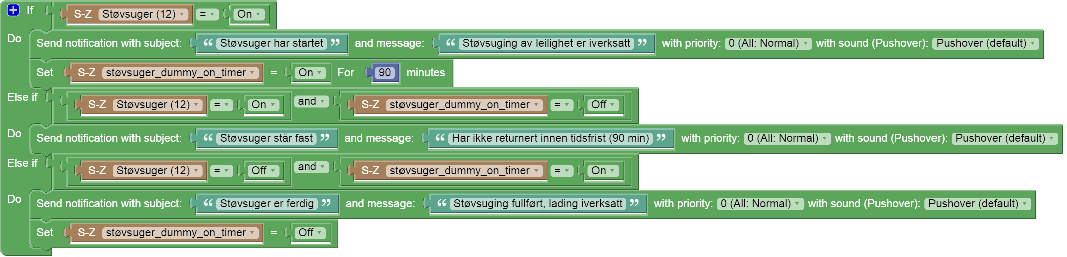

Ok, da har jeg fått ordnet meg Pushover, samt et varsling når støvsuger er ferdig, eventuelt om den ikke kommer tilbake på 90 min (bruker normalt under 60 min på å støvsuge, så bruker den så lang tid kan jeg nesten være sikker på at den har satt seg fast eller liknende)
Støvsugeren registrerer jeg forøvrig slik:

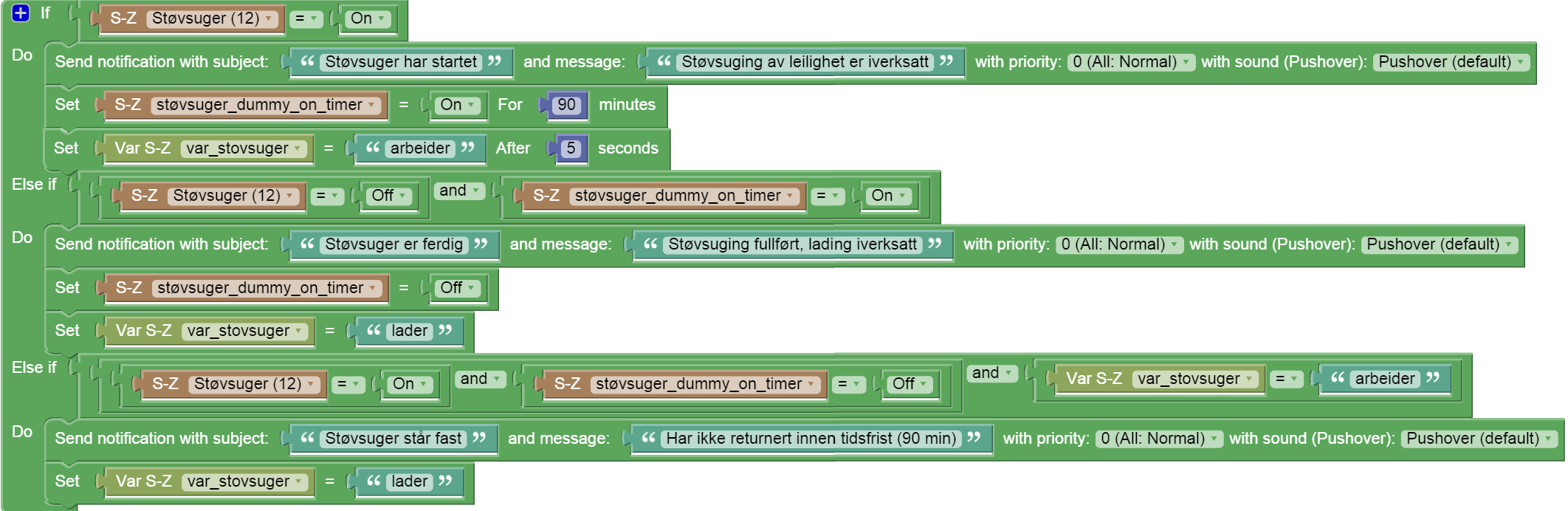

Ser bra ut. Starter støvsugeren med sin egen schedule?

Må fikle litt med den koden, tilsynelatende gir den melding om at den har satt seg fast samtidig som den starter (i tillegg til når den faktisk sitter fast).
Har modifisert litt:
Hva den gjør:
1. Sier i fra når den starter
2. Sier i fra at den har satt seg fast når den starter (det skal den ikke gjøre!)
3. Sier i fra når den er ferdig
4. sier i fra når den har satt seg fast (90 min før retur), (punkt 4 er såklart ikke gjeldende om den fullfører uten feil)
Den starter ikke selv (enda), men planen er å få ordnet det, må får til det med IR på en måte.

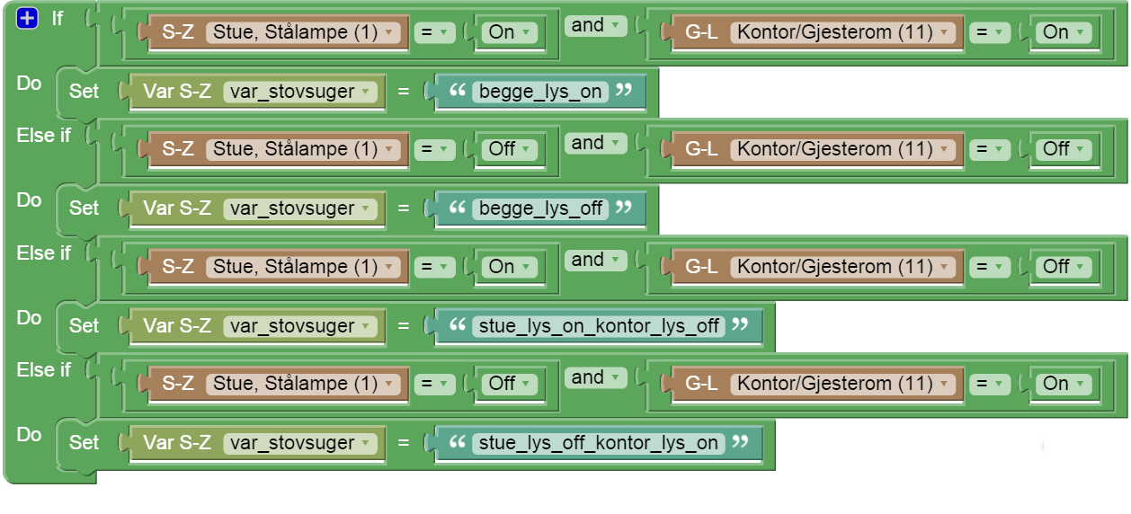

EDIT: Fant ut man kunne bruke variabler, skal få sett om det kanskje gir noen flere muligheter:
Endret av Evelen!
Bingo :) etter litt testing i kveld der følgende ut til å fungere akkurat som det skal:
Generalprøve i morgentidlig, fungerer det skal jeg prøve å få gjort den litt enklere, bla ved å kun bruke variabler og ikke variabel + dummy bryter. (PS: Her kunne man nok brukt to stk dummy brytere også) Syns dog variabler virket som en mer ryddig metode

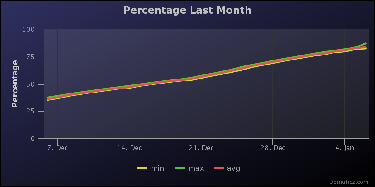

Flere som sliter med noe som for meg ser ut som minnelekasje?
root@domoticzpi:~# free -m
             total       used       free     shared    buffers     cached
Mem:           373        361         12          0         22         13
-/+ buffers/cache:        325         48
USER       PID %CPU %MEM    VSZ   RSS TTY      STAT START   TIME COMMAND
root     24404  0.7 73.7 402052 282304 ?       Ssl   2015 519:17 /home/pi/domoticz/domoticz -daemon -www 8080
EDIT: Ser ut som det var en stund siden sist jeg oppdaterte, så får se om ting bedrer seg nå.
