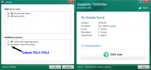

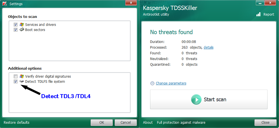

Sjekk for TDSS rootkit med Kasperskys anti rootkit utility TDSSKiller
http://support.kaspersky.com/faq/?qid=208283363
Bruk "Change Parameters" og huk av for "Detect TDLFS file system" for TDL3/TDL4 skjult i filsystem.
detect the TDLFS file system, that the TDL 3 / 4 rootkits create in the last sectors of a hard disk for storing its files. It is possible to quarantine all these files.
