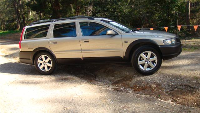

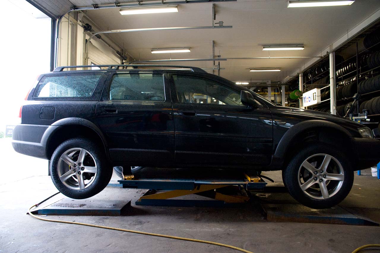

Ocean Racer also gave me a tip about using spacers. I found a page here in norway wich can deliver within a few days. However, i'm thinking that the rears may rub against the plastic due to the oversized tires. What do you think? The spacers are 1200 NOK (~200 USD) :confused:
He also gave me another link to this thread:
http://www.volvoxc.com/forums/showthread.php?t=12285

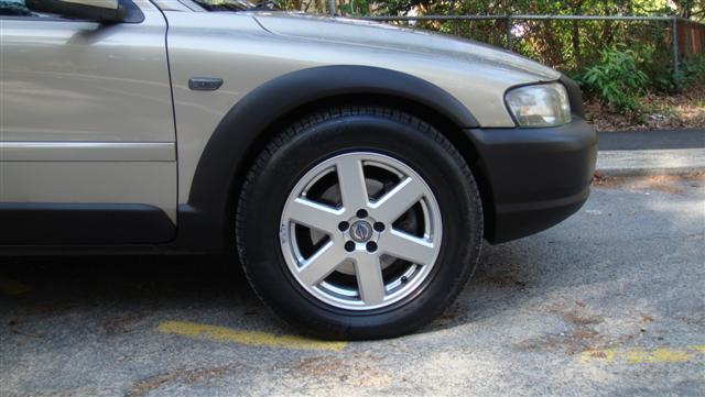

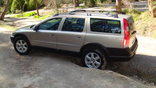

Wich is about Adelaide fitting 235/65/17 tires. However, those are used tires - and he had to modify the plastic a bit to make them fit. He also states that there is no way he'd get on a new set of those same tires.

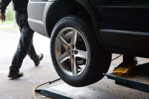

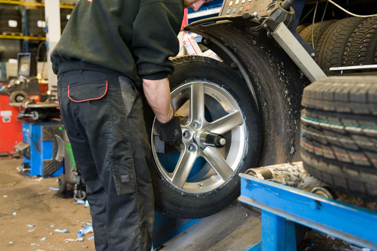

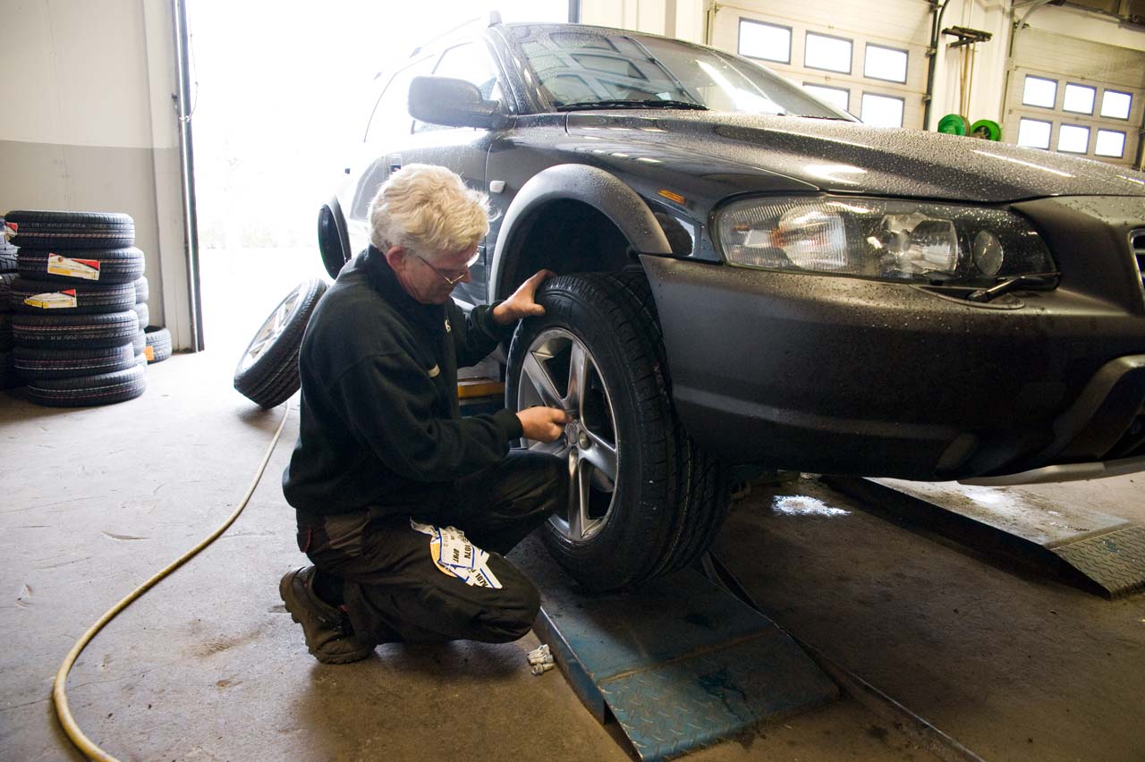

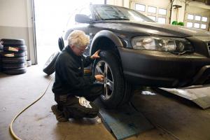

I've attached five images (de fem første). First one is Adelaides car with mentioned 235/65/17 tires, second is my 235/60/18 tires on my car (in the air). This is where i think it will get tricky. Look at the right side (forward on the car) (and last image) of the rear tires. They are "almost" touching already. Or..? I say "almost" because there is some room left. And i think it will work if i use Adelaides trick. Rest of the images is just.. more images of the insanely huge tires and cool rims. :D
EDIT: 235/60/18 is 1.3mm more in diameter, and 5.97mm more in rolling distance than 235/65/17, for those who doesn't know.
Two more images (de to siste) (for those to lazy to check Adeleides thread.) Look at how tight that rear tire is. Any way of moving it backwards a bit? :p

Er vel ikke så smart med spacere med mindre innpresset på felgene er større enn originalt. Dette pga belastning på diverse ting i hjulopphenget. Så jeg stemmer for mindre dekk.
Vet lite/ingenting om dette. Alt jeg vet er at dette skal føre til økt slitasje i de fleste tilfeller. En XC bør jo være ganske sterk men likevel. Ville heller hatt smalere dekk, noe som også vil gi mindre sporing/ustabilitet, framfor spacere.
Spacere gir jo mer sporvidde og dermed mer stabilitet / mindre sporing. Det blir ikke smalere dekk, men mindre profil. Heller bredere dekk.
Vi snakker 5-10mm mindre (235/55/18, 235/50/18 eller 245/50/18.) Det ser jo allikevel badass ut, så jeg tror nok det er noe slik jeg ender opp med.
