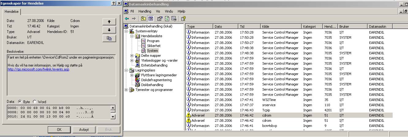

Earendil Skrevet 28. august 2006 Forfatter Skrevet 28. august 2006 Fann nokre advarslar der, screen shot ligg vedlagt.
Earendil Skrevet 28. august 2006 Forfatter Skrevet 28. august 2006 Details Event ID: 51 Source: Cdrom We're sorry There is no additional information about this issue in the Error and Event Log Messages or Knowledge Base databases at this time. You can use the links in the Support area to determine whether any additional information might be available elsewhere.
Slartibartfast Skrevet 28. august 2006 Skrevet 28. august 2006 http://www.microsoft.com/technet/support/e...cdrom&LCID=1033 No user action is required, typisk Microsoft. Har du en annen cd-rom tilgjengelig? Bare for testing? Har du problemer med drivere på eventuelle ekstra kontrollere i maskinen din?
