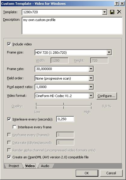

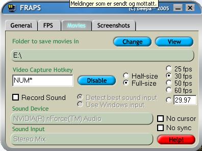

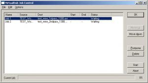

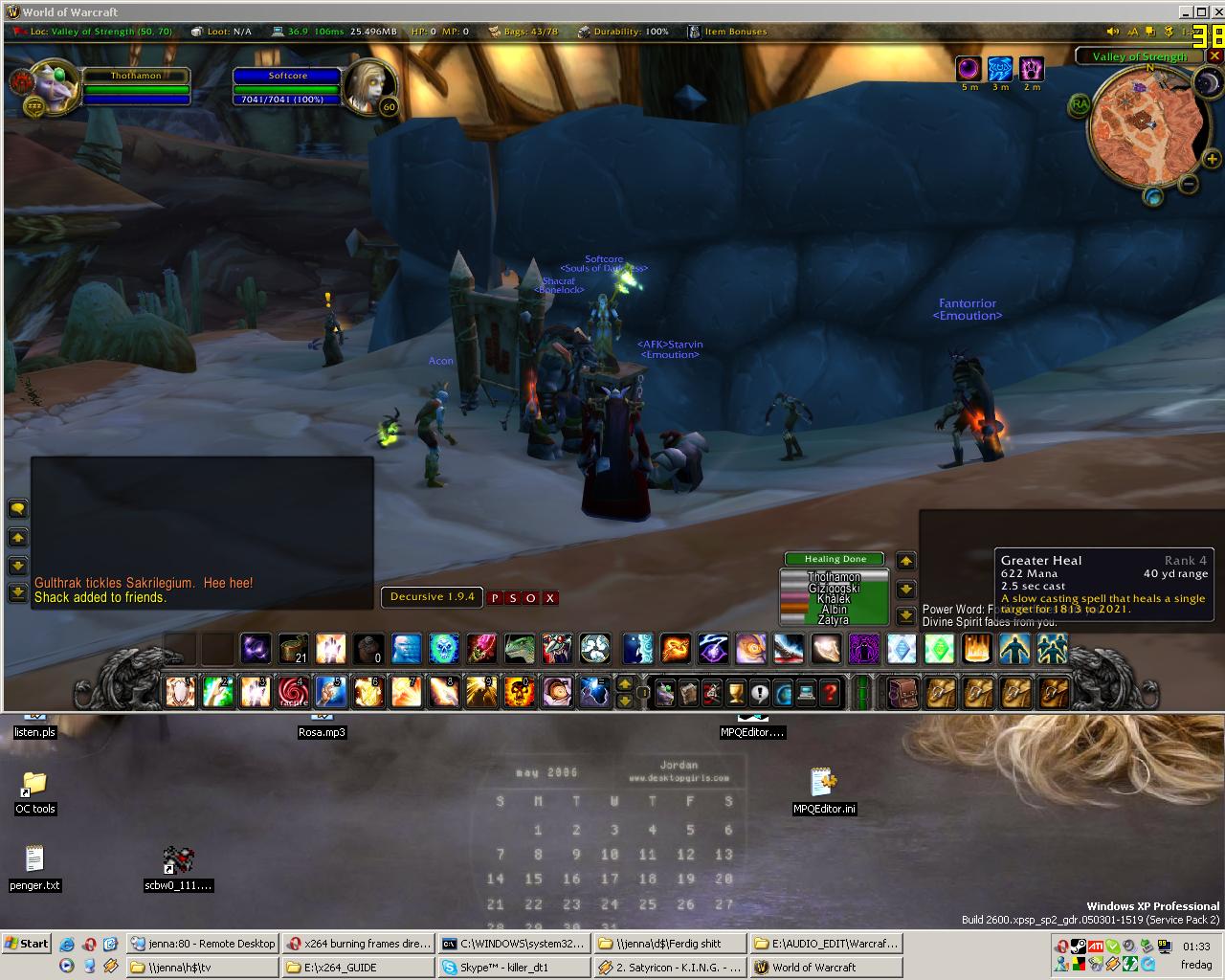

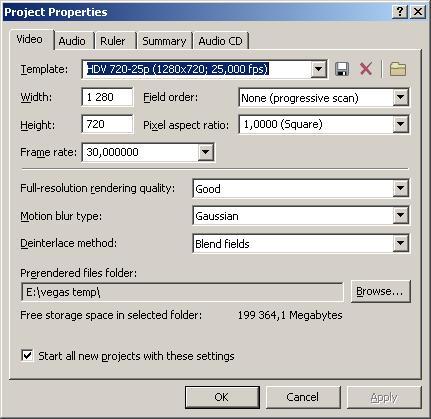

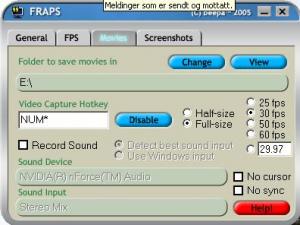

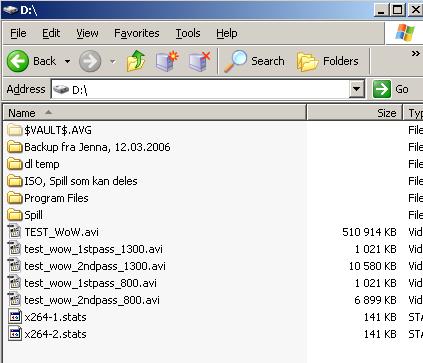

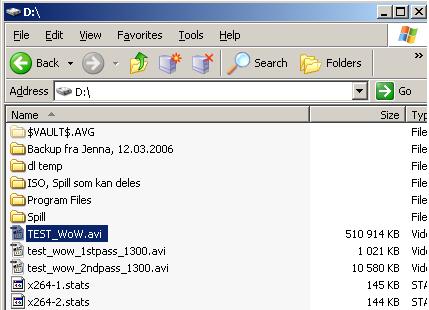

Killer_DT Skrevet 5. oktober 2006 Skrevet 5. oktober 2006 Skrev som sagt denne for noen mnd siden og da mainly til venner og bekjente der ikke alle kan norsk, derfor engelsken. Tar gjerne imot forslag til forbedring, og tips ellers. This is a guide of what I use for recording WoW movies. Software: Download and extract virtual Dub to HDD. Download and install the codec from http://x264.nl/. If you don't have Mediaplayer Classic download it from this site. MP classic is very nice for looking at the properties of a mediafile. Just open the file in question and press File->properties->Details. Download and install Fraps. Download an install Sony Vegas v6. For this you will probably need to install the correct MS .net. But as you install Vegas will provide information to what you must do, and where you get it from. Setting up World of Warcraft: I prefer to record in the highest possible resolution, and that is 1280x720 or 1280x768. Since 1280x720 has an aspect ratio of 1,7777, the exact same as 16:9 I use that. My physical screen is a 19" running at 1280x1024, so I have to run in windowed mode to get the game to properly at 1280x720. Here's a picture of what my screen look like when I have WoW in windowed mode. [complete screen.jpg] Setting up fraps: I record to a HDD which isnt used for anything else. This way performance will not be a problem. Recording is done in full size at 30 frames per second. You have the option to record audio aswell. With this on you basicly record all audio running to and from your computer. This includes everything from mp3s you play to all the guys on Teamspeak/Ventrilo/skype. [fraps.jpg] Setting up Sony Vegas: Go to File->Properties and choose the template named: "HDV 720-25p (1280x720; 25,000 fps)". Edit the fps to 30. This is a picture of what it should look like.[Vegas project settings video.JPG] After you have finished editing in Sony Vegas, go to File->Render as->custom, and make a new name and description on your new template. Then press Video at the bottom and use all the settings from this picture[Vegas custom template video.jpg] After this press audio at the bottom, and use these settings[Vegas custom template audio.jpg] That was all the setting properties in all the different programs. Now over to the practical stuff. To record a movie, start WoW and press the record button ingame. What this button is can be defined in Fraps. Press the button again to stop recording. Now you will have a huge file on your HDD. In my particular case its 4GiB for every 2min 45sec. This varies depending on resolution and if you are recording audio aswell. This file you import into Sony Vegas, also import all other video and audio files you want in the movie. As this is not a guide to editing in Vegas, I'll skip ahead to the output video you get from "render as" with the right settings. Im calling the output "TEST_WoW.avi" You should now have your finished product, exept for the fact that it is still a very large file. This we correct next in Virtual dub. Open virtualDuB.exe File->open videofile->"TEST_WoW.avi" The video should now show in the viewer. Audio compression have allready been done as shown in [Vegas custom template audio.jpg] So we dont touch those settings. They should be set at "Source audio" and "Direct stream copy". Video Compression: Now for the important and most offen the tricky part. Compressing the video stream in TEST_WoW.avi, that we got from outputting our editing from Sony Vegas. The properties of my testfile is 1280x720 resolution at 30 frames per second. My testfile is exactly 60 seconds long and with a bitrate of 8,3MiB/s its around 500MiB in size. We will be doing a 2-pass x264 encoding. Make sure Video->Full processing mode is on. 1st pass: Go to Video->Compression, select x264 on the list. Then press Configure choose "Multipass - First pass" and select a suitable bitrate. We will try with 1300 to begin with.[x264 config 1stpass.jpg] Press OK twice. Go to File->save as AVI. Make sure you press for "Don't run this job now......". Enter file name "test_wow_1stpass_1300.avi". 2nd pass: Press Video->compression->x264->configure, choose "Multipass - Nth pass". Dont change the bitrate. Press OK twice. Go to File->save as AVI. Make sure you press for "Don't run this job now......". Enter file name "test_wow_2ndpass_1300.avi". Press F4 to view jobcontrol, it should look like this with 2 jobs in queue. [vdub jobcontrol.jpg] Press start to start the compression. Depending on your CPU, your final video will be done in some time. x264 is a very heavy codec and it uses more time to compress than xvid or Divx. I use it because it has slightly better quality and im using an OCed AMD X2 CPU. The file with "1stpass" in it is not an actual video file so dont bother opening it. It's the biggest avi file with "2ndpass" in it that is the right videofile. Open it and you will see the finished edited file in an hopefully small enough size. My result now is a 60sec video with a resolution of 1280x720@30fps. Audio is at 128kbps mp3 and video is at 1300kbps. The File is 10MiB. [filesize list.jpg] If the video has lots of blocks in the image, 1300kbps was to little, just do the 1st and 2nd pass again with an increased bitrate. How to make the movie in lower resolution take a look at the next part. Resizing: 1280x720 is HDTV resolution and perhaps a little to much for some. To decrease the image and filesize we can Resize the video. This is done in Virtual dub before you select video compression. Open the output video from Sony Vegas as you did in the first part of this guide. Then press Video->Filters->Add->Resize. Now you can find any suitable resolution with the same aspect ratio as the outputfile from Vegas. Aspect ratio is 1280/720=1,7777. Im going to use the same widt as DVDs use, namely 720. To find which height is the right one: 720/1,7777=405,01. This means that the right resolution is 720x406. Use these settings in the resize filter config: [vdub resize.jpg] If you wanna use either a lower or higher resolution, just use the same formula. Now repeat the Video compression steps from the first part of the guide. Since we now have a much lower resolution on the video, we dont need as much bitrate at the 1280x720 version. Try starting at 800 and if the videoquality is to low, just increase it in a new pass. The Compressed file is now 6,73MiB, at 720x406@30fps. The quality aint bad at all either.[filesize list2.JPG]

Killer_DT Skrevet 5. oktober 2006 Skrevet 5. oktober 2006 (endret) Takker for detta.. har gått opp fra 1024x768 til 1600x1200 og har ikke skjønt hvorfor filmene fra fraps har blitt så dårlige har også brukt 60 frames. jo høyere jo bedre ikke sant. D'oh!Får kansje prøve meg på vegas igjen og. har ikke skjønt noe av det tidligere >< finnes det noen video tutorials for det mest basic tingene i vegas? "sette på text og effekter og sånt"? 7005432[/snapback] Vil anbefale deg å prøve widescreen 1280x720, om så bare engang. Kvaliteten er upåklagelig. Jeg nekter å tro at det går an å få bedre kvalitet på fraps materialet. Til trådstarter: Hvorfor skal man bare bruke 30fps hvis man skal bruke slow mot.? Jeg bruker alltid 30 fps og har fått ganske bra resultater. Endret 5. oktober 2006 av Killer_DT
