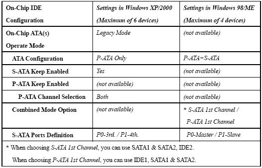

MSI Reminds You...
If you wish to use S-ATA devices on your mainboard while the
ATA devices connected to the IDE1 and IDE2 are also available,
you MUST have Windows XP/2000 operation system in your
computer, and configure the settings listed as following when
you enter the BIOS setup program.
However, if you are using Windows 98/Me, please also refer to
the following settings for the best performance.
se vedlagt liste over innstillinger
kanskje dette kan hjelpe deg på vei? De ter bare til å prøve å mekke ulike innstillinger, og se hva som fungerer...
