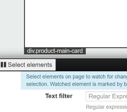

Velg bare den øverste hvite firkaten med PS5 info i. Jeg fikk feilmelding når jeg monitorerte lagerstatus og "ikke på lager" knappen.
MiRaCL skrev (2 timer siden):

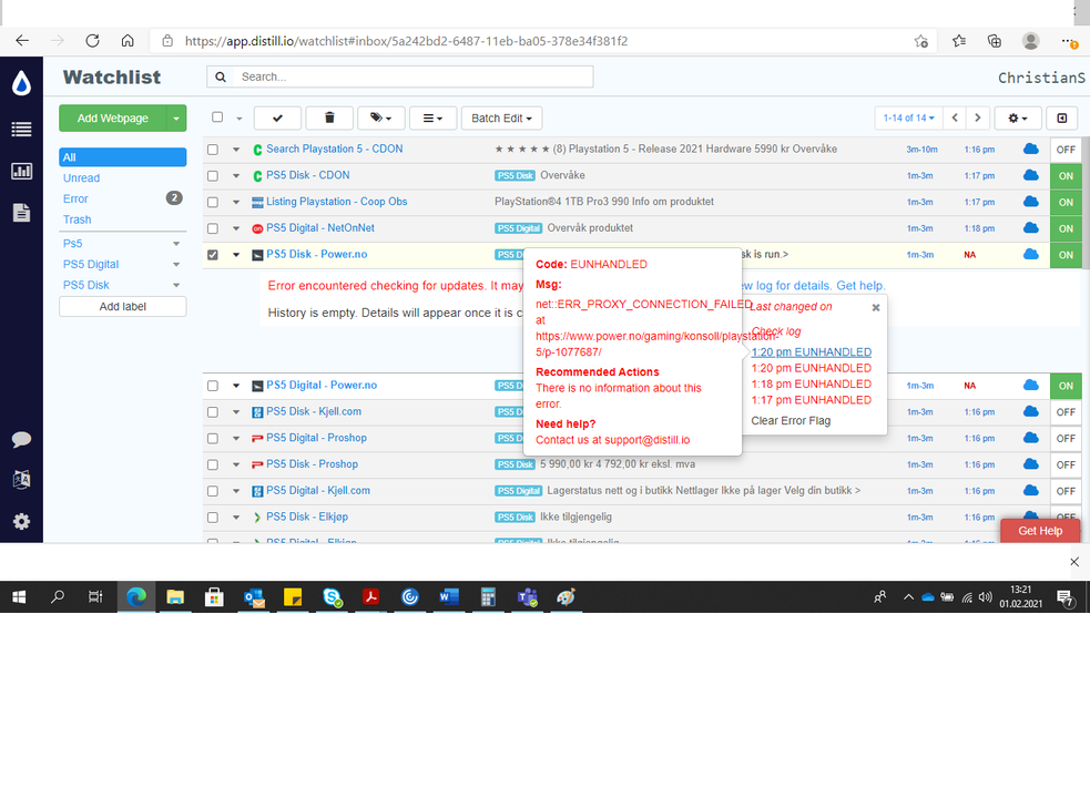

Monitoreringen setter seg til OFF av seg selv etter at den har utfører en check, hvordan endrer jeg det?
Det kommer også en feilmelding på Power.
You have set monitors to run in the cloud instead of your own computer. It seems they have a limit on the number of concurrent monitors. Change to your browser.
The error says "proxy connection". It seems Power blocked Distill's IPs. Again, change to your own browser.
Endret av birukoff
The error says "proxy connection". It seems Power blocked Distill's IPs. Again, from from your own browser.
Ok, thanks for the assistance. Changed from cloud to browser. Will that also fix the Power IP issue or do I need to do something else?
46 minutes ago, birukoff said:
I think it should. I do not have any issues with Power monitors running from my browser.
Its working now after I switched it to browser.
