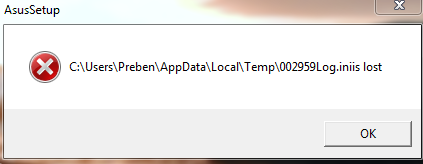

Møkkalasset Skrevet 9. september 2015 Skrevet 9. september 2015 Hallo Får feilmelding når eg starte opp pc se ved lagt bilde, lurer på korleis eg kan rette denne feilen.
Hårek Skrevet 9. september 2015 Skrevet 9. september 2015 Fant denne: "When booting I get error message under "asus setup" 105814 Log.iniis Lost? Hi, you probably ran Ccleaner or similar and deleted this log file from your temporary folder, that is in use by a scheduled task. Open Task scheduler and expand the" task scheduler library". Open Asus and select the " i-setup" task , delete it, and you are done." http://answers.microsoft.com/en-us/windows/forum/all/on-startup-a-box-pops-up-and-says-asus-setup-and/50ff4b5c-527d-43de-b499-7bffff4427d1?auth=1
