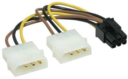

Denne (ene) her som menes?
(ved bruk at slikt adapteret anbefales forøvrig å benytte 4-pin peripheral fra hver sin kabel direkte fra strømforsyningen)
http://www.playtool.com/pages/psuconnector...html#pciexpress
"If you use an adapter then be sure to plug the 4 pin peripheral connectors into separate cables coming from the power supply. If you plug them both into the same power supply cable then you are drawing all the power of the PCI Express connector through a single 18 gauge wire. You can usually get away with that but there's no reason to do it."
