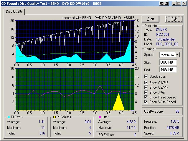

JKJK Skrevet 10. september 2005 Skrevet 10. september 2005 Kjøpte med nettopp 2stk Benq DW1640 brennere og noen plater. Platene er type Verbatim "DVD+R Photo printable" 16x Her er info jeg har klart å spore opp om platene: ** INFO : Hex Dump Of 'Media Code'-Block Listed Below ** INFO : 4-Byte Header Preceding 'Media Code'-Block Discarded ** INFO : Format 11h (Method 1) - ADIP Information 0000 : a1 0f 02 00 00 03 00 00 00 26 05 3f 00 00 00 00 .........&.?.... 0010 : 00 00 07 4d 43 43 00 00 00 00 00 30 30 34 00 38 ...MCC.....004.8 0020 : 23 54 37 12 02 54 6c 02 92 5f 15 15 0b 0b 08 08 #T7..Tl.._...... 0030 : 01 19 1b 0c 0c 0c 0d 01 00 00 00 00 00 00 00 00 ................ 0040 : 01 00 38 38 02 2c 5a 1a 05 2e 23 10 04 1e 1d 01 ..88.,Z...#..... 0050 : 00 00 02 2c 5a 1a 05 2e 23 10 04 1e 1d 01 00 00 ...,Z...#....... 0060 : 02 00 54 70 02 30 63 3c 24 14 0c 0c 01 20 00 00 ..Tp.0c<$.... .. 0070 : 00 00 02 40 66 42 24 14 0c 0c 01 20 00 00 00 2b ...@fB$.... ...+ 0080 : 03 00 54 df 02 30 63 3c 24 14 0c 0c 01 20 00 00 ..T..0c<$.... .. 0090 : 00 00 02 75 5e 58 24 14 0a 0a 01 20 00 00 00 59 ...u^X$.... ...Y 00a0 : 00 00 00 00 00 00 00 00 00 00 00 00 00 00 00 00 ................ 00b0 : 00 00 00 00 00 00 00 00 00 00 00 00 00 00 00 00 ................ 00c0 : 00 00 00 00 00 00 00 00 00 00 00 00 00 00 00 00 ................ 00d0 : 00 00 00 00 00 00 00 00 00 00 00 00 00 00 00 00 ................ 00e0 : 00 00 00 00 00 00 00 00 00 00 00 00 00 00 00 00 ................ 00f0 : 00 00 00 00 00 00 00 00 00 00 00 00 00 00 00 00 ................ 0100 : 00 00 .. General Information Drive: BENQ DVD DD DW1640 Firmware: BSGB Disc: DVD+R (MCC 004) Selected speed: Maximum PI errors Maximum: 11 Average: 1.41 Total: 316 PI failures Maximum: 4 Average: 0.04 Total: 5 PO failures: 0 Jitter Maximum: 11.7 % Average: 4.69 % Scanning statistics Elapsed time: 0:48 Number of samples: 403 Average scanning interval: 8.15 ECC Glitches removed: 0 Legger ved et bilde av "Disc Quality test'en" i nero Men er ikke så flink til å tyde infoen jeg får, så kan noen med litt peiling fortelle meg om disse platene er OK, eller om de er katta i sekken?
Psh Skrevet 10. september 2005 Skrevet 10. september 2005 (endret) Det første du må gjøre er å ta en ny scan, med Speed på 8x og ta vekk haken ved Quick Scan. Endret 10. september 2005 av Psh
OC-Freak Skrevet 10. september 2005 Skrevet 10. september 2005 (endret) Det første du må gjøre er å ta en ny scan, med Speed på 8x og ta vekk haken ved Quick Scan. Edit: Og det har kommet en ny firmware versjon nå: BSLB som du kan laste ned fra http://support.benq.com Endret 10. september 2005 av OC-Freak

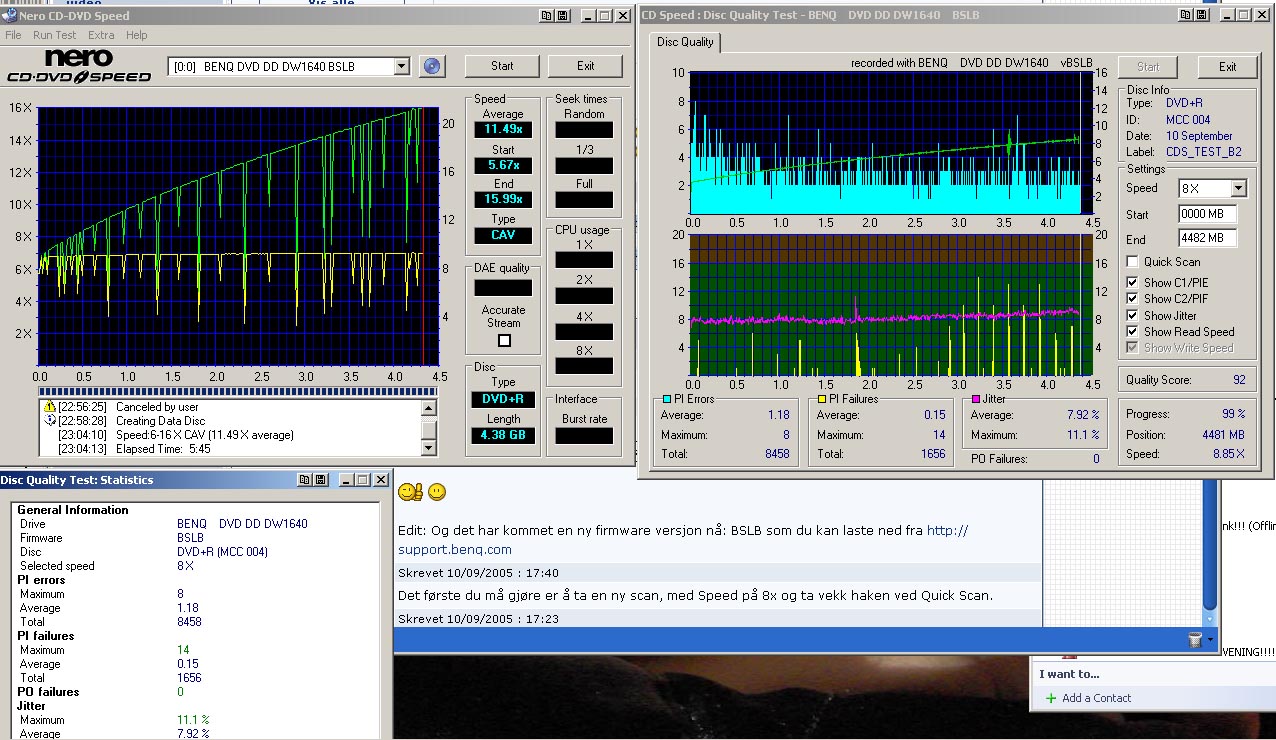

JKJK Skrevet 10. september 2005 Forfatter Skrevet 10. september 2005 Ny test! Følgende ble gjort: 1: Oppgraderte firmware. 2: Kjørte "Create data disc" 3: Kjørte quality test uten quick scan, med hastighet på 8x General Information Drive: BENQ DVD DD DW1640 Firmware: BSLB Disc: DVD+R (MCC 004) Selected speed: 8 X PI errors Maximum: 8 Average: 1.18 Total: 8458 PI failures Maximum: 14 Average: 0.15 Total: 1656 PO failures: 0 Jitter Maximum: 11.1 % Average: 7.92 % Scanning statistics Elapsed time: 9:40 Number of samples: 17850 Average scanning interval: 8.03 ECC Glitches removed: 0
OC-Freak Skrevet 10. september 2005 Skrevet 10. september 2005 Helt topp! Faktisk blant det bedre jeg har sett med disse platene på denne brenneren.
