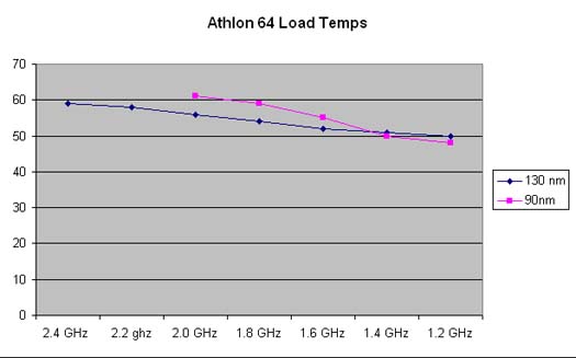

_Furien_ Skrevet 12. oktober 2004 Skrevet 12. oktober 2004 Det er en litt spesiell (?) trend vi ser ved load:
_Furien_ Skrevet 12. oktober 2004 Skrevet 12. oktober 2004 (endret) All of our temperature measurements were taken in a case-open environment. We used the stock AMD OEM cooler as it stands, though we’ve got reason to think AMD may be revising its cooler line and shipping a more powerful unit in the future (more on this later). Er fra den siste lenken snorreh la ut Edit: Unfortunately, if this trend does hold true, it doesn’t look positive for AMD either. Keep in mind, the 3200+ is only a 2 GHz part. At 2.4 or 2.6 GHz, it’ll be pushing the thermal envelope even harder, to say nothing of 2.8 or 3.0 GHz. This is undoubtedly why AMD hasn’t released their highest-end parts on 90nm yet; those are the parts most likely to require additional voltage to hit their target clockspeeds (and hence increase their thermals even more). A well-tuned 130nm process may be yielding more attractive CPUs at these speed grades than AMD’s new 90nm. Ser kanskje ut som om AMD kommer til å få samme problem som Intel (skal vel ta disse testene med en klype salt ) Endret 12. oktober 2004 av _Furien_
snorreh Skrevet 12. oktober 2004 Skrevet 12. oktober 2004 (endret) http://www.sudhian.com/showdocs.cfm?aid=610&pid=2297 One thing to keep in mind, however, is that its possible to have both lower power consumption and a higher thermal profile if the power density is such that temperature increases even as power consumption drops. Of course its always possible that our motherboard is incorrectly reporting temperatures, and we’re not discounting that possibility. As it stands, however, according to the MSI Neo2, the 2 GHz 3200+ runs hotter than the .13 micron 3800+ at 2.4 GHz. Se også dette: http://www.sudhian.com/showdocs.cfm?aid=609 As you can see, there’s virtually no difference between the two processors, despite the lower voltage from the 90nm Winchester. Our ASUS board is using a beta BIOS, however, and we’ve had some errata with voltage detection Endret 12. oktober 2004 av snorreh
