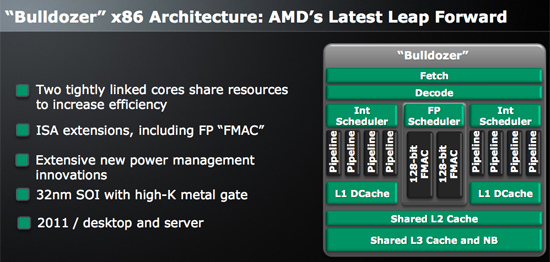

Siden AMDs bulldozer bare dobler INT over phenom, og gromacs er hovedsaklig FLOAT er det mulig Sandy-EX til overkjøre bulldozeren på SMP med tilsvarende antall kjerner.
Jeg mente at FP ble kraftig økt i Bulldozer, men husker ikke i hvilken sf tråd jeg leste det. De snakket om at den ville bli vesentlig mer gunstig for folding.
Ok, gief link om du finner det ut.
Det jeg husker fra previews av bulldozer arkitekturen var at 2 int kjerner deler en float kjerne og kalles en modul. Om float delen har blitt bedre har jeg ikke sett/hørt noe om.
Sakset i fra Wikipedia. (link)
Based on the information provided by AMD during its annual Analyst Day last November, the Bulldozer chip code-named Zambezi (which belongs to Orochi family, according to the firm) will feature eight x86 processing engines (cores) organized in pairs (called a "module", which is invisible to the OS). The cores of a module share a floating point unit with two 128-bit FMAC units and two 128-bit integer SIMD units, and a L2 cache. Multiple modules share a L3 cache as well as an Advanced Dual-Channel Memory Sub-System (IMC - Integrated Memory Controller). Bulldozer is designed for higher memory level parallelism. AMD also states that the new CPU will feature "Extensive New Power Management Innovations". The new chips that belong to Bulldozer's family will also support "Advanced Vector Extensions" (AVX) that supports 256-bit FP operations.[1]
