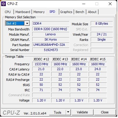

Svein M Skrevet 15. august 2022 Rapporter Del Skrevet 15. august 2022 (endret) Tror du bør ha den spesielle 3200MHz 1.2V minne. Om du da kjøper 2x8GB så kan du bruke den sammen med den du har for å få 4x 8GB. Jeg fant dette svaret på reddit, sitat: The T5 uses 3200MHz JEDEC-profile memory. JEDEC is the standardized speed for all RAM modules, and the 3200MHz/cl22/1.2v is newest and fastest variant of JEDEC-standard (released around 2019). Anything faster than that is overclocking which is not supported by pre-built systems. There are only two models of 3200MHz JEDEC RAM sticks in the market, the Kingston Valueram and Crucial "reference" (no heatsink) sticks. Search Amazon for "3200MHz cl22" and you should find at least the Crucial sticks. You can check which XMP/JEDEC profile the PC is currently using with CPU-Z software. It will also tell you which profiles are installed inside the RAM sticks. Endret 15. august 2022 av Svein M Siter Lenke til kommentar
