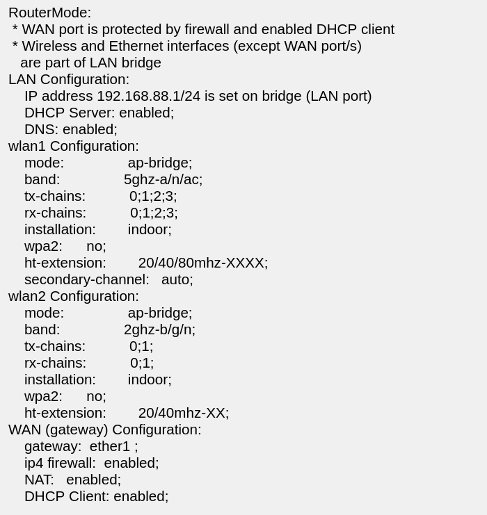

Steps described here are assuming you are starting with mikrotiks default config.
Default config summary is attached so you can see what the starting config is.
