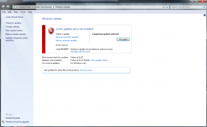

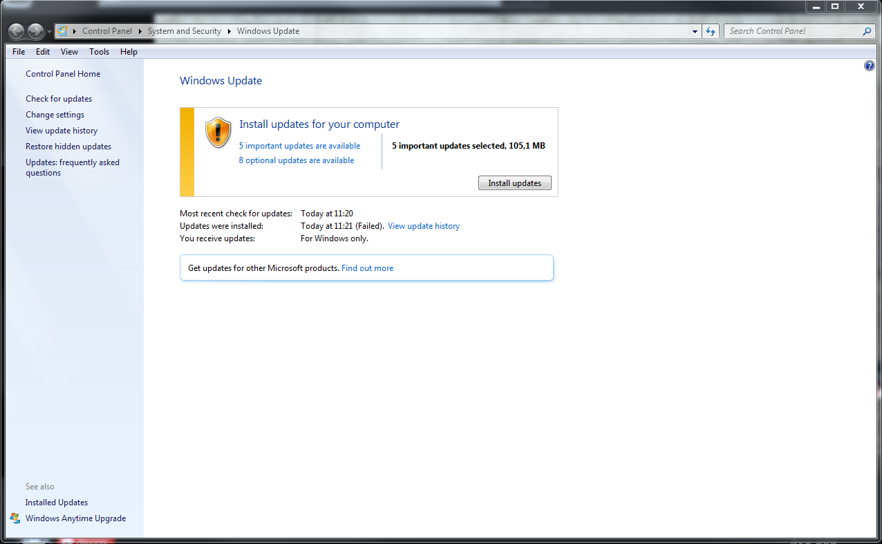

Hei!
Får ikke til å laste ned windows update.(KB3060716, KB3071756, KB3126587, KB3068708, KB3080149)
Når jeg prøver å laste ned updaten så blir det ikke installert. (error code 800B0100)

Løsningen ligger sannsynligvis i å legge inn tilbudte optional updates først.
This problem seems to have resolved itself and may be marked as solved ...
After installing all optional updates (except driver updates), these important KB's installed.
Who would have thought important updates could be dependent on optional updates, recommended or not, but there you go!
