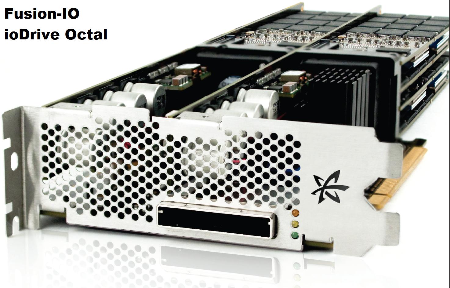

http://www.fusionio.com/press/Fusion-io-Ac...ined-Bandwidth/
Fusion-io Achieves One Terabyte per Second Sustained Bandwidth
Portland, Oregon November 17, 2009 – Today at SC09, Fusion-io announced that it will deploy custom installations based on its ioMemory technology at two presently undisclosed government organizations. Each deployment consists of hundreds of terabytes of solid-state storage capacity and is capable of sustaining over one terabyte per second (1TB/s) of aggregate bandwidth with access latencies under 50 microseconds.
Achieving a 1TB/s sustained bandwidth with existing state-of-the-art storage technologies requires close to 55,440 disk drives, 396 SAN controllers, 792 I/O servers and 132 racks of equipment. Fusion-io can achieve this same bandwidth with a mere 220 ioDrive Octal cards, housed in Infiniband-attached I/O servers running the Lustre parallel file system. This 1TB/s Fusion-io based solution requires only six racks
The ioDrive Octal is a custom PCI Express card designed by Fusion-io. The device holds eight ioMemory Modules - putting the equivalent capacity and performance of eight ioDrives into a single card. The ioDrive Octal fits any PCI Express x16 Gen2 double-wide slot, the same as those used for high performance graphics cards, and it is capable of saturating the full performance of that slot.
“We were eager to take on the challenge of creating a device that meets the intense demands of high performance computing. With this architecture, IOPS are easy.
We achieved over a hundred million (100,000,000) IOPS, more than enough performance to meet our customer’s requirements. The real power in our architecture was the ability to also scale bandwidth,” said Steve Wozniak, Chief Scientist at Fusion-io.
ioDrive Octal Details
The following specifications describe a single ioDrive Octal:
• 800,000 IOPS (4k packet size)
• 6 GB/s bandwidth
• 5 TB maximum capacity
• x16 gen-2 double-wide PCI Express form factor
Oppsummering: 220 ioDrive Octal som tar opp 6 racks yter over 1 TB/s og 100 millioner IOPS. Hentes fra hundrevis av TB med ioDrive lagring hostet av Infiniband I/O-servere som kjører Lustre parallel file system.
Jeg er en smule skeptisk til hva folk skal med slike ting, spesielt når de ikke vil si hvem som kjøper disse oppsettene en gang. Men det er jo god butikke for Fusion-IO da. :)
Bilde:
Endret av GullLars
