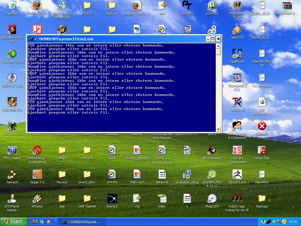

Kimelimm Skrevet 26. november 2007 Forfatter Skrevet 26. november 2007 Ok dette er problemet, jeg får en error på oppstart av Combofix. Men sjekk dette, jeg scanna med SAS og fjerna 3-6 trojaner greier, men det er ikke fiksa Her er HJT: Klikk for å se/fjerne innholdet nedenfor Logfile of Trend Micro HijackThis v2.0.2Scan saved at 14:23:46, on 26.11.2007 Platform: Windows XP SP2 (WinNT 5.01.2600) MSIE: Internet Explorer v6.00 SP2 (6.00.2900.2180) Boot mode: Normal Running processes: C:\WINDOWS\System32\smss.exe C:\WINDOWS\system32\winlogon.exe C:\WINDOWS\system32\services.exe C:\WINDOWS\system32\lsass.exe C:\WINDOWS\system32\svchost.exe C:\WINDOWS\System32\svchost.exe C:\WINDOWS\Explorer.exe C:\WINDOWS\system32\spoolsv.exe C:\WINDOWS\services.exe C:\Programfiler\Bonjour\mDNSResponder.exe C:\Programfiler\Eset\nod32krn.exe C:\WINDOWS\system32\nvsvc32.exe C:\WINDOWS\RTHDCPL.EXE C:\Programfiler\Java\jre1.6.0_03\bin\jusched.exe C:\WINDOWS\system32\RUNDLL32.EXE C:\Programfiler\Adobe\Reader 8.0\Reader\Reader_sl.exe C:\WINDOWS\system32\ctfmon.exe C:\Programfiler\DAEMON Tools\daemon.exe C:\Programfiler\Fellesfiler\Ahead\Lib\NMBgMonitor.exe C:\Programfiler\Messenger\msmsgs.exe C:\Programfiler\Purrint\Purrint.exe C:\Programfiler\Fellesfiler\Ahead\Lib\NMIndexStoreSvr.exe C:\WINDOWS\system32\wuauclt.exe C:\Programfiler\MSN Messenger\msnmsgr.exe C:\Programfiler\Mozilla Firefox\firefox.exe C:\Programfiler\MessengerDiscovery\MessengerDiscovery Live.exe C:\Programfiler\MSN Messenger\usnsvc.exe C:\Programfiler\Winamp\winamp.exe C:\Documents and Settings\Kim\Skrivebord\HiJackThis.exe R0 - HKCU\Software\Microsoft\Internet Explorer\Main,Start Page = http://www.sol.no R1 - HKCU\Software\Microsoft\Windows\CurrentVersion\Internet Settings,ProxyOverride = *.local R0 - HKCU\Software\Microsoft\Internet Explorer\Toolbar,LinksFolderName = Koblinger F2 - REG:system.ini: Shell=Explorer.exe C:\WINDOWS\system32\fservice.exe O2 - BHO: Koblingshjelpeprogram for Adobe PDF Reader - {06849E9F-C8D7-4D59-B87D-784B7D6BE0B3} - C:\Programfiler\Fellesfiler\Adobe\Acrobat\ActiveX\AcroIEHelper.dll O2 - BHO: SSVHelper Class - {761497BB-D6F0-462C-B6EB-D4DAF1D92D43} - C:\Programfiler\Java\jre1.6.0_03\bin\ssv.dll O2 - BHO: (no name) - {7E853D72-626A-48EC-A868-BA8D5E23E045} - (no file) O3 - Toolbar: TextAloud - {F053C368-5458-45B2-9B4D-D8914BDDDBFF} - C:\Programfiler\TextAloud\TAForIE.dll O4 - HKLM\..\Run: [NvCplDaemon] RUNDLL32.EXE C:\WINDOWS\system32\NvCpl.dll,NvStartup O4 - HKLM\..\Run: [sW20] C:\WINDOWS\system32\sw20.exe O4 - HKLM\..\Run: [sW24] C:\WINDOWS\system32\sw24.exe O4 - HKLM\..\Run: [High Definition Audio Property Page Shortcut] HDAudPropShortcut.exe O4 - HKLM\..\Run: [snarvei til egenskapsside for High Definition Audio] HDAShCut.exe O4 - HKLM\..\Run: [RTHDCPL] RTHDCPL.EXE O4 - HKLM\..\Run: [sunJavaUpdateSched] "C:\Programfiler\Java\jre1.6.0_03\bin\jusched.exe" O4 - HKLM\..\Run: [NvMediaCenter] RUNDLL32.EXE C:\WINDOWS\system32\NvMcTray.dll,NvTaskbarInit O4 - HKLM\..\Run: [Adobe Reader Speed Launcher] "C:\Programfiler\Adobe\Reader 8.0\Reader\Reader_sl.exe" O4 - HKLM\..\Run: [unlockerAssistant] "C:\Programfiler\Unlocker\UnlockerAssistant.exe" O4 - HKLM\..\Run: [PWRISOVM.EXE] C:\Programfiler\PowerISO\PWRISOVM.EXE O4 - HKLM\..\Run: [combofix] "C:\WINDOWS\system32\cmd.exe" /c "cd /d C:\ComboFix\ & Combobatch.bat" O4 - HKCU\..\Run: [CTFMON.EXE] C:\WINDOWS\system32\ctfmon.exe O4 - HKCU\..\Run: [DAEMON Tools] "C:\Programfiler\DAEMON Tools\daemon.exe" -lang 1033 O4 - HKCU\..\Run: [bgMonitor_{79662E04-7C6C-4d9f-84C7-88D8A56B10AA}] "C:\Programfiler\Fellesfiler\Ahead\Lib\NMBgMonitor.exe" O4 - HKCU\..\Run: [MSMSGS] "C:\Programfiler\Messenger\msmsgs.exe" /background O4 - HKLM\..\Policies\Explorer\Run: [DirectX For Microsoft® Windows] C:\WINDOWS\system32\fservice.exe O4 - HKUS\S-1-5-19\..\Run: [CTFMON.EXE] C:\WINDOWS\system32\CTFMON.EXE (User 'LOKAL TJENESTE') O4 - HKUS\S-1-5-20\..\Run: [CTFMON.EXE] C:\WINDOWS\system32\CTFMON.EXE (User 'NETTVERKSTJENESTE') O4 - HKUS\S-1-5-18\..\Run: [CTFMON.EXE] C:\WINDOWS\system32\CTFMON.EXE (User 'SYSTEM') O4 - HKUS\.DEFAULT\..\Run: [CTFMON.EXE] C:\WINDOWS\system32\CTFMON.EXE (User 'Default user') O4 - Startup: Purrint.lnk = C:\Programfiler\Purrint\Purrint.exe O4 - Global Startup: sd.exe O9 - Extra button: (no name) - {08B0E5C0-4FCB-11CF-AAA5-00401C608501} - C:\Programfiler\Java\jre1.6.0_03\bin\ssv.dll O9 - Extra 'Tools' menuitem: Sun Java Console - {08B0E5C0-4FCB-11CF-AAA5-00401C608501} - C:\Programfiler\Java\jre1.6.0_03\bin\ssv.dll O9 - Extra button: Messenger - {FB5F1910-F110-11d2-BB9E-00C04F795683} - C:\Programfiler\Messenger\msmsgs.exe O9 - Extra 'Tools' menuitem: Windows Messenger - {FB5F1910-F110-11d2-BB9E-00C04F795683} - C:\Programfiler\Messenger\msmsgs.exe O18 - Protocol: skype4com - {FFC8B962-9B40-4DFF-9458-1830C7DD7F5D} - C:\PROGRA~1\FELLES~1\Skype\SKYPE4~1.DLL O20 - Winlogon Notify: !SASWinLogon - C:\Programfiler\SUPERAntiSpyware\SASWINLO.dll O23 - Service: ##Id_String1.6844F930_1628_4223_B5CC_5BB94B879762## (Bonjour Service) - Apple Computer, Inc. - C:\Programfiler\Bonjour\mDNSResponder.exe O23 - Service: FLEXnet Licensing Service - Macrovision Europe Ltd. - C:\Programfiler\Fellesfiler\Macrovision Shared\FLEXnet Publisher\FNPLicensingService.exe O23 - Service: InstallDriver Table Manager (IDriverT) - Macrovision Corporation - C:\Programfiler\Fellesfiler\InstallShield\Driver\1050\Intel 32\IDriverT.exe O23 - Service: NBService - Nero AG - C:\Programfiler\Nero\Nero 7\Nero BackItUp\NBService.exe O23 - Service: NOD32 Kernel Service (NOD32krn) - Eset - C:\Programfiler\Eset\nod32krn.exe O23 - Service: NVIDIA Display Driver Service (NVSvc) - NVIDIA Corporation - C:\WINDOWS\system32\nvsvc32.exe -- End of file - 5524 bytes
norbat Skrevet 26. november 2007 Skrevet 26. november 2007 (endret) Kjør HJT og fix følgende linje: F2 - REG:system.ini: Shell=Explorer.exe C:\WINDOWS\system32\fservice.exe O4 - HKLM\..\Policies\Explorer\Run: [DirectX For Microsoft® Windows] C:\WINDOWS\system32\fservice.exe Last ned SDFix til skrivebordet. Dobbeltklikk på SDFix.exe og det vil pakke seg ut til ei mappe i C:\SDFix Restart PC-en i sikker modus (tapp F8 under oppstart, velg sikker modus) Åpne SDFix-mappa og dobbeltklikk på 'RunThis.bat' for å starte programmet Velg Y for å starte rensingen PC-en vil restarte, og SDFix vil fortsette. Post ny HJT-logg + loggen fra SDFix (vil ligge som Report.txt i SDFix-mappa) I loggen så har du en O4 - Global Startup: sd.exe. Vet du hva dette er? Du kunne ha sjekket fila sd.exe på følgende nettside: http://virusscan.jotti.org/. Hvor denne sd.exe ligger vet jeg ikke. Du kan søke evt. sjekk i system eller system32 Endret 26. november 2007 av norbat

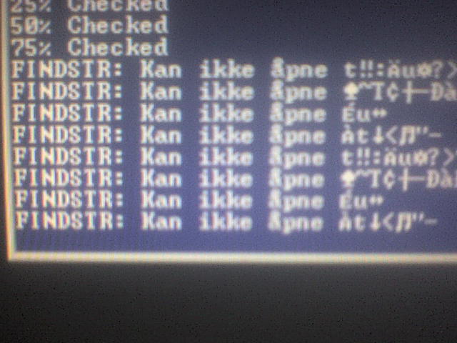

Kimelimm Skrevet 26. november 2007 Forfatter Skrevet 26. november 2007 (endret) Nei nå er jeg forbanna, Windows er sikkert ødelagt, fikk error der og, på 75% check eller noe, kan vise deg bildet jeg tok fra mobilen. Jeg har ingen Reparerings cd heller... Hva skal jeg gjøre?! Her er loggen vertfall. Klikk for å se/fjerne innholdet nedenfor SDFix: Version 1.115 Run by Administrator on 2007-11-26 at 16:00 Microsoft Windows XP [Versjon 5.1.2600] Running From: C:\SDFix Safe Mode: Checking Services: Restoring Windows Registry Values Restoring Windows Default Hosts File Rebooting... Normal Mode: Checking Files: No Trojan Files Found Removing Temp Files... ADS Check: C:\WINDOWS No streams found. C:\WINDOWS\system32 No streams found. C:\WINDOWS\system32\svchost.exe No streams found. C:\WINDOWS\system32\ntoskrnl.exe No streams found. Endret 26. november 2007 av Kimelimm
norbat Skrevet 26. november 2007 Skrevet 26. november 2007 (endret) Fix nevnte linjer med HJT Hent Avenger og pakk det ut. Start programmet, sett prikk i "Input Script Manually" og klikk på lupen. I vinduet som kommer opp kopierer du og limer inn det som er i fet skrift under: Files to delete: C:\WINDOWS\system32\fservice.exe Klikk på Trafikklyset. Restart PC-en. Etter restart vil det komme en loggfil som forteller hva som har skjedd. Du trenger ikke å poste den, men si om fila ble slette. Prøv deretter å kjøre combofix igjen. Om dette ikke går, prøv å kjøre den fra sikker modus (tapp F8 under oppstart, velg sikker modus) Endret 26. november 2007 av norbat
