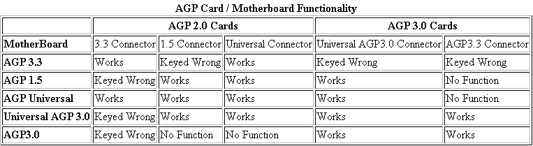

Tok en titt på kortet og det stemmer bra med bildet og som du sier AGP Universal.
Siden det da står AGP som grensesnitt og ikke AGP pro på det kortet du foreslo, så burde det funke?
Jeg Googla det og fant dette:
The AGP 1.0 specification defined 1x and 2x speeds with the 3.3v keyed connector.
The AGP 2.0 specification defined 1x, 2x and 4x speeds with the 3.3v, or 1.5v keyed connector or a 'Universal' connector which supported both card types.
The AGP Pro specification defined 1x, 2x and 4x speeds with the 3.3v, or 1.5v keyed connector or a 'Universal' connector which supported both card types.
The AGP 3.0 specification defined 1x, 2x, 4x and 8x speeds with the 1.5v keyed connector or a 1.5v AGP Universal / Pro connector.
Each up-grade is a supper-set of the 1x mode, so 4x will also support the 1x speed. The base clock rate is 66MHz, but to achieve to 2x, 4x, and 8x speeds the clock is doubled each time. AGP uses both edges of the clock to transfer data.
AGP (1x): 66MHz clock, 8 bytes/clock, Bandwidth: 266MB/s [3.3V or 1.5V signal swing]
AGP 2x: 133MHz clock, 8 bytes/clock, Bandwidth: 533MB/s [3.3V or 1.5V signal swing]
AGP 4x: 266MHz clock, 16 bytes/clock, Bandwidth: 1066MB/s [1.5V signal swing]
AGP 8x: 533MHz clock, 32 bytes/clock, Bandwidth: 2.1GB/s [0.8V signal swing], still uses 1.5 volt motherboard power
Så ja, om jeg leste riktig kan du bruke det kortet jeg linka til over, og andre AGP 4X-kort :w00t:
