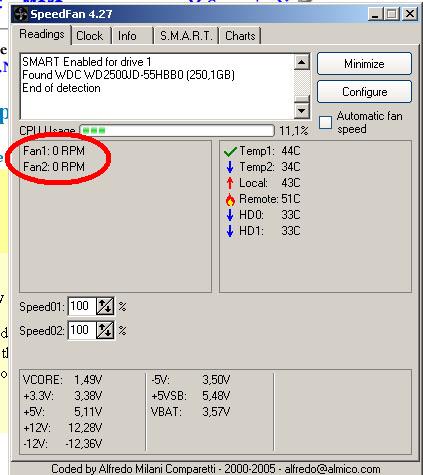

Begge går som de skal. Det er to vifter (pluss en integrert på grafikkortet). I Speedfan er de satt til 100%, og de går ikke fortere. Man kan derimot sette dem slik at de går treigere, men det er jo ingen vits .
Her er svaret på hva remote er
First of all, you have to identify which temperature sensor is which. SpeedFan strictly adheres to available datasheets for each sensor chip. Please remember that hardware monitors are chips that do have some pins (small connectors) which should be connected to some additional hardware (temperature probes, thermistors or thermocouples) in order to be able to read temperatures. Only a few hardware monitor chips do label their connectors with "CPU", "System" and the likes. Most of them use labels like "Temp1", "Local" or "Remote". The hardware manufacturers connect available pins to different temperature sensors basically according to the physical placement of components on the motherboard. This means that the same chip, an ITE IT8712F, for example, might be connected to a sensor diode measuring CPU temperature on Temp2 and, on a different hardware, it might be connected on Temp1. If you have a "Local" sensor and a "Remote" labeled one, this usually means that "Local" is the temperature of the monitor chip itself and "Remote" is the temperature read from a "remote" probe.
When you have properly identified which temperature sensor is which, try to lower the speed of each fan and look at reported speed and temperatures. If you do not allow SpeedFan to change any fan speed and set all the speeds too low, then SpeedFan won't be able to avoid overheating.

Hmmm... Er det meningen at det skal være fult av kliss oppå prosessoren? Atholon 3000+. Eller er den rett og slett smeltet eller noe? :S Beklager hvis det var et dumt spørsmål.
kansje den er som min at den stiller prosessorvifta etter temperaturen på cpuen. vis den gjør det kan du stille det i biosen.
5332964[/snapback]
Er mulig. Hvor i BIOS ligger det?
5332964[/snapback]
5333019[/snapback]
på min ligger det under h/w monitor, cpu smartfantemperature

Hmmm, merkelig, fikk ikke det øverste bilde da jeg skrev innlegget? :hmm:
My bad :blush:
