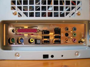

And here is the picture from back side of the pc, where you can see that motherboard had to be moved more to the left. But picture above shows that FHS is already bended. To get to right position would require to move fan another 5 mm to left. Bending FHS applies pressure on CPU I think...

Nope, thats definately not a perfect fit.
As I see it you have two choices. 1: Return the Zalman and get a smaller cooler, or 2: Cut off some leaves from the cooler until none actually touches your cab wall.
EDIT: Oops, missed your last post.
BTW, i doubt cutting off some of the cooler would be a problem. The Zalman will still offer great cooling and low noise levels, even if you remove some material. Just be sure that the fan won`t touch the cab wall before starting.
