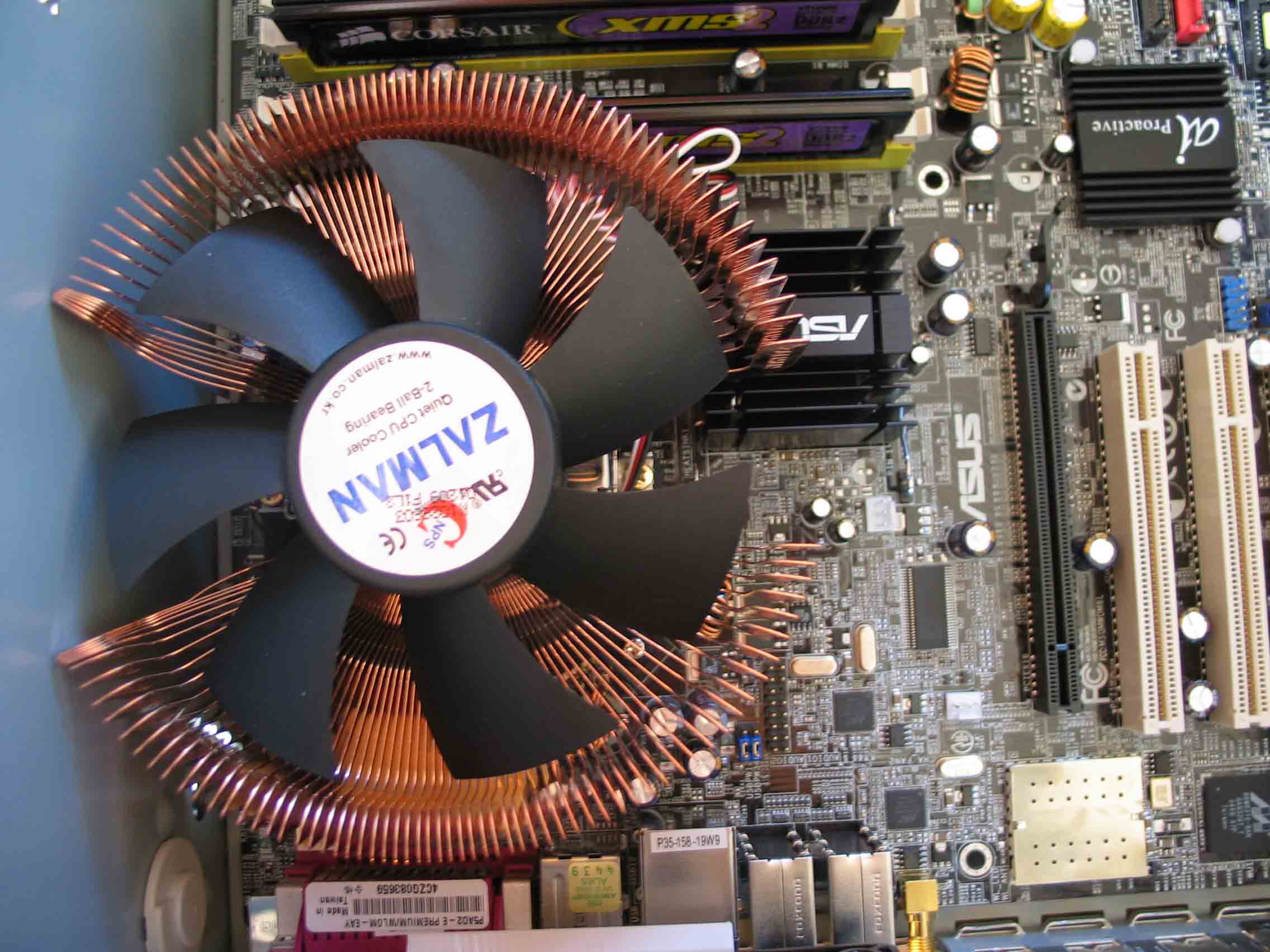

Finally bought all the parts of my PC. Have one question though... I put Zalman CNPS7700 cooler on CPU on ASUS P5AD2-E Premium , then I try to insert it into Silverstone TJ06 case, but it does not fit... Zalman touches the side of the case and bends a lot. I would need to use really power to bend it even more if I want to srew motherboard in place. What should I do?
I could also send a picture if I didn't explain clearly enough on what I meant above. Just PM an email address where to. Help is appreciated as the project is on hold right now, all parts are on my bed and my wife will kill me if we need to sleep in another room :(
there would be no problem uploading a picture to the forum, you do that :thumbup:
(when you posting a new post, scroll down and you will find "vedlagt fil" click "browse" and browse your wau to your picture)
