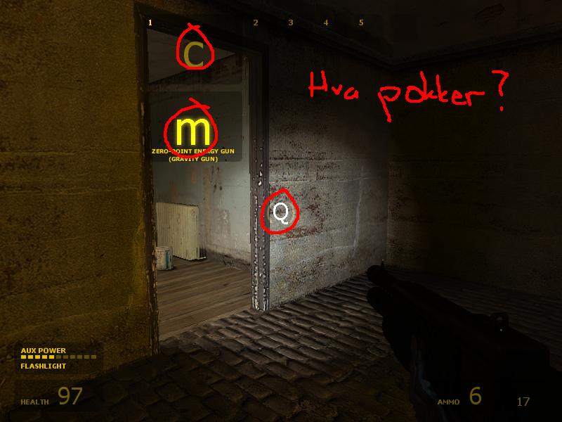

Jeg lastet ned demoen til Half-life 2 for en stund siden, og når jeg startet det opp ble siktet på alle våpnene til en "Q". Våpenmenyen besto også av bokstaver. Jeg bare lurer på om det skal være sånn i demoversjonen? :dontgetit:
edit : legger ved et screenshot

Hm. Nå har jeg prøvd Counter-strike Scouce også (brukte en kompis sin konto for å sjekke om det virket), og det viste seg at også i CS:S fikk jeg samme problemet + at lyden hang seg og at spillet klikket etter 5 min. :cry:
THE Q PROBLEM
A few people report seeing a large letter Q in place of the crosshair. If you see the Q without the health and ammo indicator brackets around it, then you probably have an alternate Half-life font file on your system which is overriding both of the above font files. You probably are not seeing your weapon drawings while switching, also.
Look in the Windows\fonts folder or go to Control Panel - Fonts, to see if you have an HL font file in there. It can interfere even if the file name is not the same. Delete it, or move it to another folder if you need to keep it, and see if that solves the problem. Even an alternate CS font file may cause trouble. Don't remember ever downloading a Half Life or CS font file? It could have come with one of the updates to The All Seeing Eye. After deleting or moving the other font file, you'll probably need to restart your computer before the change will take effect.
If you see the Q but still have the indicator brackets around it, your halflife2.ttf file may be corrupted. To test for a corrupted file, browse to the resource folder as indicated in the path above and delete the halflife.ttf file. Start the game and a new one will be generated.
If you still see the Q after trying both solutions above, try reinstalling the game. Or keep searching your hard drive for another HL font file (do a file search for *.ttf), and get rid of it.
