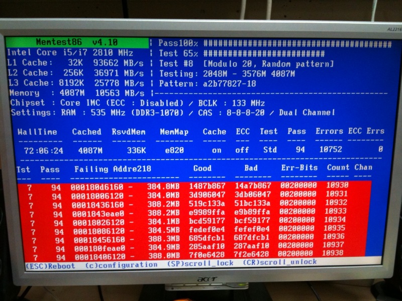

nree Skrevet 7. juli 2010 Skrevet 7. juli 2010 (endret) Maskinen får BSOD på uregelmessige tider, minst en gang om dagen. ASUS P7H55 i7 LGA1156 4 gb minne Radeon HD 5770 ADDITIONAL_DEBUG_TEXT: Use '!findthebuild' command to search for the target build information. If the build information is available, run '!findthebuild -s ; .reload' to set symbol path and load symbols. MODULE_NAME: nt FAULTING_MODULE: fffff80002849000 nt DEBUG_FLR_IMAGE_TIMESTAMP: 4b88cfeb BUGCHECK_STR: 0x4E_99 CUSTOMER_CRASH_COUNT: 1 DEFAULT_BUCKET_ID: VISTA_DRIVER_FAULT CURRENT_IRQL: 0 LAST_CONTROL_TRANSFER: from fffff800029492bc to fffff800028b9600 STACK_TEXT: fffff880`09090778 fffff800`029492bc : 00000000`0000004e 00000000`00000099 00000000`000485aa 00000000`00000002 : nt+0x70600 fffff880`09090780 00000000`0000004e : 00000000`00000099 00000000`000485aa 00000000`00000002 00000000`000483e4 : nt+0x1002bc fffff880`09090788 00000000`00000099 : 00000000`000485aa 00000000`00000002 00000000`000483e4 00000000`00000000 : 0x4e fffff880`09090790 00000000`000485aa : 00000000`00000002 00000000`000483e4 00000000`00000000 00000000`00000000 : 0x99 fffff880`09090798 00000000`00000002 : 00000000`000483e4 00000000`00000000 00000000`00000000 fffff800`0292b5e9 : 0x485aa fffff880`090907a0 00000000`000483e4 : 00000000`00000000 00000000`00000000 fffff800`0292b5e9 00000000`00000000 : 0x2 fffff880`090907a8 00000000`00000000 : 00000000`00000000 fffff800`0292b5e9 00000000`00000000 fffff680`00094d18 : 0x483e4 STACK_COMMAND: kb FOLLOWUP_IP: nt+70600 fffff800`028b9600 48894c2408 mov qword ptr [rsp+8],rcx SYMBOL_STACK_INDEX: 0 SYMBOL_NAME: nt+70600 FOLLOWUP_NAME: MachineOwner IMAGE_NAME: ntoskrnl.exe BUCKET_ID: WRONG_SYMBOLS Followup: MachineOwner --------- 070710-13338-01.zip Endret 7. juli 2010 av Goggen90

nree Skrevet 12. juli 2010 Forfatter Skrevet 12. juli 2010 Kom en del i memtest. Hva betyr dette, og hva skal jeg gjøre videre?
Mechablast Skrevet 12. juli 2010 Skrevet 12. juli 2010 Det betyr at du har feil på minnebrikkene, ta ut alle brikkene og test en og en, eller ta ut en og en og test, minnetesten kan gjerne kjøre i en 8 timer, men om du får feil innen noen minutter så er det bare å avbryte testen, ta ut en brikke og prøve igjen.
nree Skrevet 26. juli 2010 Forfatter Skrevet 26. juli 2010 Tok ut den ene brikken, kjørte testen. Ingen feil. Må jeg da teste den jeg ikke har testet for seg selv, eller kan jeg konkludere med at det er den det er feil på? Blir dette sett på som DOA?
Mechablast Skrevet 26. juli 2010 Skrevet 26. juli 2010 (endret) Det er vel like greit å teste alle brikkene, men en annen bra måte når du har testet og ikke funnet feil på test, er å bruke maskina en stund og se om den er stabil. Det med DOA er vel om varen er defekt ved mottak tror jeg. Når jeg tenker litt så er det vel en klar indikator at feilen er i den brikken du har tatt ut, om testen fullfører uten feil på resterende brikker. Endret 26. juli 2010 av arjato
Chavalito Skrevet 26. juli 2010 Skrevet 26. juli 2010 Du bør teste begge RAM brikkene hver for seg. Det at du ikke fikk feil på den ene brikken, betyr ikke at det er feil på den andre RAM brikken. Feil hastighet eller feil spenning på minnet kan gi feil i Memtest når du har begge minne brikkene satt inn. Har selv opplevd nettopp dette, at feil spenning kan gi over 10 000 feil i Memtest86+. Selvsagt kan den andre minne brikken være DOA, men kjør en Memtest på den før du gjør noe mer.
